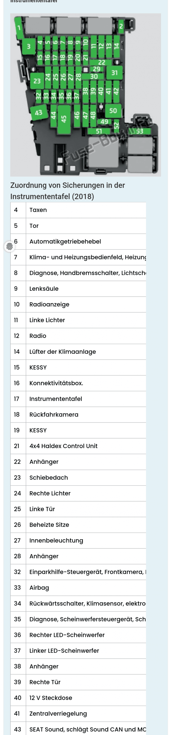

I’ll try to keep this short. I have a 2018 Leon fr
My washer fluid ran out so I topped it up but nothing would spray either the front or back windscreen. My bf suggested it might be a blown fuse so we went to Halfords and bought some more but that didn’t work so I assume I might need a new pump as I can’t hear any noise when trying to wash my windows.
But now I have further problems, and I don’t know if my bf has put fuses back in the wrong slots when he was trying to fix the washers.
First thing I noticed was that when I turn my headlights on the switch itself doesn’t illuminate to say that they are on, although the red backlights behind the dash buttons come on.
Second problem is now that my back windscreen wiper does not work at all but my front one still wipes. I’ve made sure my boot is properly closed and that it’s not stuck to my window by any dirt.
I’ve looked online at the fuse box layout but honestly I’m so confused as to which fuses might relate to the issues I have. Please help a girl out!?
Number 47 is the rear wiper, 15 amp fuse
