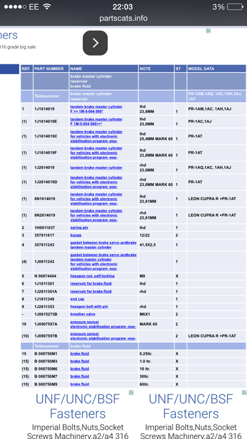

Interesting little read, but it's just a load of part numbers banded about, no-one seems to of actually tried it lol
(1) 1J1614019C tandem brake master cylinder
for vehicles with electronic stabilisation program -esp-
lhd
25,4MM MARK 60
1 PR-1AT
I'd be interested to know why ? What's the difference in the systems I wonder, the larger one is listed for Leon's and mk4 golfs, can't seem to find a specific model it's tied to though
Dual circuit brakes, and each circuit has a pressure sensor.

Just finished reading about it, newer mark 60 abs unit , two brake pressure sensors,g201 and g214
