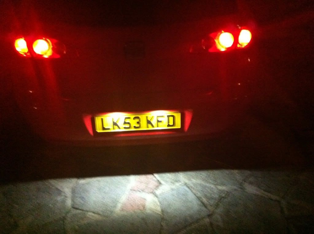

think my new number plate lights are a bit bright lol

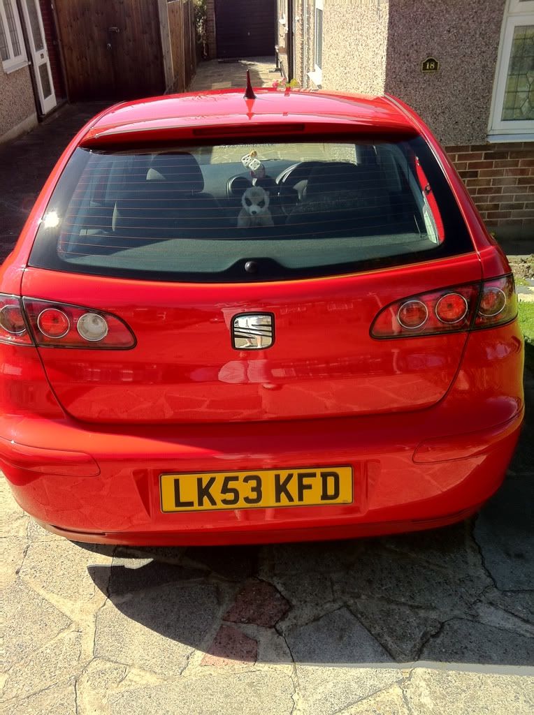

rear end's looking a bit weak with the major wheel tuck going on :( might get some spacers to get them to sit flush with the arch, am I gonna need to get longer bolts as well? if so that means the locking bolts are useless....
thanks for any help
thanks for any help
What size you thnking of? I've got 20mm hubcentrics, wouldnt want to fit longer bolts on that, but if your talking 5mm, you can most likely use your original bolts, so your locking bolts will still be usable :)
Search 5x100 hubcentric spacers on eBay, they're on for about 50 quid. They have their own bolts so they bolt into the hub, and then then the wheel bolts into them using your original bolts locking bolts. It's what I have, brilliant spacers.
arun, not all spacers bolt to hub, depends on size/company
and the bolts to put onto the adapters need to the right size too, or will bottom out on hub and you can cross-thread the spacers then you are fooked :p
work it all out right, or be prepared to lose a wheel/wod of cash :p

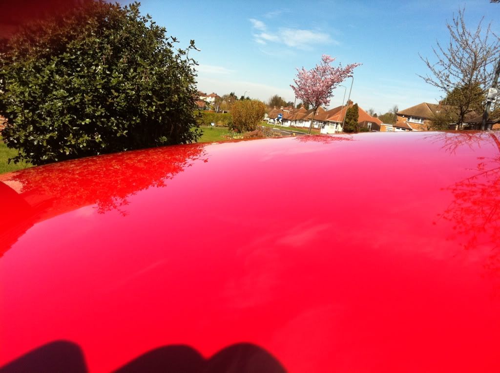

thanks guys :D , this time round was turtlewax refine n shine, about £17 from halfords. clayed before with bilt-hamber autoclay about 4 months ago so it didn't take the whole day this time lol. quick wash clayed then another quick wash to get that. Really needs a mop though it's covered in swirls :(
iphone is pretty damn good for photos, it keeps impressing me :) the 2nd photo was the HDR function, didnt hold it straight so that's why it's a bit blurry
