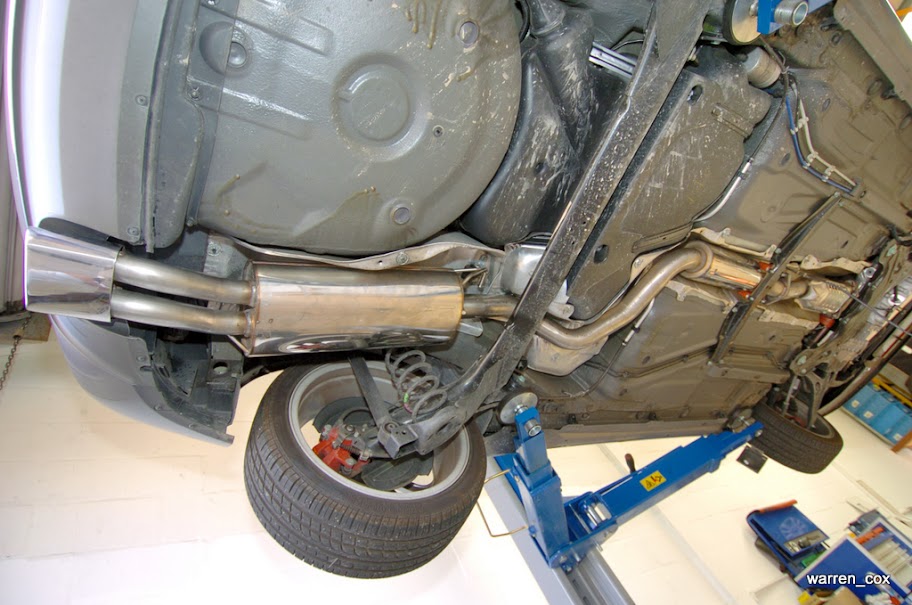

In 2005 I changed the OEM exhaust for a Milltek cat back and 100 cell race cat:
If you look at the various components of the exhaust, they all look a bit better made:
However, I made the killer mistake and didn't add the DP when all this was changed :doh:
To be absolutely frank, it was boomier on motorways, and in this configuration added very little other than sound over the OEM pipework.
Personally, I'd start with a DP and cat and sleeve the OEM cat back on, then change that bit when it fails.
