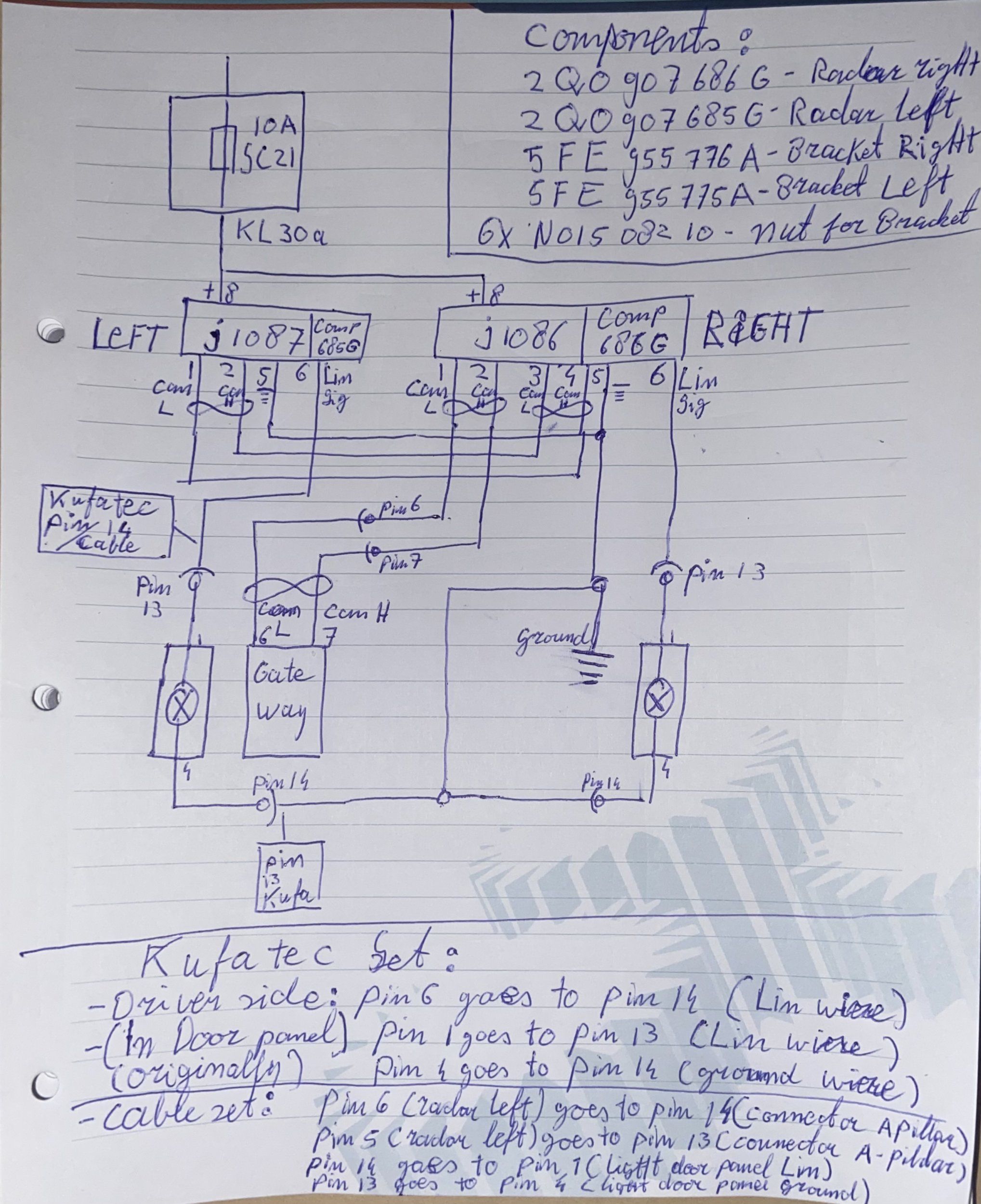

Last but not least, I made schematic which shows which wires go where, and component numbers. Kufatec set I bought: (includes installation https://kufatec.com/en/lane-change-assistant-incl.-rear-traffic-allert-for-seat-leon-kl/45285
For my car, the left side already had the cable in the door for the light, but the pins were as original, unlike Kufatec set where the LIN wire left lamp is supposed to go into Pin 14 of door connector. In my case however Wire 14 had to be placed into Pin 13 of door connector.

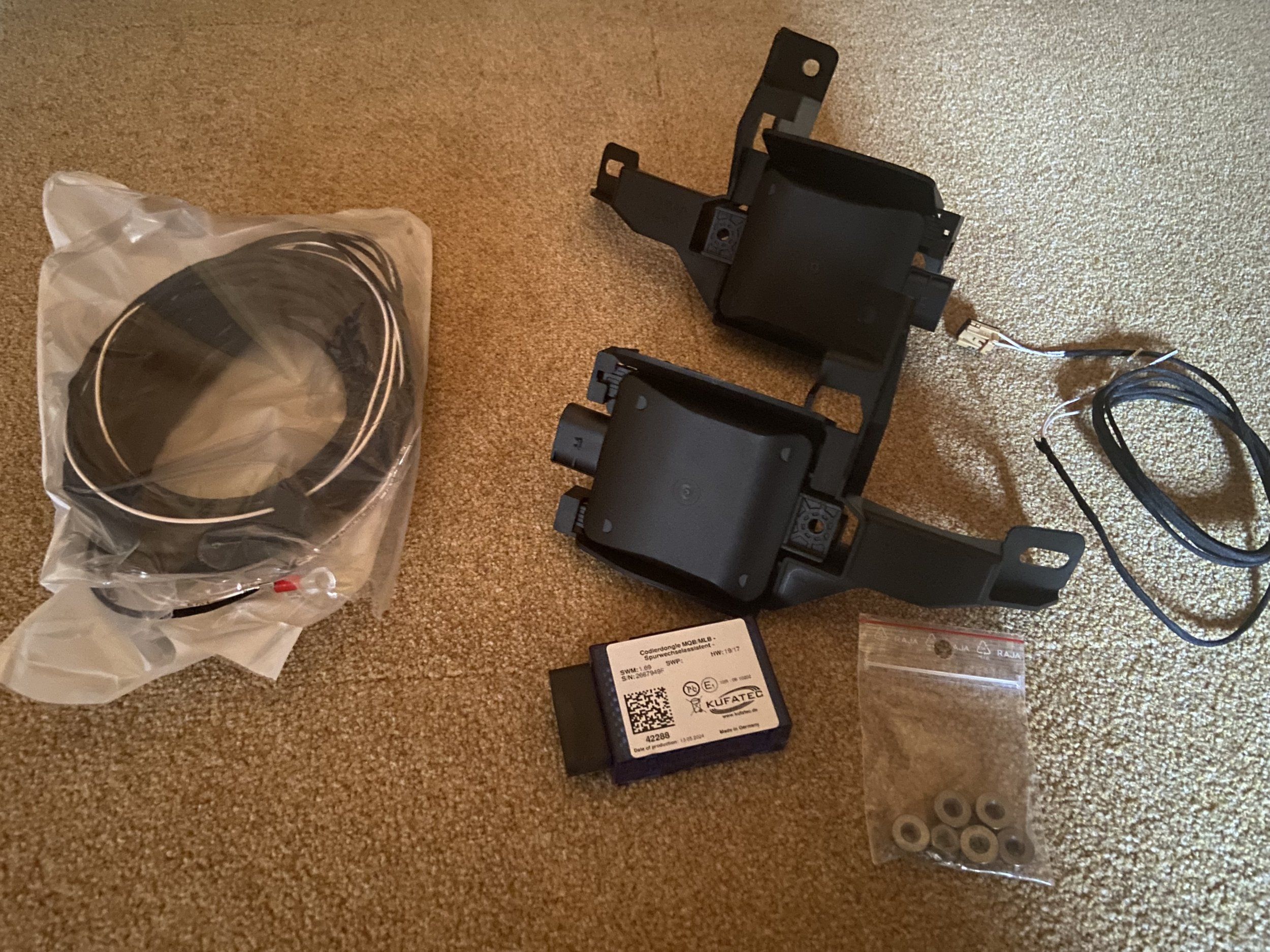

here an foto of the Kufatec set, but you can also buy components yourself and make your own cables, whatever you find easier and more fun. View attachment 43367

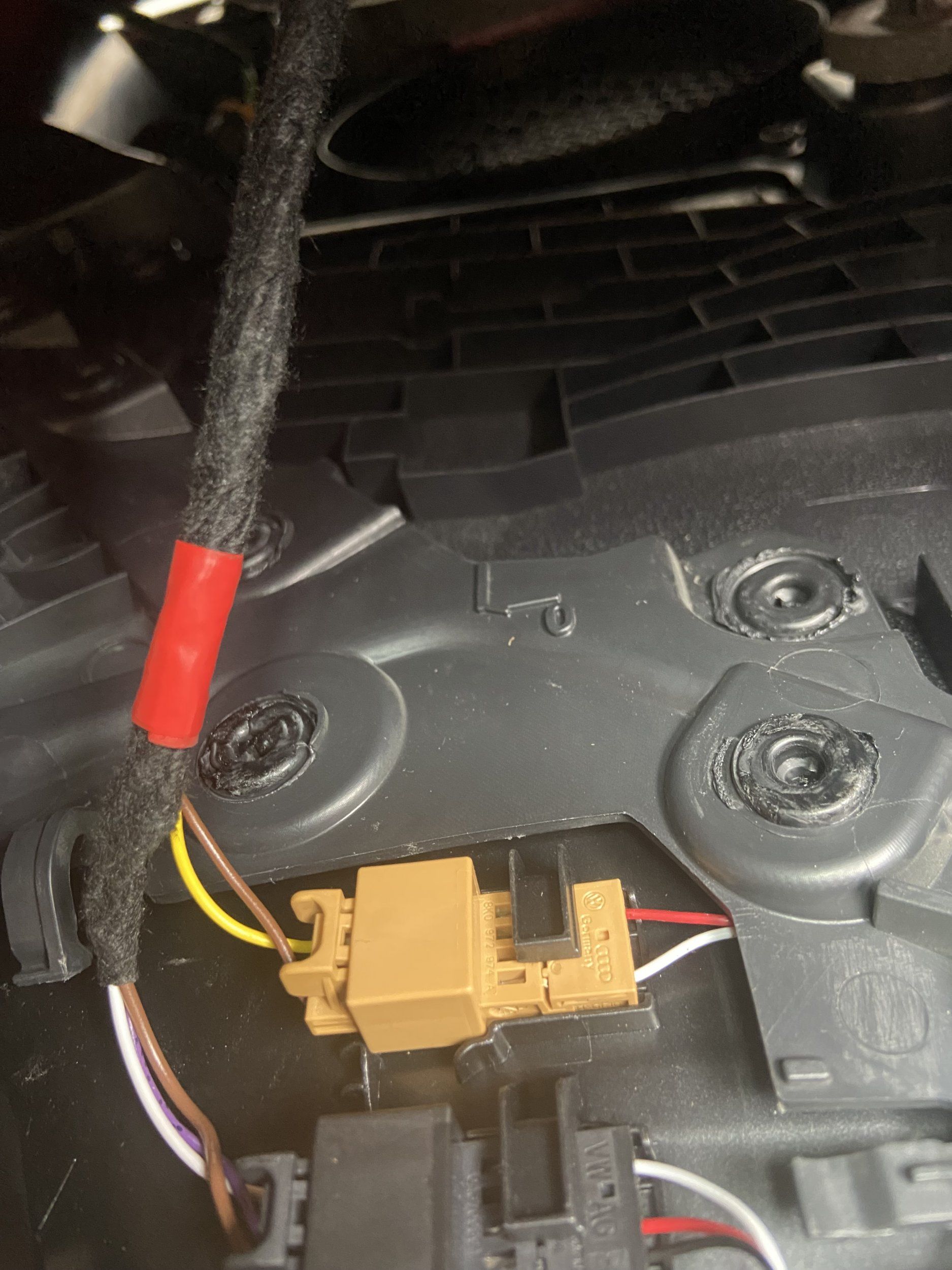

And as last, a photo of original Side assist lamp and cable in left doorpanel. View attachment 43368
