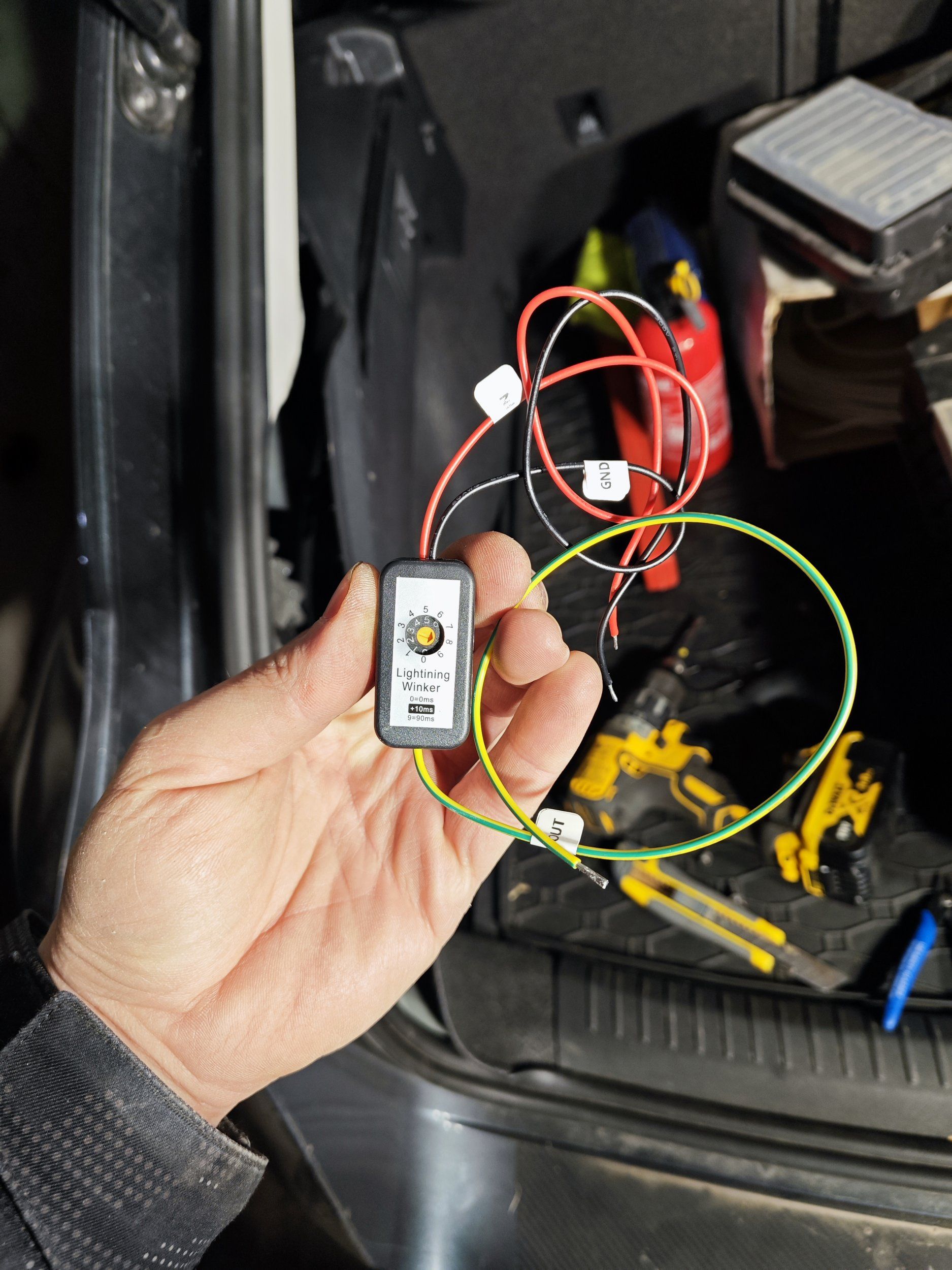

Little upgrade. Chinese module from Leon mk3

Hello,
Have you had any issues with the indicators since you did this modification? I keep thinking about doing it nyself. Would you be able to give a guide how to go about doing it? I have a link to the part from your video comment.
Hi. I have no problems. No errors, no freezes. Everything works perfectly.
Reactions: Kfav82
That's good to hear. Do they come with instructions on how to fit?
yes. it's very simple. there are 3 cables. you cut the plus cable from the turn signal and connect this module to it, one is for ground. you don't have to cut the ground. apparently some model (I think Audi A5) has the same plug as Leon and you don't have to cut the cable.
Reactions: Kfav82
Thanks, I'll take a look into it

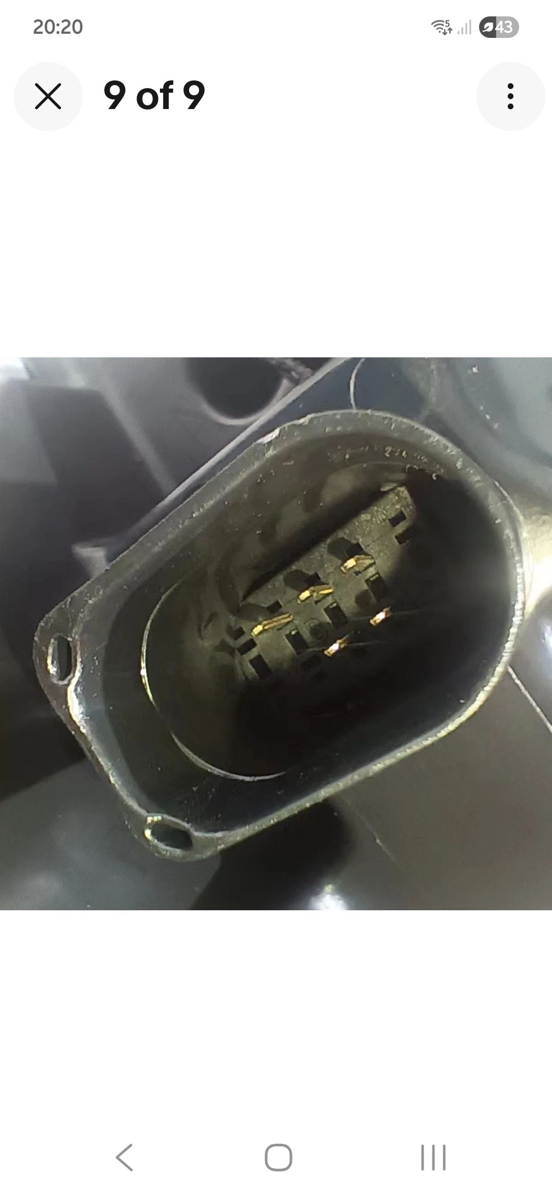

Hello @witek_77
I have been unable to find the audi a5 dynamic indicator module that you said may fit as the one I found has 6 pins instead of 5. Do you happen to know which ones they are? Thanks.
Hello @witek_77
unfortunately I don't know. I made a post on FB and someone told me I was stupid because he bought a ready-made one from Audi. I looked earlier but I didn't find such a plug either.
Reactions: Kfav82
Thanks for checking. I don't fancy cutting wires on a pretty new car that's all. I'll keep looking to see if something turns up.
Reactions: witek_77

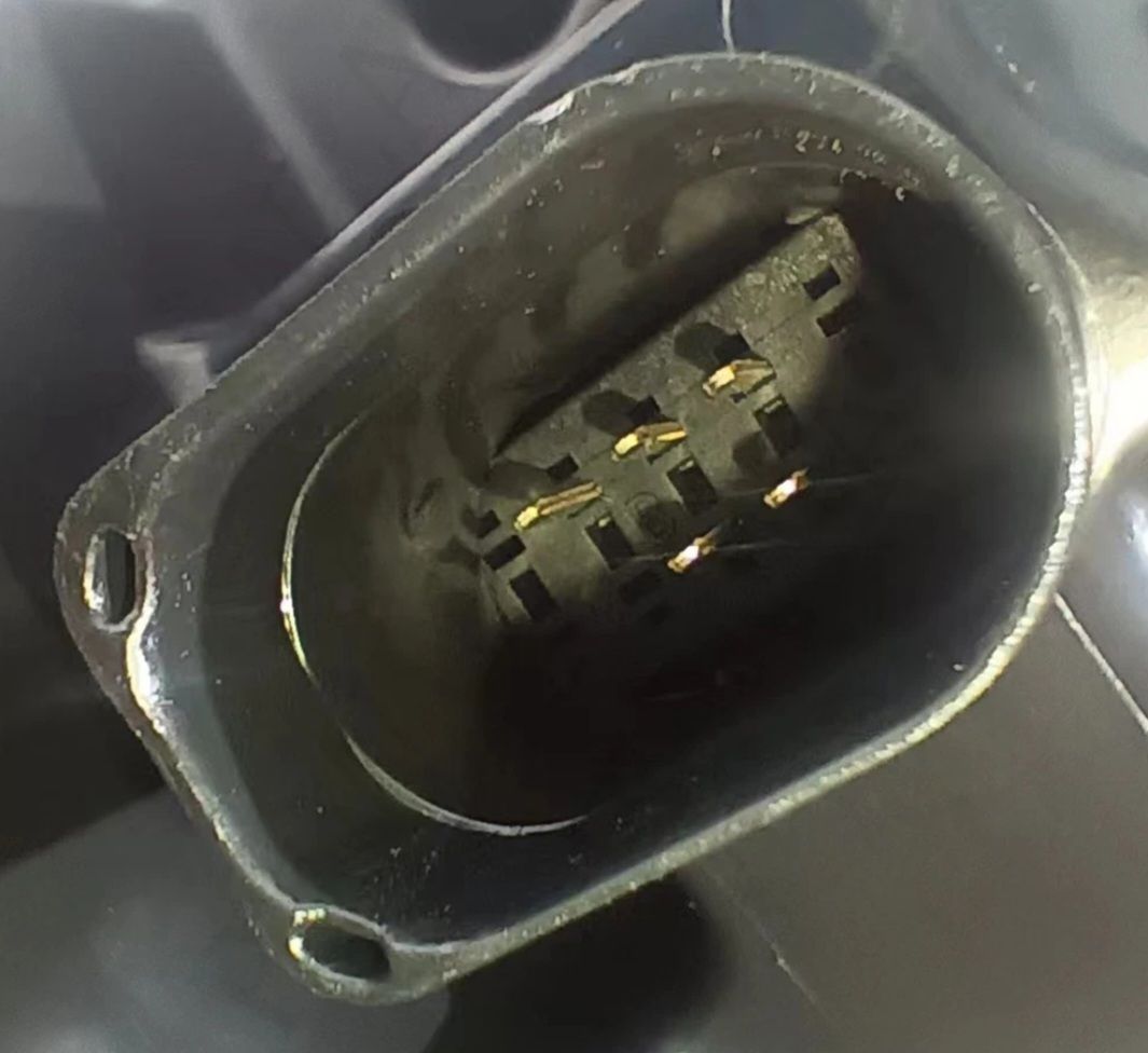

Der Link is 5 Pol from A4
This is the plug type. Its likely that the pins are wired differently in the audi versions. Surprised no one has made these for the Leon Mk4 considering so many didn't have them fitted due to shortages during covid.
