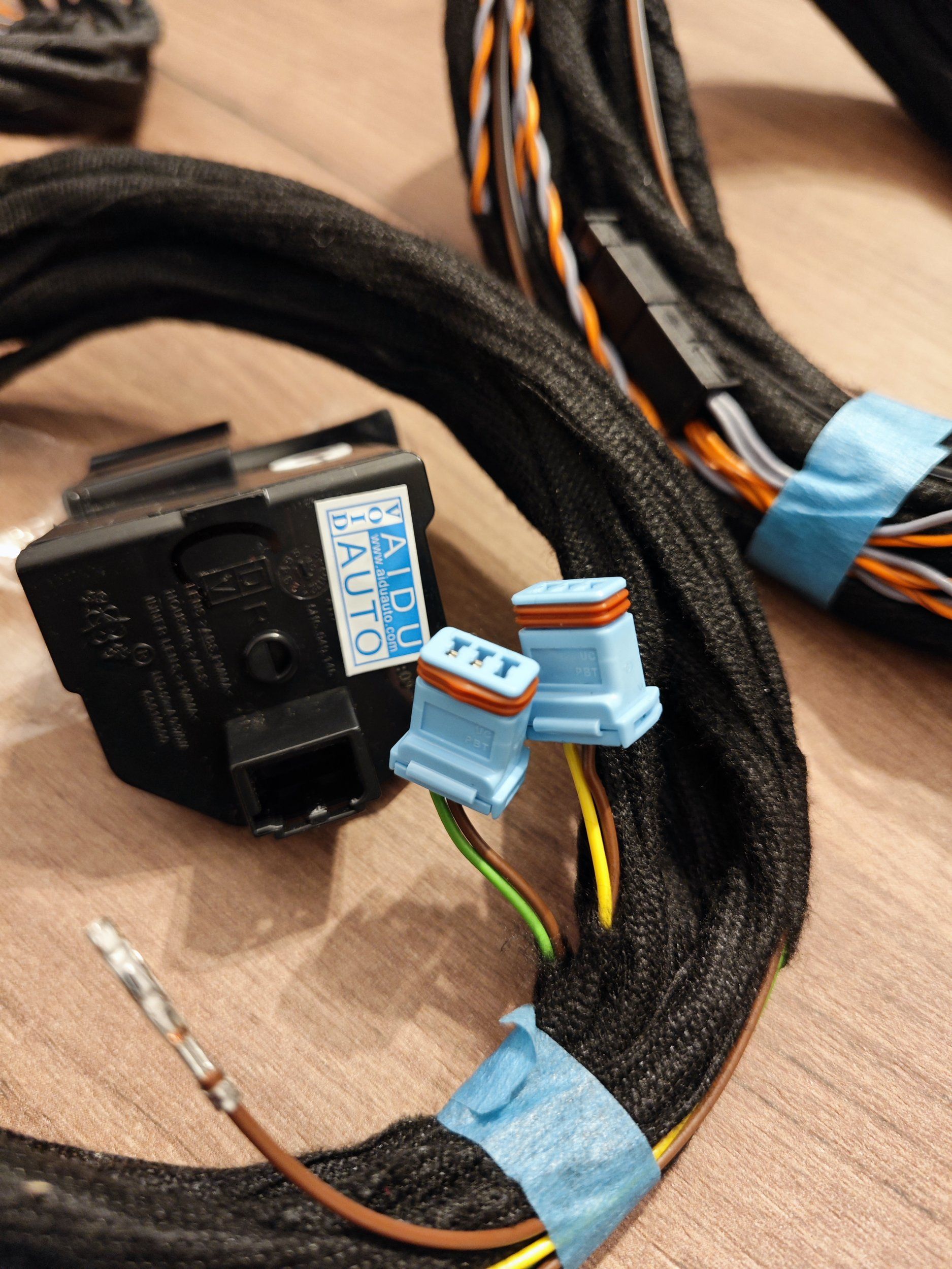

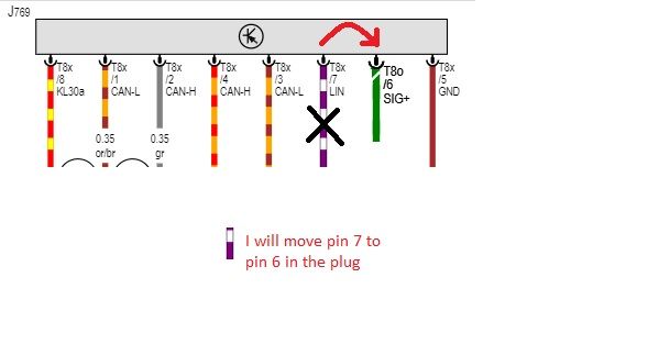

@Antera golf 8 have LIN on PIN7. Pin 6 is empty. I will move pin 7 to pin 6 in the plug. Is this correct ? However, I don't know what the combination of yellow and green in the third picture means

I understand dont now iff it work but let me now
and what did you change in your golf harness? I just saw octavia4 and it's the same as I did in my "paint" diagram. it looks like Golf 8 has a constant plus and minus, and the control is via LIN from pin 7. Skoda and Seat usually have lights and the plus is given from pin 6 and the minus is constant.
Did need no changes. Golf wiring is correct and works like you say. Im curious iff radar work also like you have in you wiring diagram ( radars work on Polo as your wiring diagram) So i think your are spot on

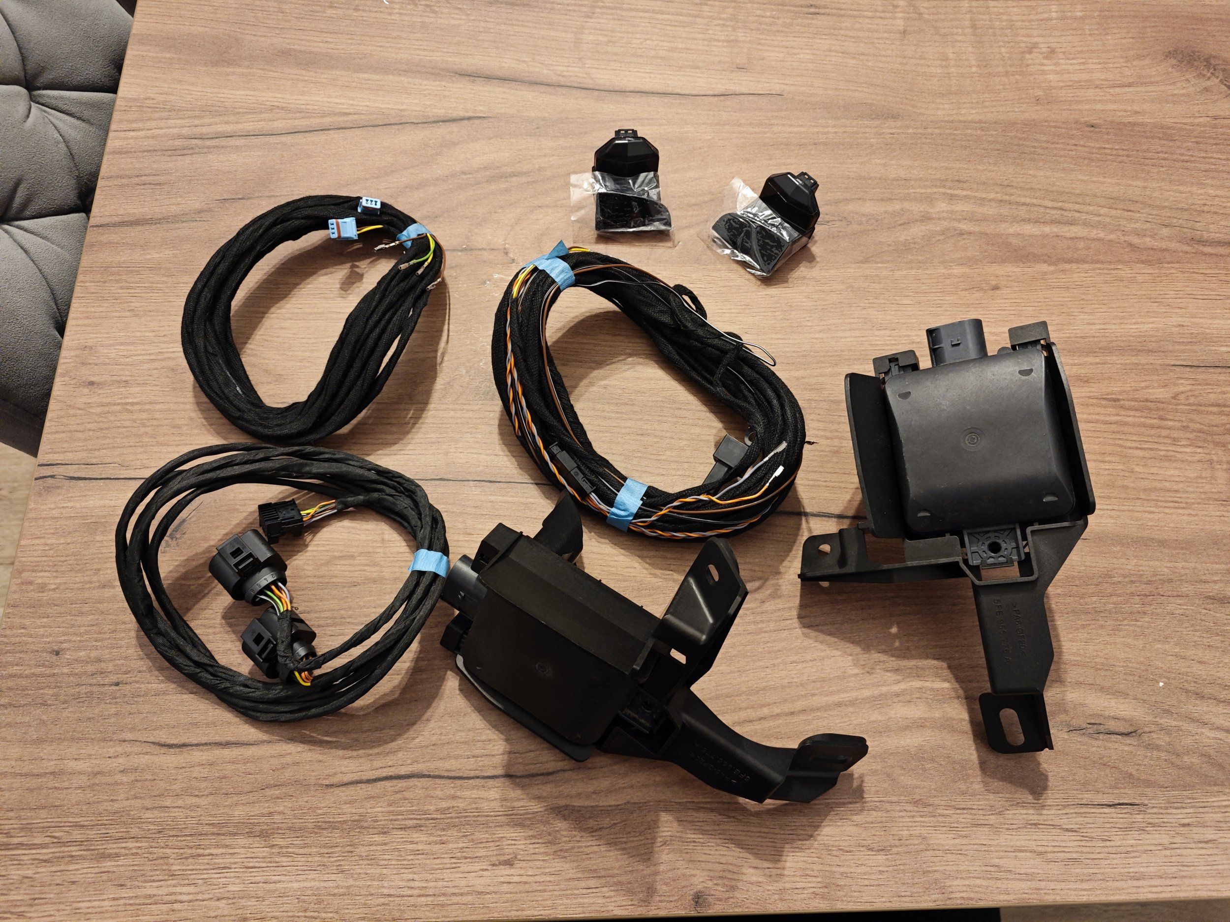

All right. I came back from holidays. time to do the first thing. I already have everything I need. I will only put lights in the mirrors. As you sat, it looks like the cables from the Golf 8 are exactly like those in the Seat.

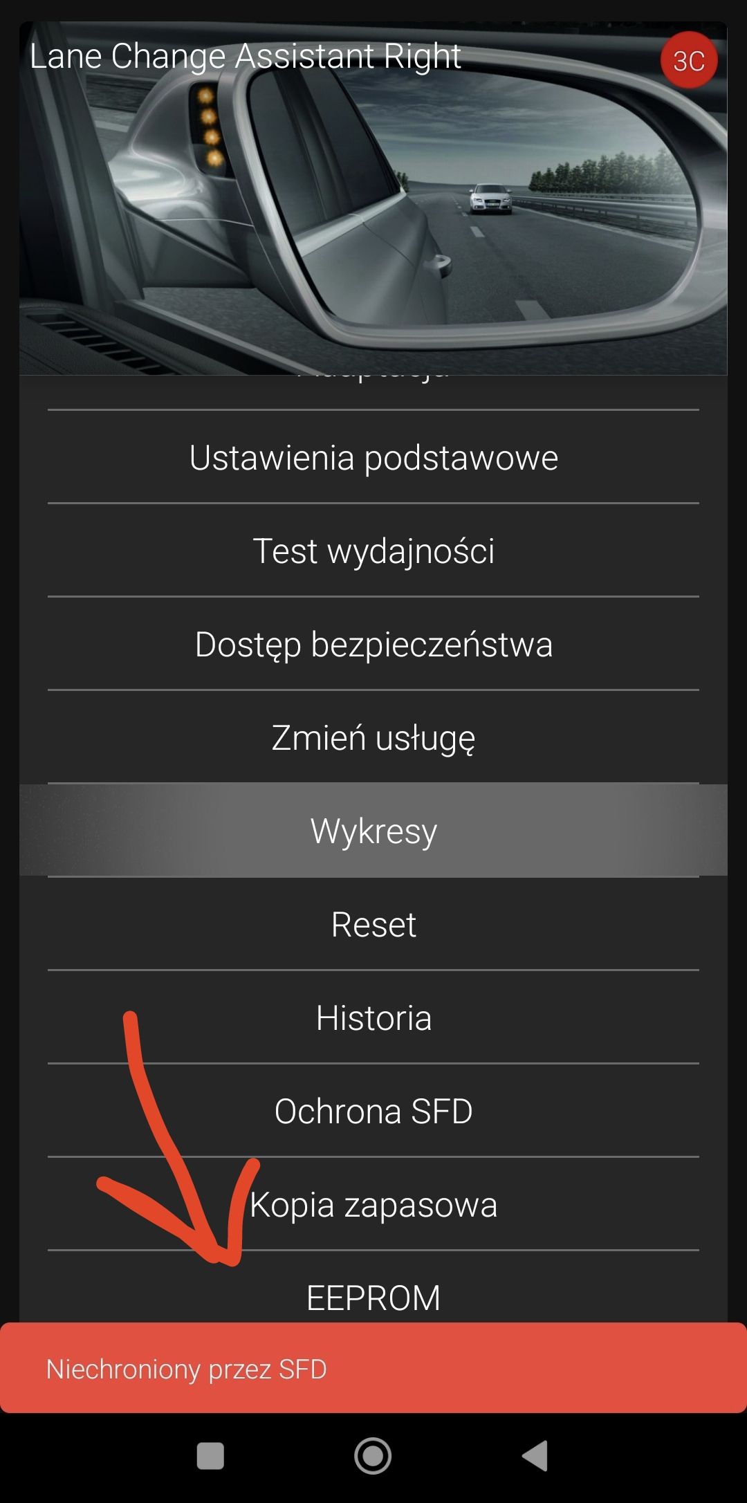

Ok. Now i need someone who remove me CP and change dataset.

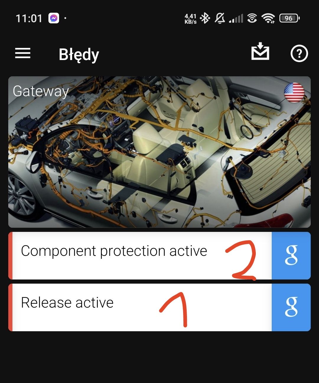

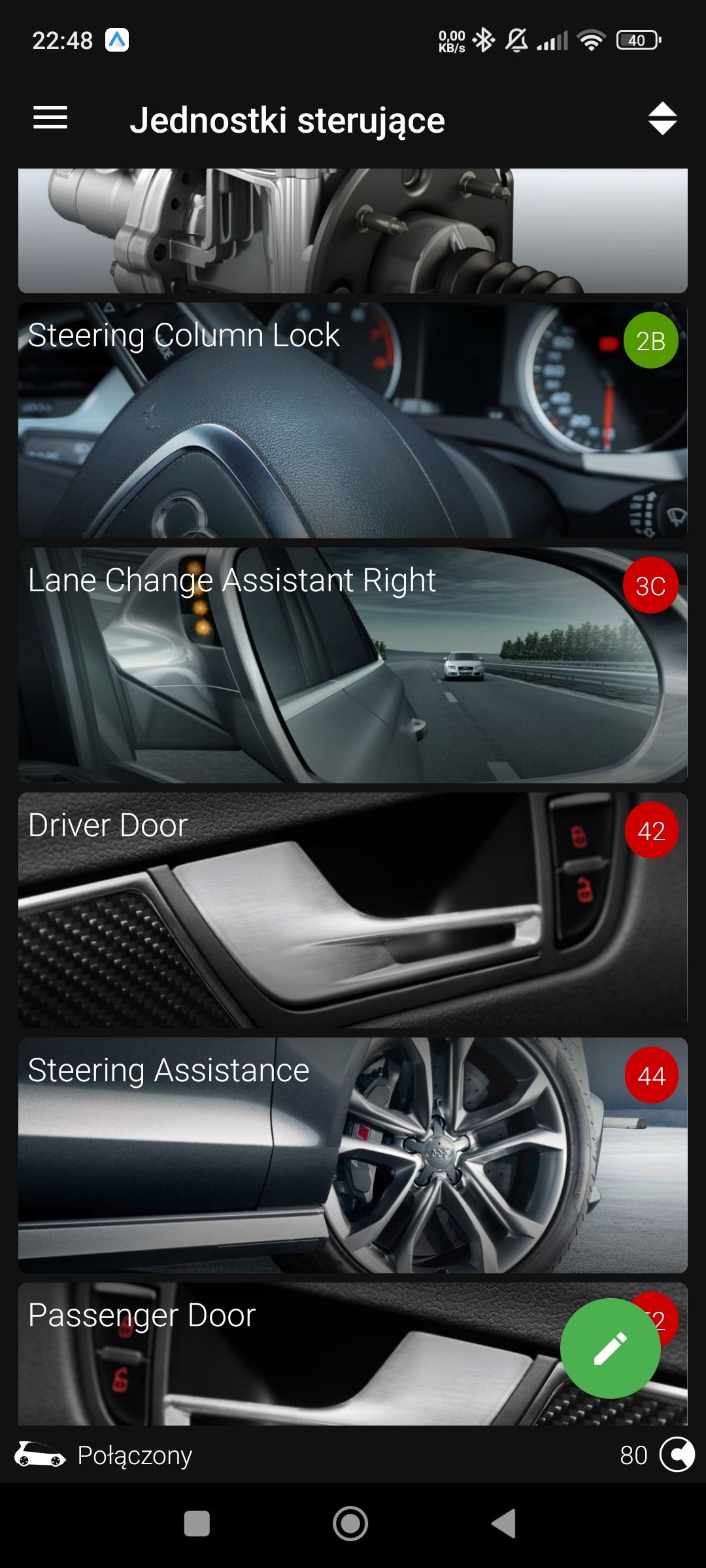

No. obd11 cannot remove component protection. it can only unlock a controller that has an SFD lock. the 3C controller is not protected by SFD. my radars were assigned to a different Vin number in a different car. now it has to be done through VW servers so that they know that they are not stolen. number 1 is that I have unlocked the SFD and number 2 is the information that it has component protection applied. "Niechroniony przez SFD" means that this driver does not have SFD protection, only ordinary code for adaptation. What is your long coding on 3C ?
Right module 19 you did fsd like i said. So you can tell the gateway you have the radars and it nows how to communicate.
3c dont have fsd indeed.
that's what I did at the beginning. I added 3c in 19, that's why I have a component protection error and not a data bus error. I've already added a few things to this car. what is anti-theft protection? you have to remove the vin number from it and only odis online does it. checks the FAZIT database to see if you have stolen it and removes protection.
https://forum.obdeleven.com/thread/9380/component-protection
You need to have component protection removed. You also need to parameterise the radars. Neither can be done with OBDeleven
You'll need to carry out coding in multiple control modules.
Do you understand the wiring now? Everything is explained on them in the notes so it's worth reading those if you're confused
I have everything done, i.e. the electrical harness. I only coded the gate and nothing else because I know that I need to remove the component protection. as well as parameterizations. I have Golf 8 radars. I'm waiting for the date and a gentleman will program it for me in February. the problem is that in ELSA online there is not everything described for Seat as for Golf. but I already have everything.

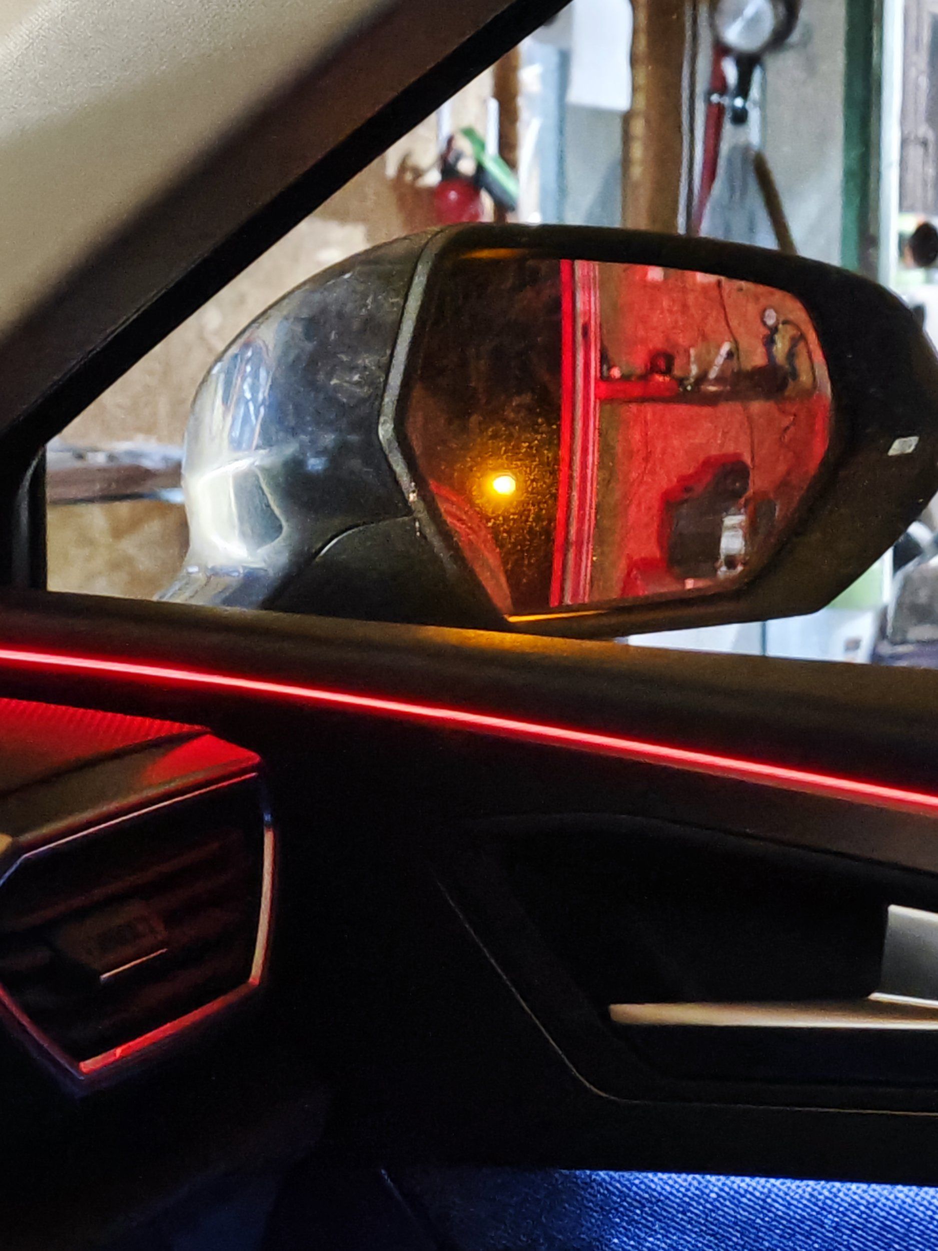

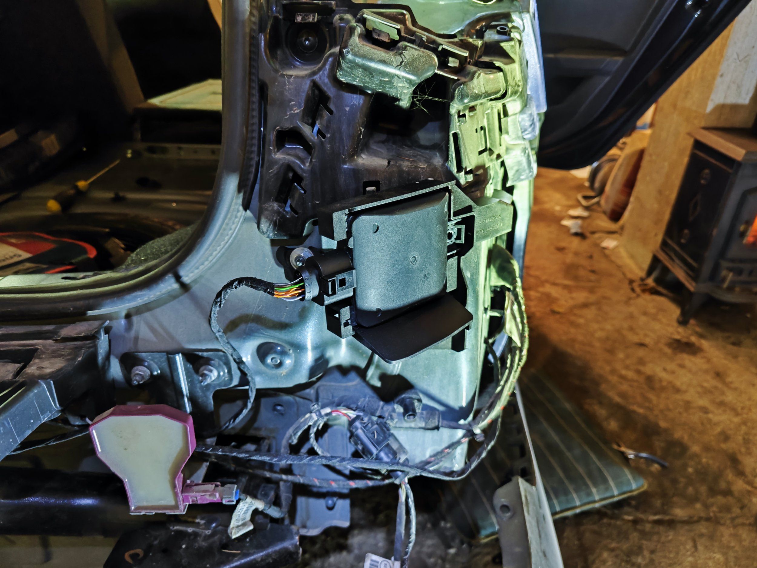

Final. I was at radar programming today. component protection removed, software from G uploaded to hardware D :) as I don't have the original door panels, only the Golf 8 lights, I did it differently for now. I prepared the harness for the original door panels, but I ran 2 cables from the plug to the mirror. there is one point in the mirror without a mirror and I used it. I broke the golf lights and took out the electronics. I glued it to the mirror with hot glue. it also looks very good for the time being, and ultimately it will be prepared for the original door panels.

That oke so 80 is coding for Seat :). It look great. I think there are no mirrors wich have the same form. But this looks also oke
