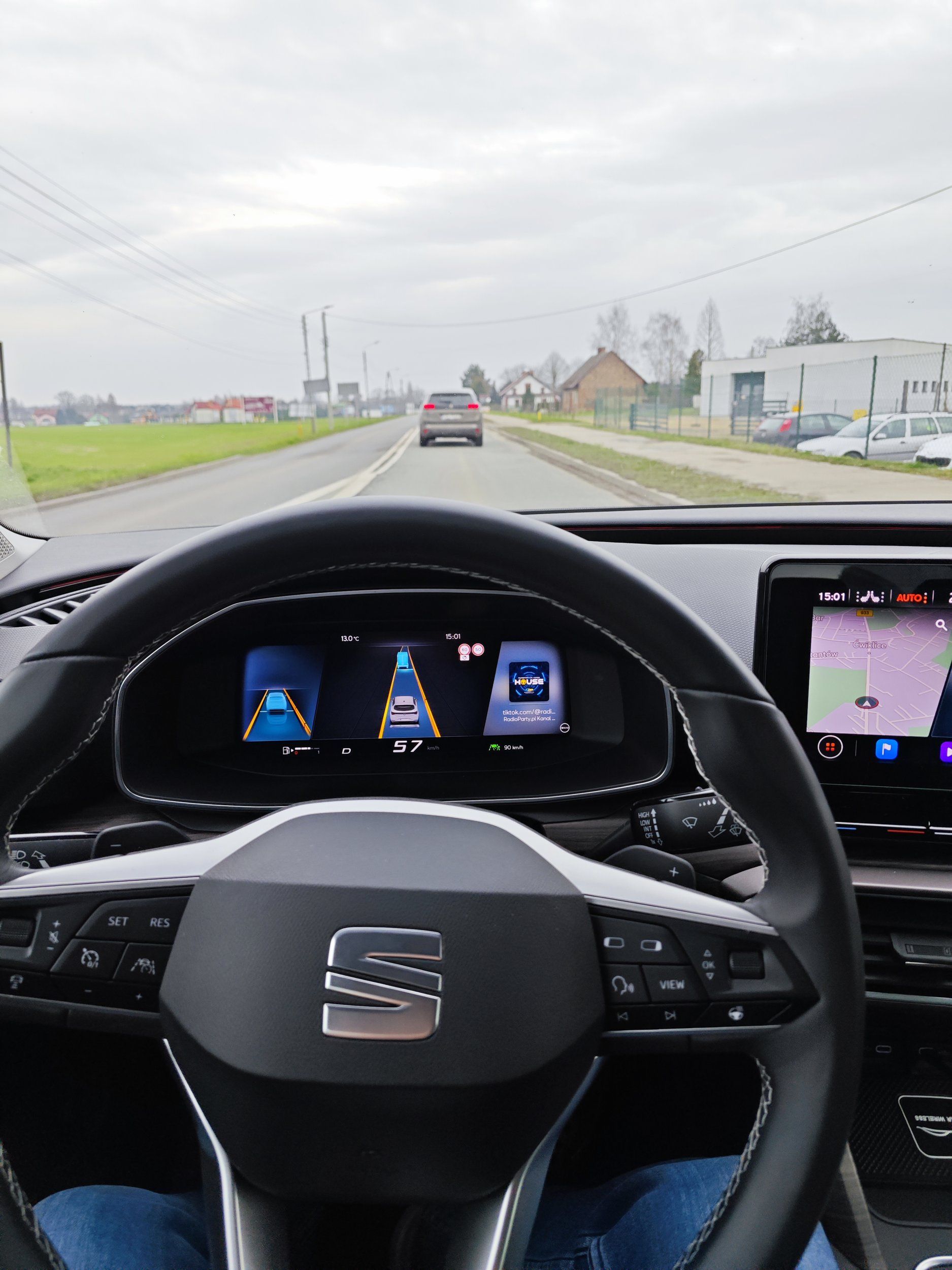

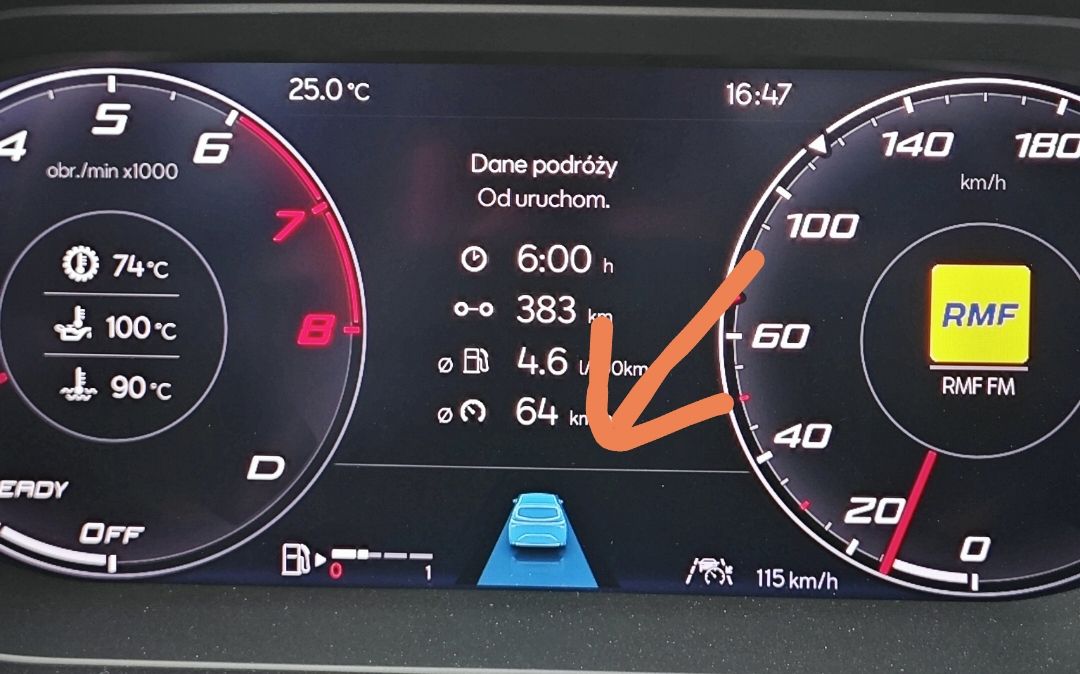

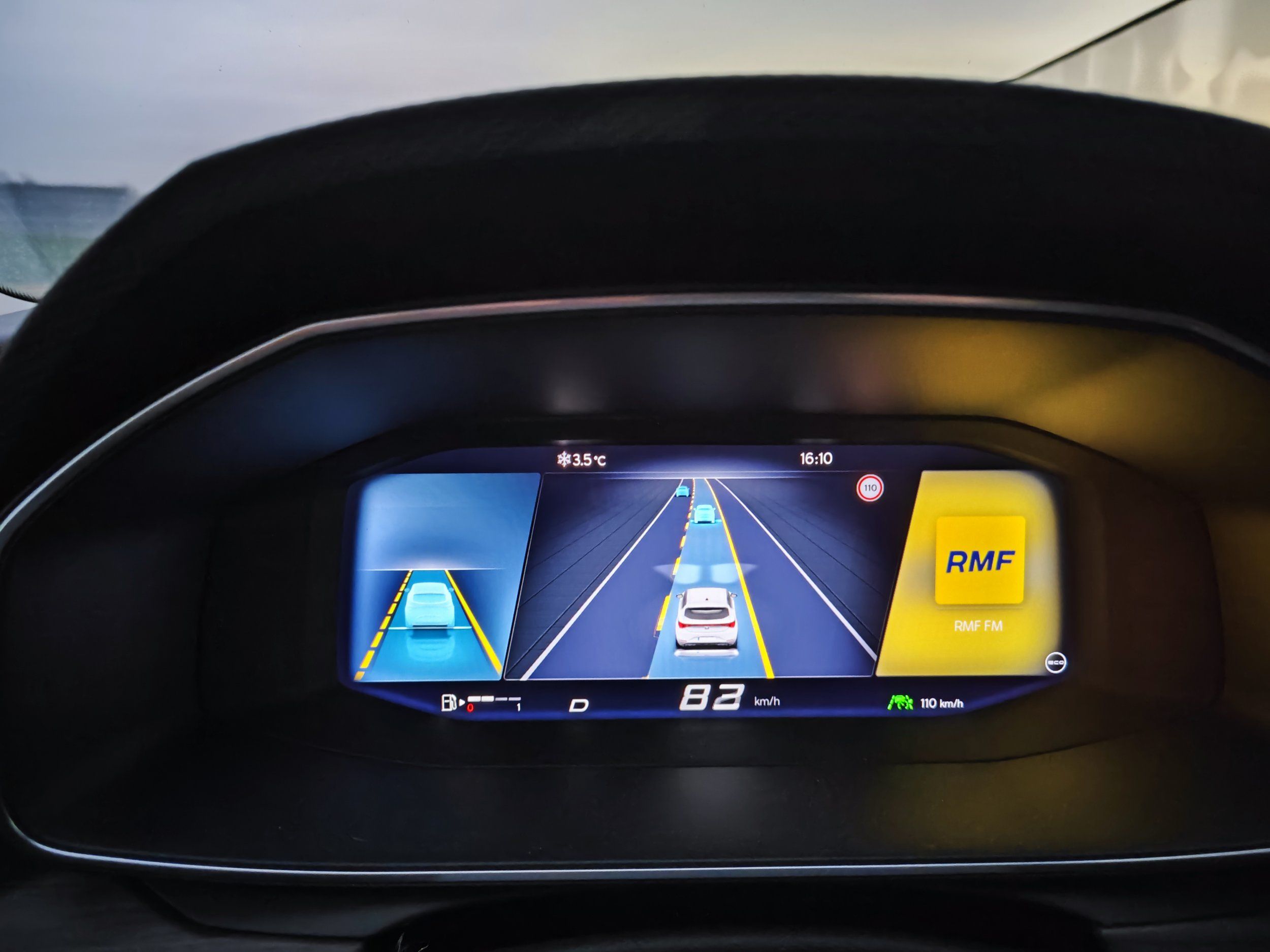

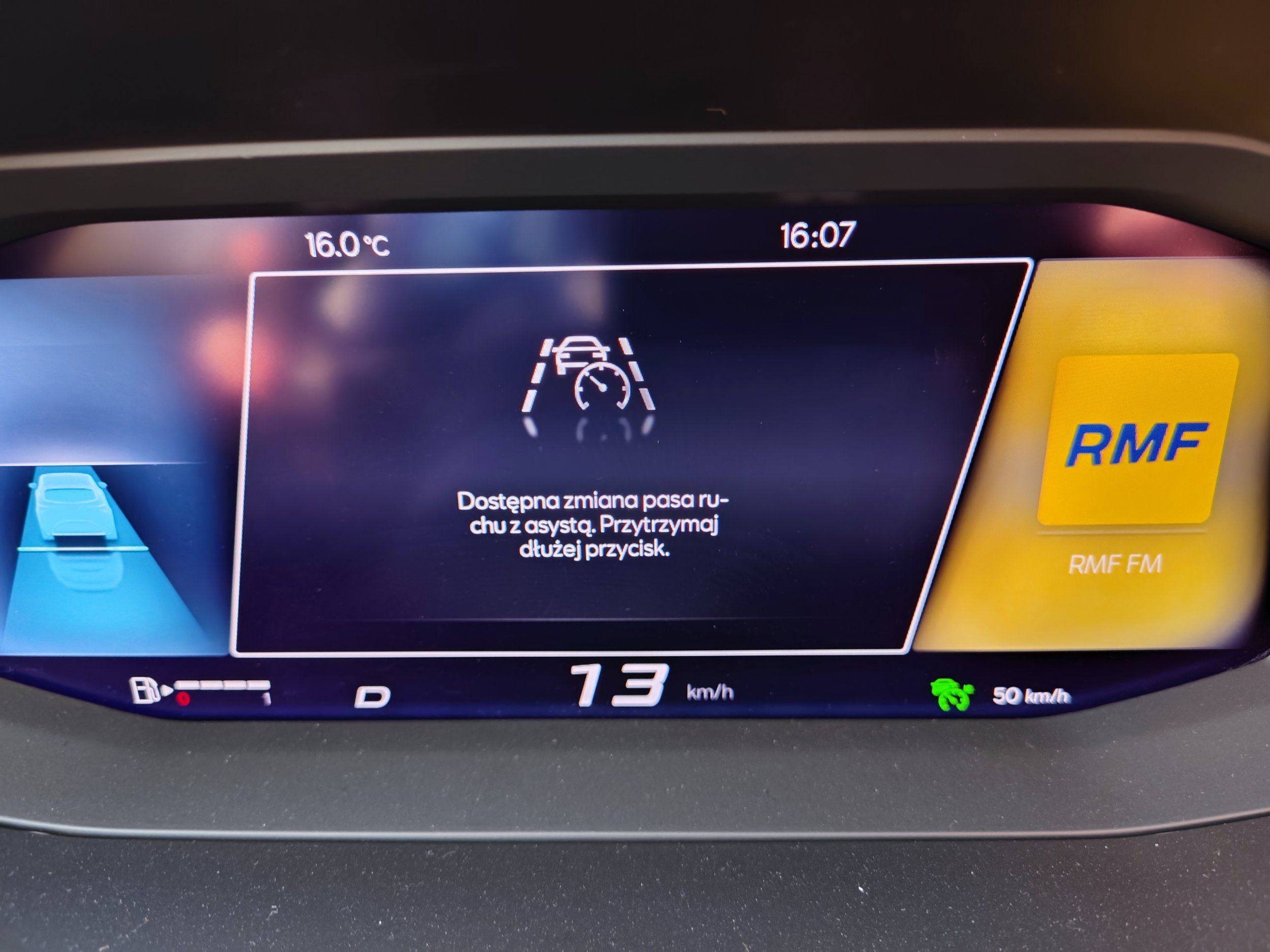

Hi all and merry christmas. I have a question about automatic lane change. it works fine for me even though I don't have QFK MA FUNCTION coded in controller 44 (i cant do this) but what I noticed is that the arrows only show up in additional assistant fields like in the movies. when I turn on the assistant view like in the picture (this is just an example of a view) it doesn't show it in the main one. how is it with you? the second thing is that when I hold the TA button it can't turn off or on automatic lane change. when I hold the button it just says "lane change available, hold the button longer" but nothing change. I have to do it through the menu in the radio. of course it doesn't affect the use because I don't use the assistant view anyway. thanks
Hello witek_77,
I would suspect there is some coding regarding the lane change that you have not activated. I have been able to get the automatic lane change in the menu, but it doesn’t work for me nor can I toggle it on or off.
From what I have heard the software of my camera is not up to date, but in your case I would assume the coding isn’t fully adjusted for lane change.
from what I know, is that when you have ‘double’ items in cluster, one of them is either deactivated or shows less, like when you show the bigger fuel gauge the smaller one disappears.
can you send me message of what you changed in coding to have automatic lane change work?
You too merry Christmas and happy new year.

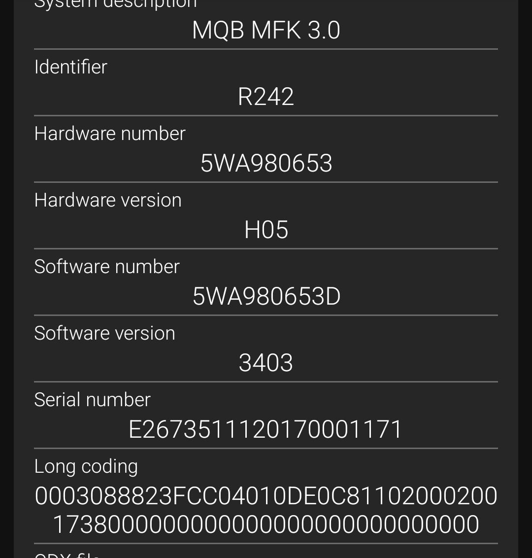

generally everything works fine for me except for switching on with the button and showing the assistants on the screen. only on the side or at the bottom. currently I have hc3 but I will try hc5. tomorrow I will go to the highway. I did not change anything in telematics either. should I? cool gadget especially since I have the KLR module which imitates the touch of the steering wheel and I do not have to hold it.
I have flashed camera from old software to 3403. my seat is from 2020 and had only 4 rear parking sensors from factory. I added 12 sensors, camera, blind spot, capacitive steering wheel, towbar and a few small things ?
For me I have the same hardware number, but Hardware version H06, however software is 3129 which is probably why mine doesn’t work yet.
have you tried to put the left side on different screen or nothing? So that the middle version had the arrows? Also does it change when you use different themes?

for me, no matter what view I have, the arrows only show up correctly in the left small view. if I put something else on the left side, the arrows work at the bottom. just like in the video. but they never showed up in the middle in the large field in the assistants view. I have very old hardware but new software installed. you also need it for it to work. after installing new software, the TA button works differently. once when I pressed it, the car immediately turned on TA and set the speed. now when I press it, only the TA icon turns on, but I have to click SET to start driving.

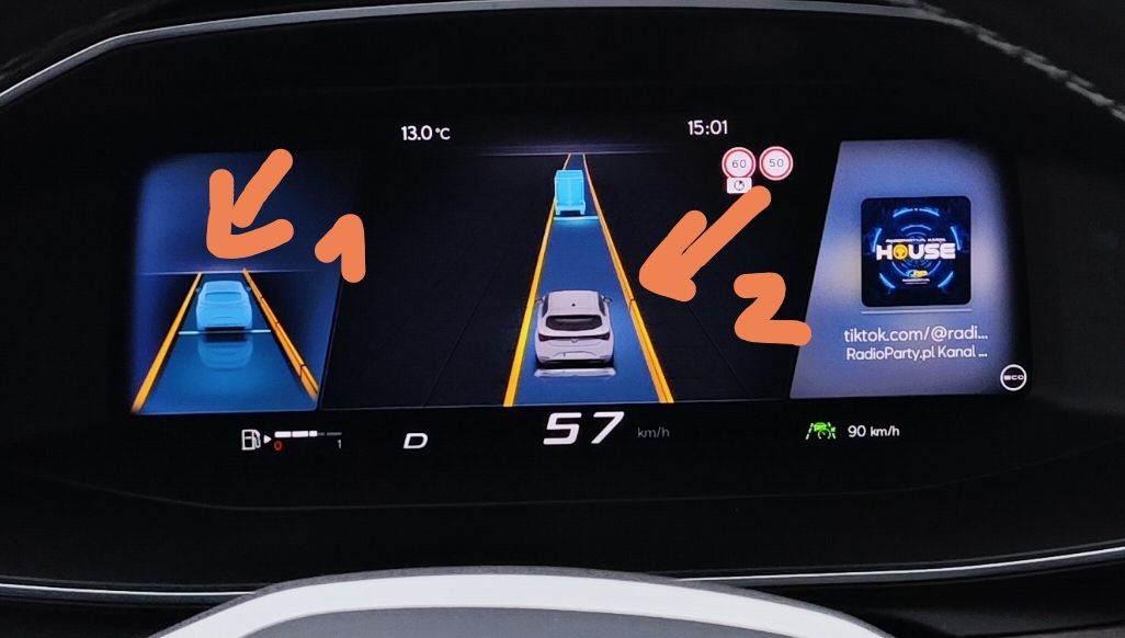

as far as I remember, the driver assistance screen in the menu is always on the bottom unless you use left side version or complete screen version. I use the shortcut of the side button on the blinker stalk to go to the settings menu/ screen. I currently am not near car, but I will make bunch of photos to show what I mean.

before the update I didn't have to press the Cruise control button. even if everything was off and I pressed TA, ACC, TA and it was as if I pressed the SET button were automatically turned on. Now when everything is off, I first have to turn on ACC, then turn on TA and then press SET to start driving.

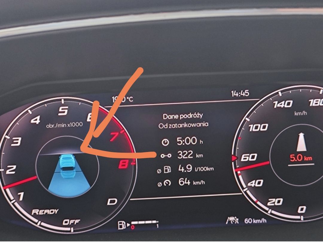

generally everything works for me except it doesn't show on the screen marked with an arrow with number 2. In all places marked with arrows the automatic lane change is shown as in the videos above. now the question is for those for whom the system works, does it also show them on the large screen marked with an arrow with number 2.

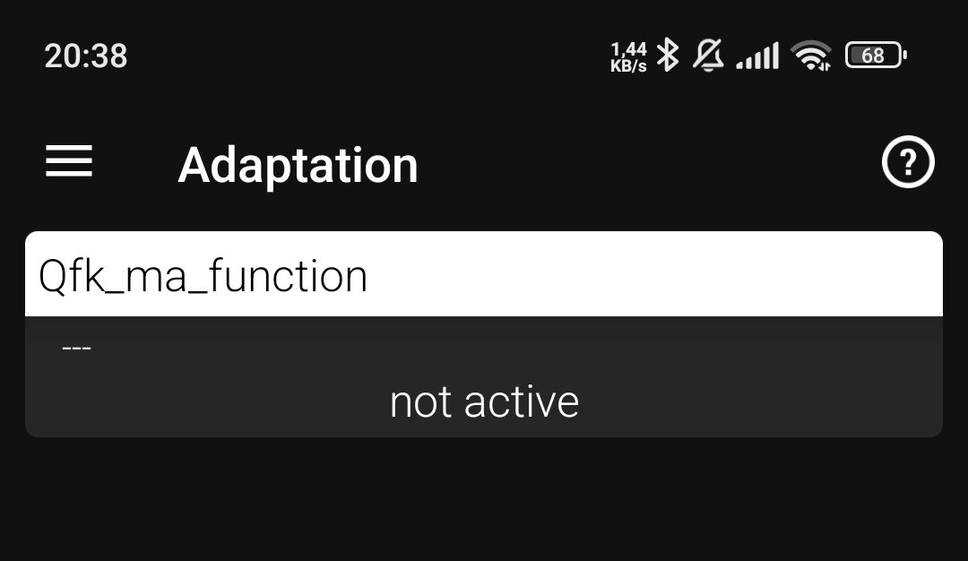

and the rest of the coding?
I had it coded before. I just can't change the qfk in the driver 44 because it doesn't accept it. But it doesn't matter because the assistant works for me so I'm going back to hc3. And so I always have the navigation view on the highway or the normal assistant clock on the left. And there it shows and works. Like on my video's.

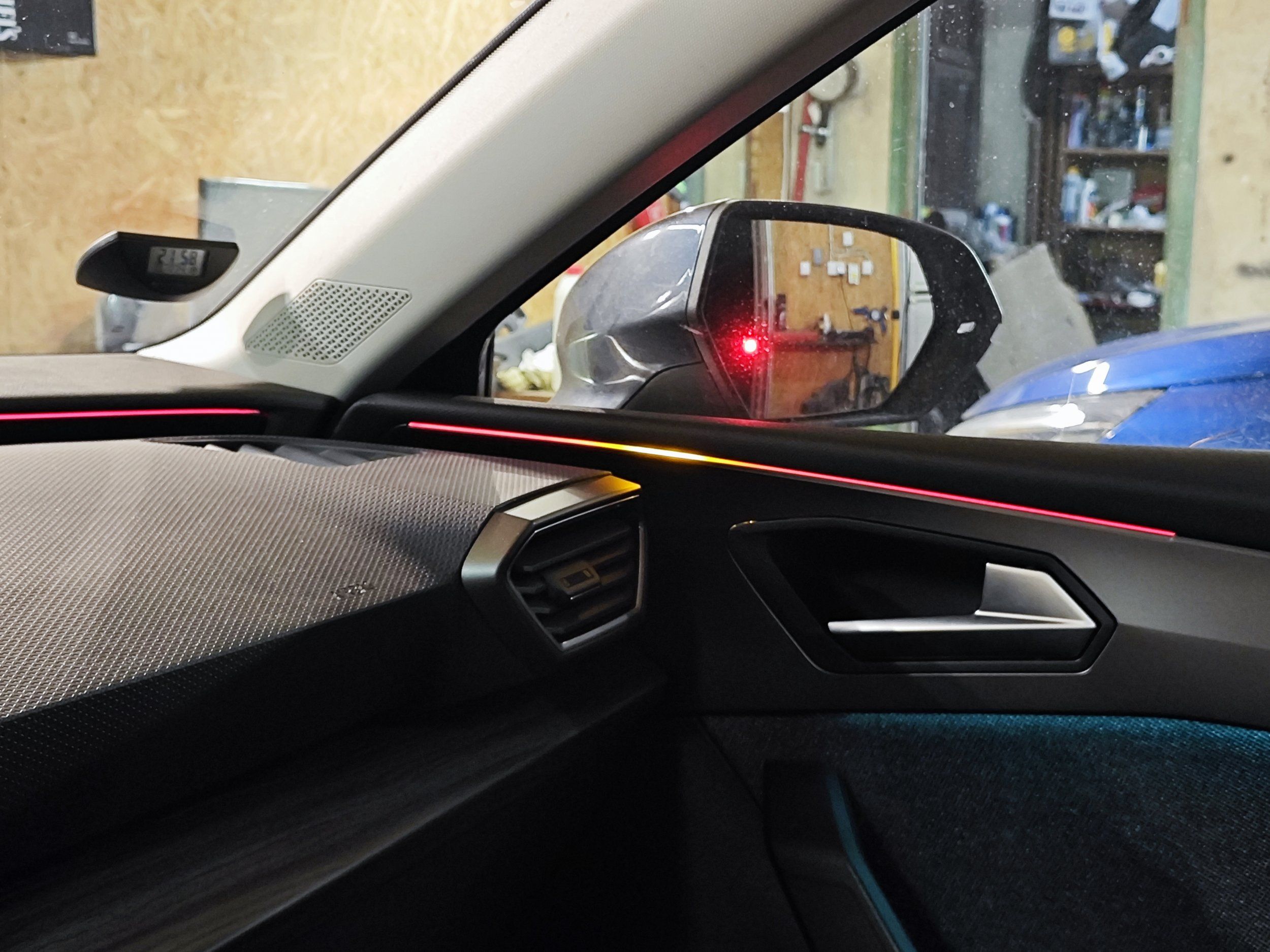

And little upgrade. Red LED are more visible on the sunlight than original Orange on door panel

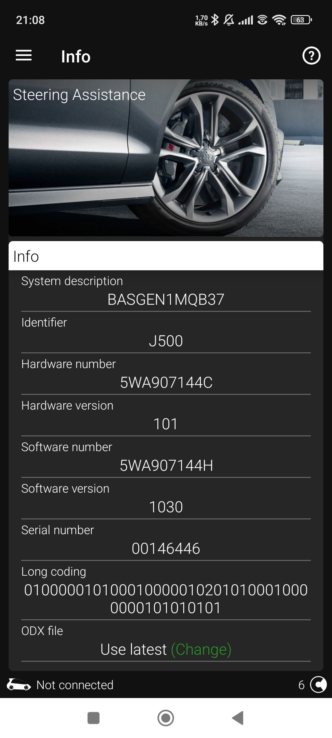

What error exactly occurs in the STG 44?
I don't remember but I don't think I have an error. I give active and accept. It shows success but it's still not active. despite this, the automatic lane change still works.
I also tried to manually enter the unlock code before coding but it doesn't change anything
Hood unlocked? Access code entered? Service put on development?
HW and SW Number of STG 44?
this is not my first modifications to the car ? I've done it a few times. Leon just don't want to accept it and that's it.
