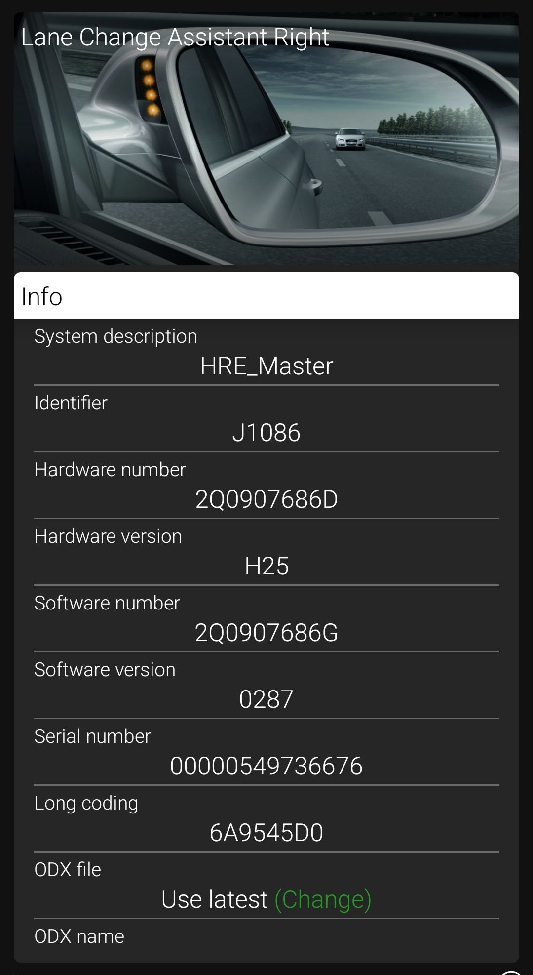

but the only thing I will gain from the new software is showing arrows in the main view or what? because the assistant works well, changes lanes nicely.
Yes

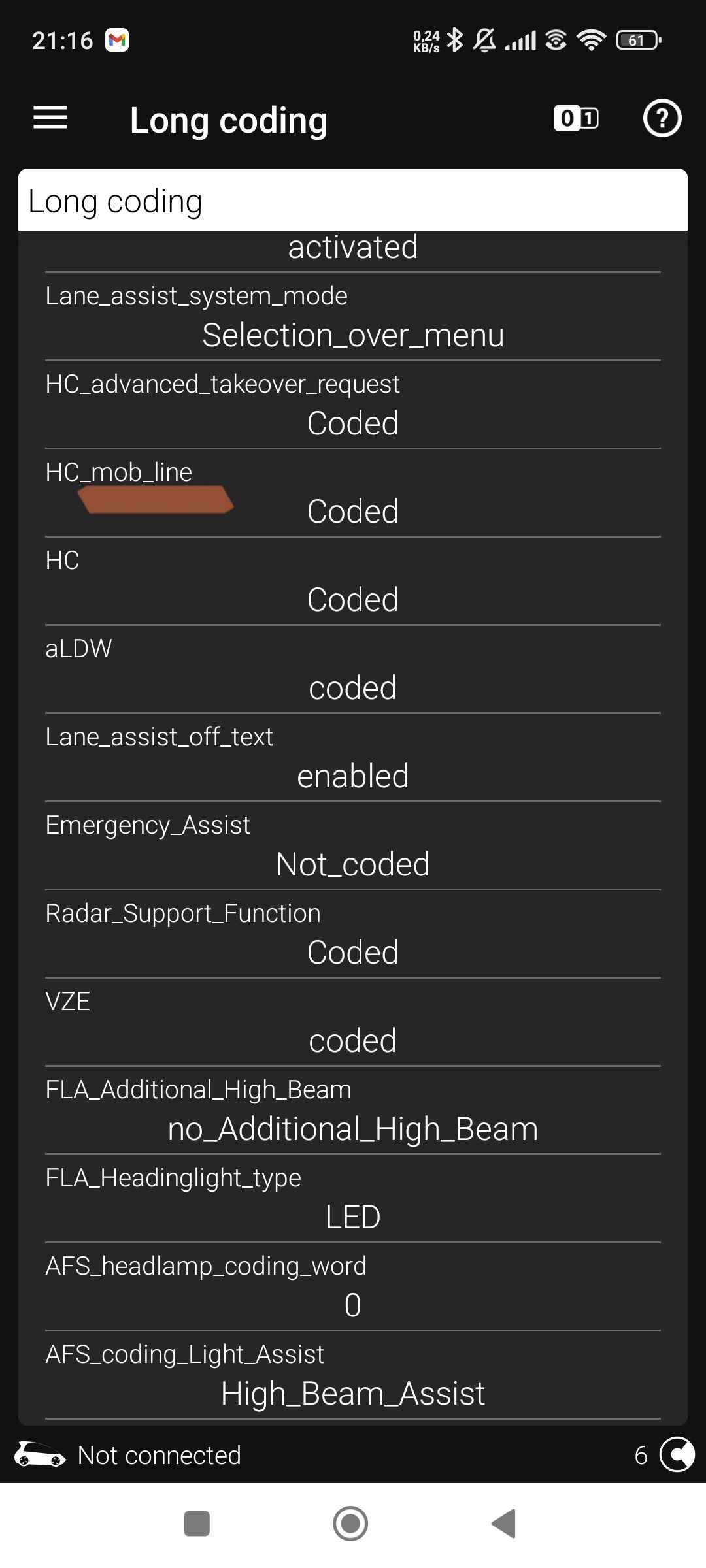

Do you have vcp or OdXX E?
I I also always try to do everything 100% and as the factory wanted. Here I have everything coded except for this. I have godiag passthru heads, I have free vc tool and I have odis E but in the hmm "educational" version. I have never done anything with these programs. I have always used vcds for older cars and now obd11. to upgrade the camera and remove the CP I had to drive 35km and pay.

You Change Kamera? Why not Flash?
No. Firmware only on cam. CP was from blind spot radars (i have used one). I have soft with G now
