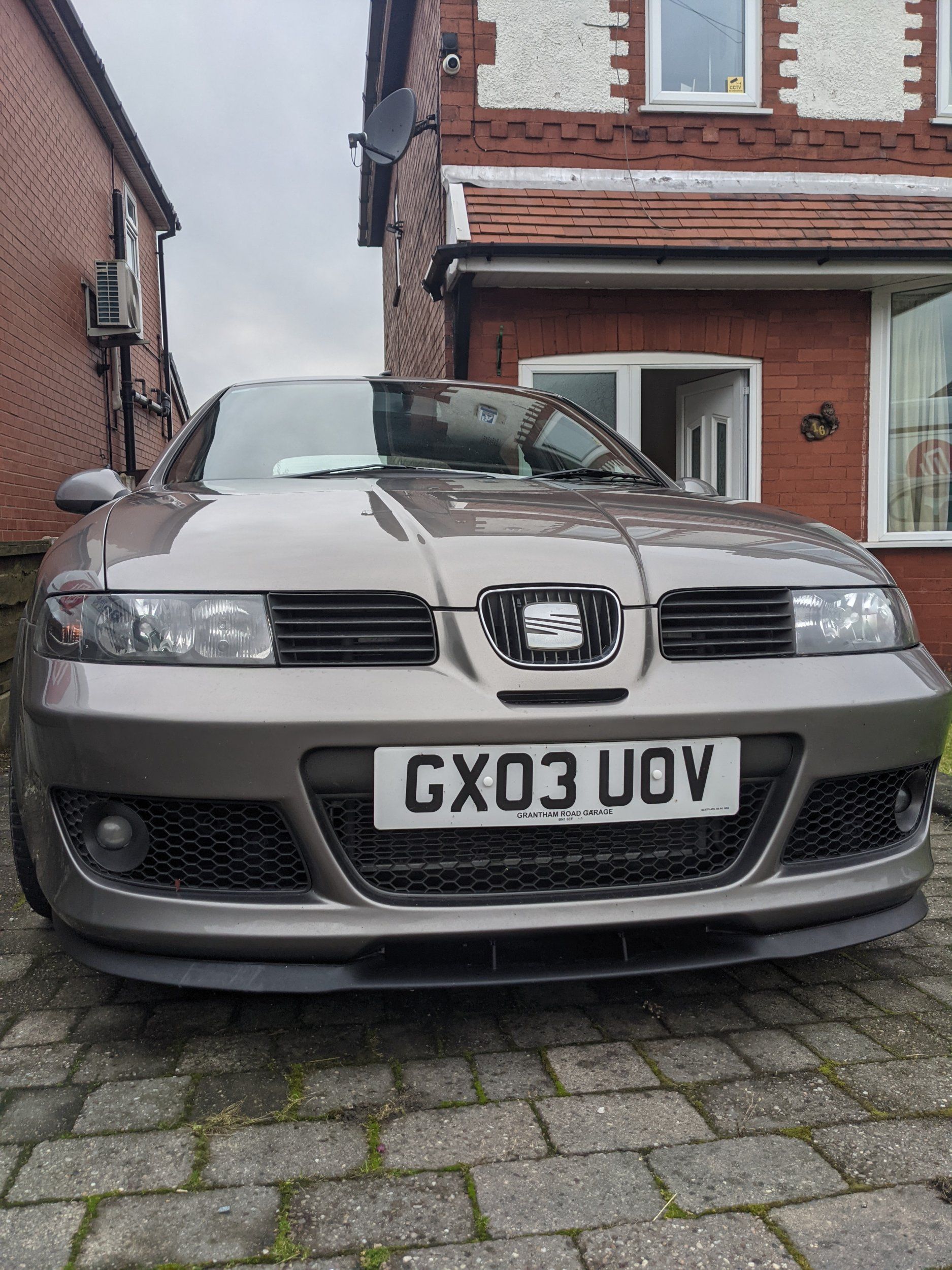

Hi all,
New to this forum so not sure what to expect!
I've recently picked up an 2003 LCR AMK. I'm having boost issues when under full throttle. The car seems to boost and then dump, boost then dump - like it's cycling on/off. In all gears and is more prevalent from lowish revs. Seems to dump on high boost and it's quite a sharp decrease in power.
Up to now I've done the following:
Replaced the original DV for an 'uprated' Forge 007. No difference.
Replaced the N75 valve for an OEM (through TPS) new part. No difference.
Bypassed the N249 valve, no difference (I have a new one to fit tomorrow but not hooeful on that).
As far as I'm aware, the car has not been mapped.
The car has been into Awesome Gti in Manchester and there's no faults at all, so it's not an easy find ?
Has anyone had this issue previously or am I chasing my tail? My next port of call is to book the car in with R-tech and let them work their magic.
Thanks in advance, Dan
