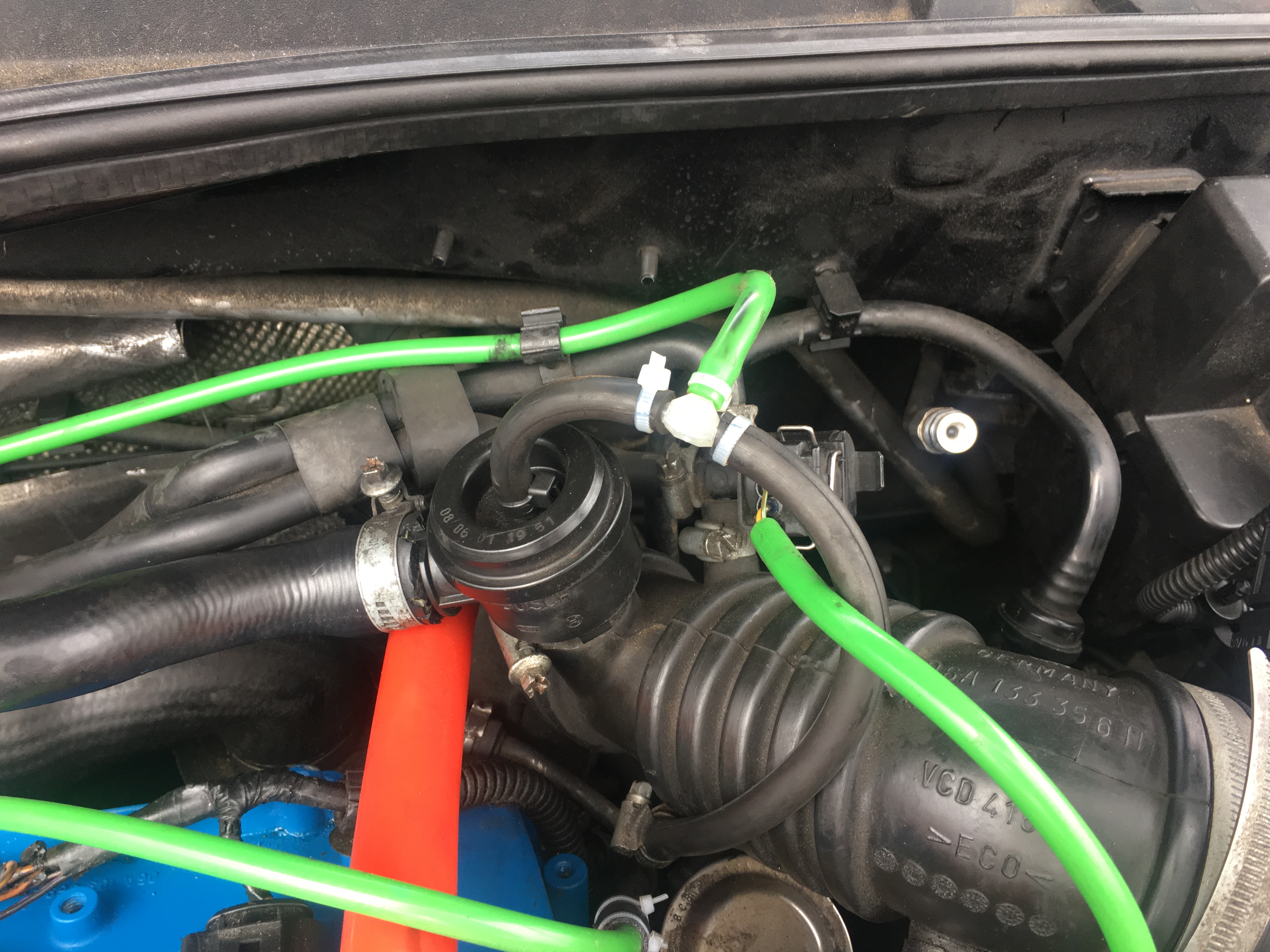

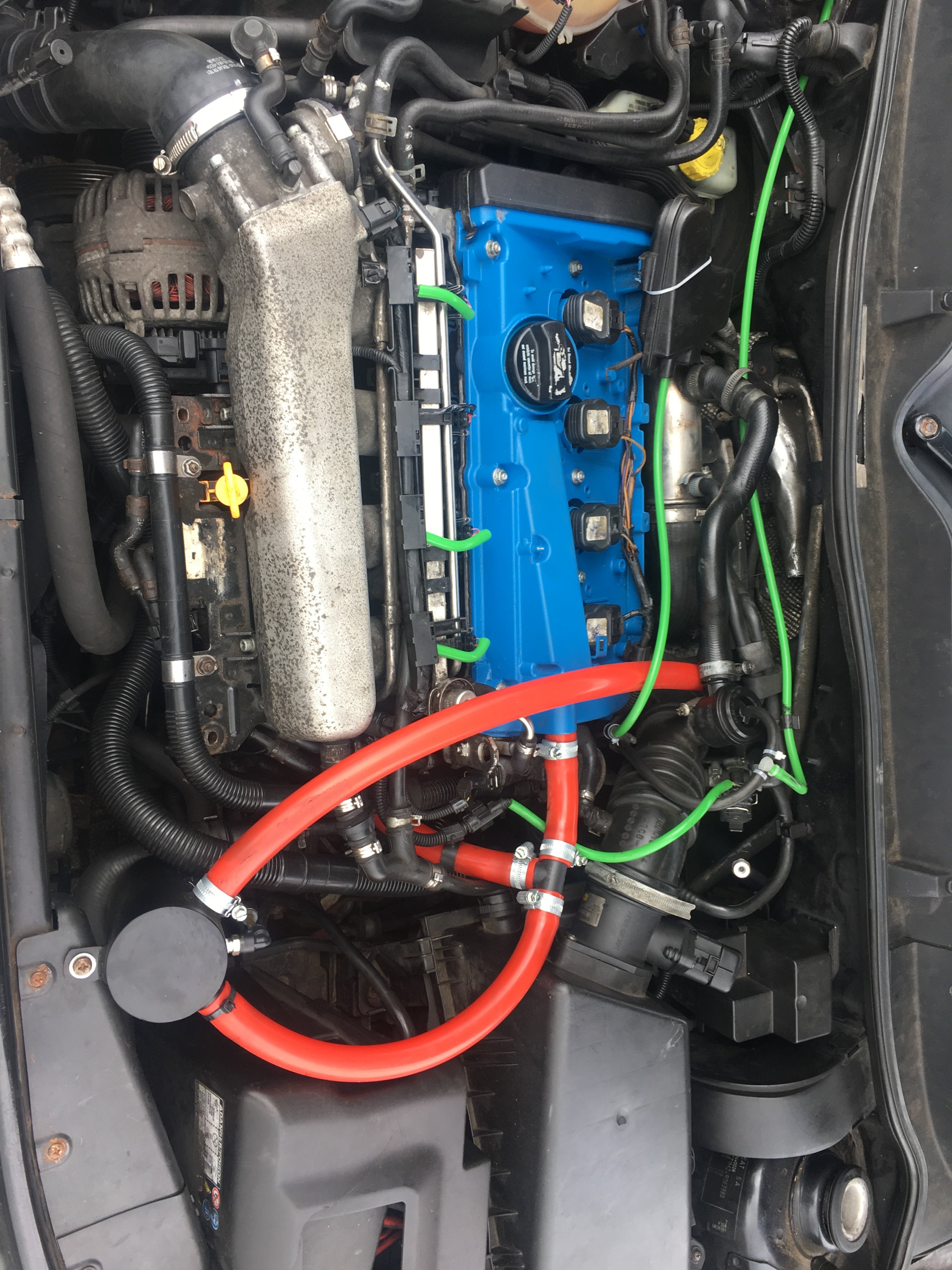

Yeh you got the BAM ? I wanted to do the KO4 conversion just cars done way too many miles unless turbo blows it staying as is. Here’s where I linked up my boost gauge would that give a proper reading ??
Also I added a catch can into the system as was going to some Deletes but found it’s linked into the Sai system so need to get a plate to delete that off and go again
Couldn’t find anywhere to put can so placed at the front for now will move above battery box when induction kit comes
tried to clear some of that oil vapour entering the system so left the can in as the pipes was very bitty and I felt the difference when changing just those red breather pipes.
Excuse messy engine bay
Loving that rocker cover
thank you. I was changing the gasket so thought I’d get rid of the silver flakey paint that was there now no more flakes and lovely blue. Was going to go down the route of skittles colour theme one pipe at a time lol.
