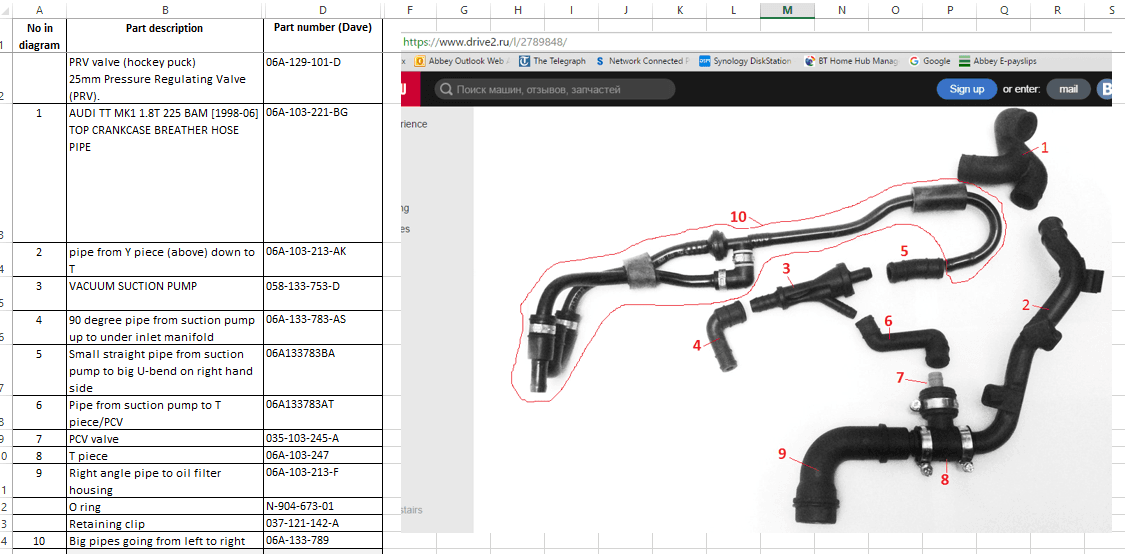

For reference, I drew up a list of part numbers a few years ago. I replaced everything except for item 10 (i couldn't stomach any more cost!!)
As @Thai-wronghorse states, catch can would simplify things and save cash, but this picture might prove useful for others in future.
Reactions: CooptoCupra
