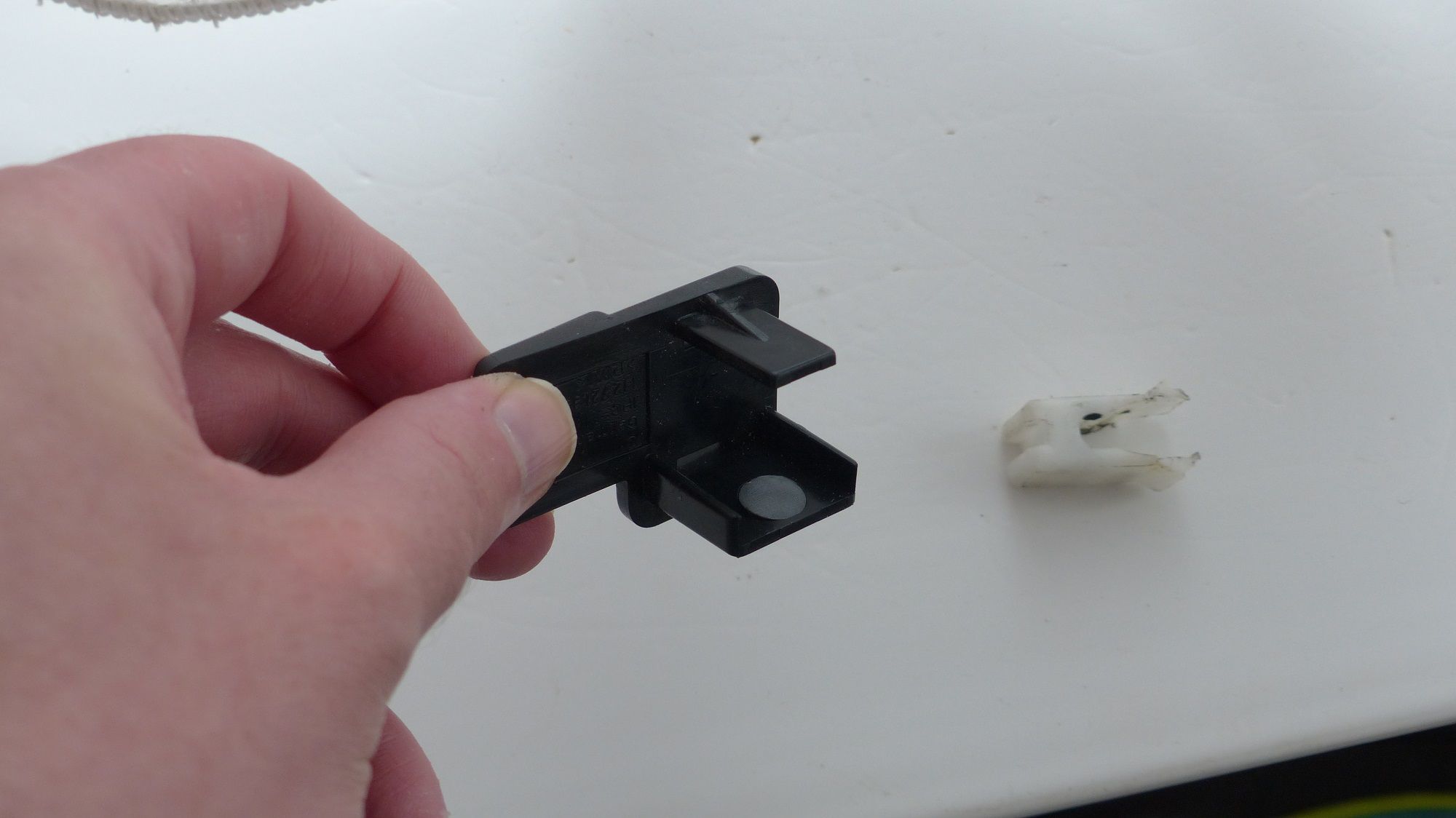

I was driving along and suddenly the clutch pedal became stuck to floor. I called the AA and he improvised a quick fit to get me home, he gave me two pieces of plastic from behind the clutch pedal (A black piece and a white clip/peg shape thing). I asked if I needed to take to a main dealer to get it sorted and he said I didn't need to. I took it to a place where I get my tyres and MOT done and they said they couldn't fix it, they actually showed me a link (From the Cupra forum) on the issue: https://www.seatcupra.net/forums/threads/clutch-pedal-sticking-down.391688/
