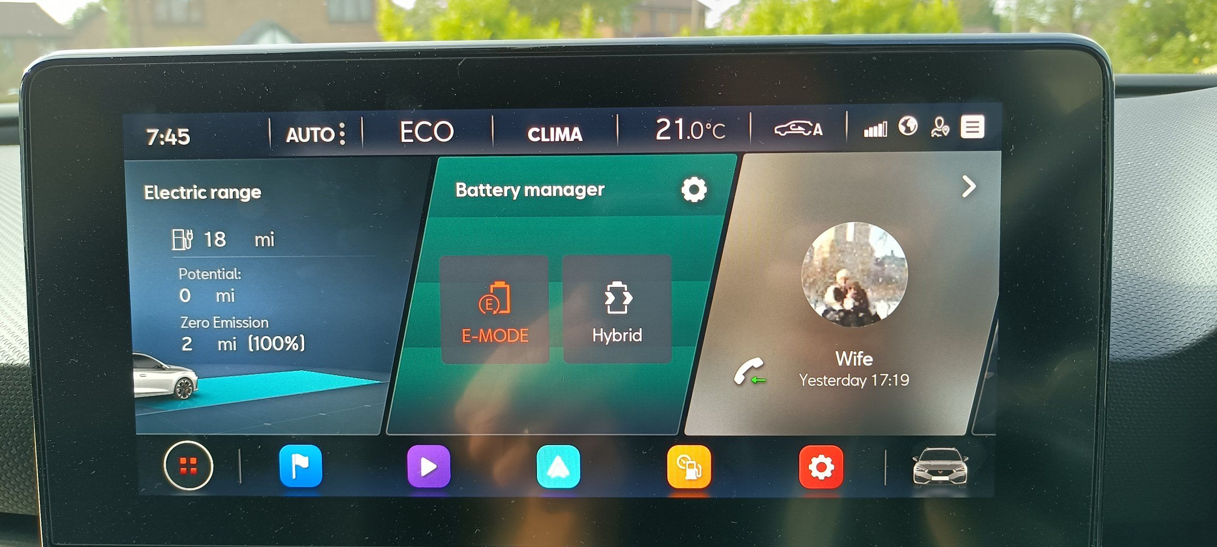

Best way is to put it as a shortcut / widget on the main infotainment screen. That way you always have the e and hybrid buttons visible.

Long press on the main tile you want to change, and choose battery (think it's battery, might be hybrid), then swipe it up/down until you get the e mode / hybrid buttons:
