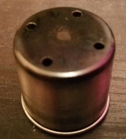

Mixed day today. Had my yearly cam follower. 7000 miles and the coating had started to wear. Oil pick up pipe done. Tick. Along with oil change (obviously) and oil filter.
