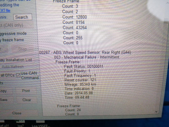

Decided to scan the car (cause that's what we do for fun right). Sat sobbing for a while at the number of errors (ABS, traction control, steering, engine management). Then noticed they all occurred with the exact same timestamp. Then remembered the look on @Maypack s face when his car came off the rolling road with 100 errors on the dash. Panic over me thinks... but you would have thought they'd delete the fault codes!?

Glad it's not just me. I think it's only a split second as when I look in the rear view, cars are disappearing in the distance. It's just really unpleasant for me and passengers who think I can't drive as they are thrown forward and back.
I've cleared the ABS faults and they haven't come back... I suspect they appeared on the dyno ... wonder if it's because the front wheels are doing 140mph and the rear wheels aren't moving that throws the fault!?
It will do that, the wheel sensors are designed to show wheels moving within a margin of other, I suspect 140mph and 0mph is outside of that margin! lol. If it was an ongoing fault you would get the ABS light as well I would think.
