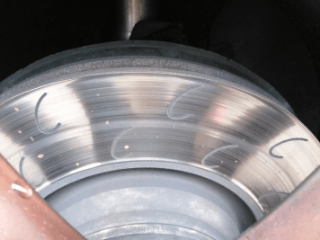

Garage noticed some scoring on my brake discs. So I contacted Vagbremtechnic who replied in under 5 minutes to let me know it's normal wear for these discs and gave me some tips on pads. Yay!

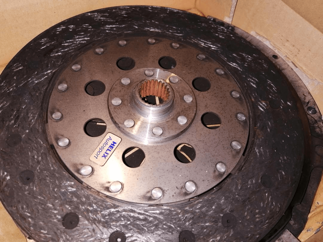

However... my cars currently in the garage.. Boooo... So my Helix clutch has completely worn out (slipping in all gears even with the slightest acceleration) at 15,000 miles (less than 18 months of use). Apparently as a parting present it's "destroyed" my DMF. Really unhappy at the mo.
So... when I get my car back it should have a new LUK DMF. TTRS Petrol pressure plate. TTRS Diesel clutch. It's supposed to be good for 430lbs of torque. Which'd be useful as I have 430lbs of torque. LOL. Supposedly a different pedal feel - I never got on with the Helix - too heavy and bite point too high. So want my car back, but lost a bit of confidence in it.

Shame about the helix clutch, I'm sort of glad the helix never worked out for me as the pedal was solid and just not great driveability. Have you gone with the RTS kit? As they use the TTRS pressure plate and a twin plate friction disc and mines been great so far
Yeah, if there was a hole I'd cry. LOL. Last one had done about 9k and the coating was starting to wear in the centre. I think of it as a yearly service item now.
TBH, I never got on with the Helix. I always found the pedal really heavy and the biting point really high. The new kit caught me out with the lighter pedal and the bite is practically on the floor. So first change out the garage is a massive clunk as it clamps down LOL.
Can't find the link at the moment. It's this weird setup where you buy a TTRS pressure plate, throw away the clutch and use a 240mm diesel plate in it's place. Apparently they are fitting it to a load of Golf MK7s and S3s at the moment and seeing good results with an OEM feel. I'm still nervous though.

Gotta wait a while before I can see if it'll hold the power. Which is annoying. Also didn't help the outgoing clutch decimated the flywheel. But no clatter at all now.

That almost looks like it’s got warm and cooked it’s self
Going on what I've read across the net, the general verdict seems to be that they overheat when driven in stop/start traffic a lot. So it's not really suitable for daily rush hour traffic. I've emailed the details across to Helix to ask if they'd like to chip in for the repairs. LOL.

Lol you may be lucky
Not sure if this counts as lucky. They are going to refurb it. Must be a fairly common thing as mine is going with 2 other Helix clutches next week for resurfacing.
