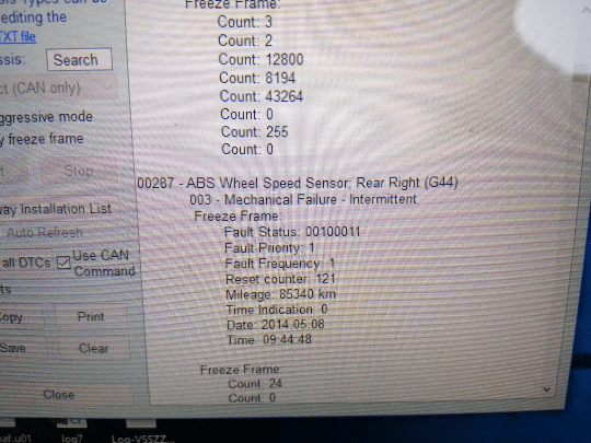

Do the abs sensors also work out if you have a flat/tyre pressure issue or is there an actual sensor in the wheels? (Kinda on topic . . )
If there was an actual sensor in the wheels (which some cars do have) when you get new tyres you'd see them making sure it was refitted. It just basically calculates when one wheel is moving at a vastly different speed to another. I thought it only went across the same axle. But as above, it must take all wheels into account for me to get errors on both rear wheels.

Decided to scan the car (cause that's what we do for fun right). Sat sobbing for a while at the number of errors (ABS, traction control, steering, engine management). Then noticed they all occurred with the exact same timestamp. Then remembered the look on @Maypack s face when his car came off the rolling road with 100 errors on the dash. Panic over me thinks... but you would have thought they'd delete the fault codes!?

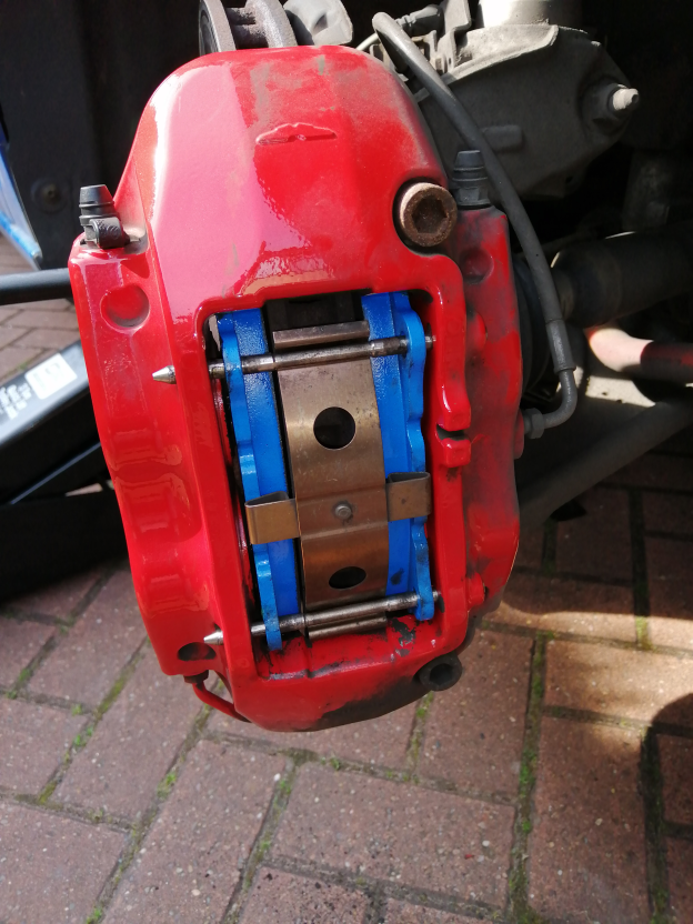

Who can guess what I'm doing for Easter bank holiday?

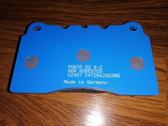

From the bedding in instructions:
"A sequence of 5 stops with medium to high pressure from 112 MPH to approximately 37 MPH with maximum acceleration between the stops."... so you see officer... :cop:

Have fun Jon don’t forget to clean and grease where your pads sit in the callipers and all the pins I find a wire tooth brush good for the callipers and a small wire wheel good for the pins and spring
Cheers... I've got the whole day tomorrow so am in no rush. Do you grease the spring retention pins on Brembo type calipers? I couldn't find a definite answer on the internet.

What pads have you currently got? I was looking at these but went for DS2500s so I'm curious to see how these perform. Took it to a track day now I have crazy loud squealing all the time :blink:
I've currently got the stock Pagids off the RS3. Which were pretty good for the first 5mm or so of wear. They are about 50% worn and lost their sharpness now. You tried taking them out and greasing em up?

Do they still perform quite well when it has the initial bite or has the overall effectiveness dropped?
That's on my list of things to do, but I can't safely get the car in the air at home. I'll see if I can think of any bright ideas
From new they nearly put the mot tester through the windscreen. They are sitting at about 60% material remaining. And it's like having two lettuces trying to slow a block of ice.
I do as they go through the pads and the pads move on them and it also stops them from seizing in the calipers you don’t need lots on just a fine covering also put a small amount on the holes in the pads where the pins go through the pads same again just a small blob
I use a small amount off copper grease on the caliper sliders and edge off pads that sit on he sliders and the spring clip that sits on the top off the pads and a bit off multi purpose on the pins and on the spring clip where the pins sit
Have fun Jon and remember your pads should just drop straight into place inside the the caliper and you should have to hold them in place to get the pins in if not you have not cleaned your sliders up well enough or pushed the pistons all the way back
Haha, I didn't understand this bit till I pushed the first new pad in and it fell out the other side :roflmao:.
Consider them well and truly bedded in!

Haha, I wish. It's draining money in other ways at the moment. Finally got PS4S all round now and Pagid RS4-2 pads on the front. Need to get some $$$ ready cause cambelt/waterpump is coming up and I'm thinking of doing chain, tensioner and maybe balance shaft delete at the same time.
