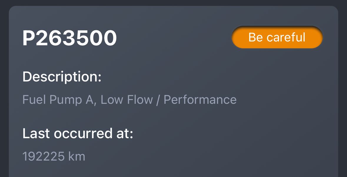

Started car and got it loaded up with Gear and Kids to head off to parents yesterday, while I locking the roof box, the engine just died! Jumped in and turned the key and started for 30 seconds then died again!
plugged in Carly and got the code above!
2015 Alhambra 192,225 kilometres on the clock!
I’m thinking of changing the fuel filter, fuel pump and running a cleaner thru the fuel system!
any other suggestions to clear the issue?
problem has come on very suddenly (no warnings previously) now won’t run for more than 30 seconds without dieing
am I missing a trick here? Is there a recommended fuel pump that I should go with? What’s your experience of changing them like in the Alhambra? I can only assume the access for the pump is under the rear seats somewhere?

Car was sort of fixed. Fuel control module was kaput, had that replaced and a week later the fuel pump started making a whining noise.
So its getting a new pump this weekend. That should also fix the fuel pressure issue thats shown up over the last few days, and the slight loss of power under acceleration. (tho that could be my imagination as I am normally driving a car with more than double the power, so could just feel slow in comparison)
