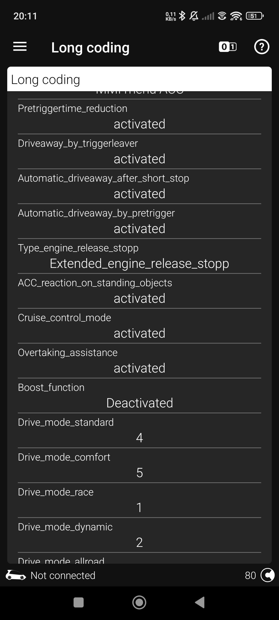

@RyanB Yes. I have. I have to look for it because it was very easy to code.
Edit.
13 ACC, long coding, Cruise Control mode to activate

That's great cheers! I'm assuming that's on OBDeleven?
Yes. I use obd11 for Leon. I don't remember exactly, but in ACC module 13 you must first enter Security Access and enter the code that will be displayed because ACC does not accept everything without a login. I think so because when I encoded the hitch trailer, it rejected the encoding.

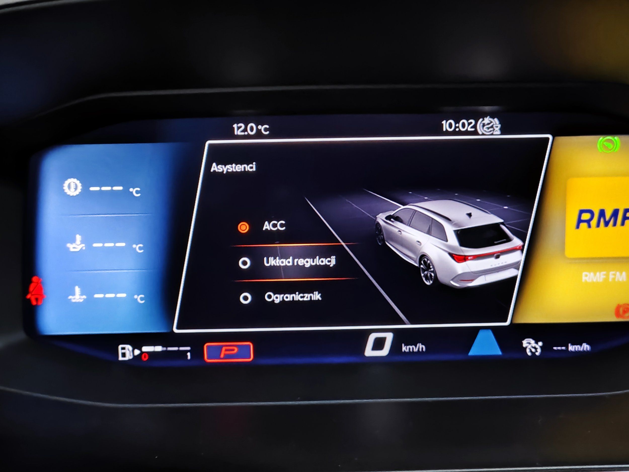

Sorry am I misunderstanding ,you can turn off acc on the steering wheel and it acts like normal cruise control
Sent from my Pixel 6 Pro using Tapatalk
I could be being an idiot but it seems to just work as ACC or nothing when I use the steering wheel buttons. There's the travel assist button and ACC button

No, but can be made to do so if you get it recoded to do so as a third option to ACC and Speed Limiter.

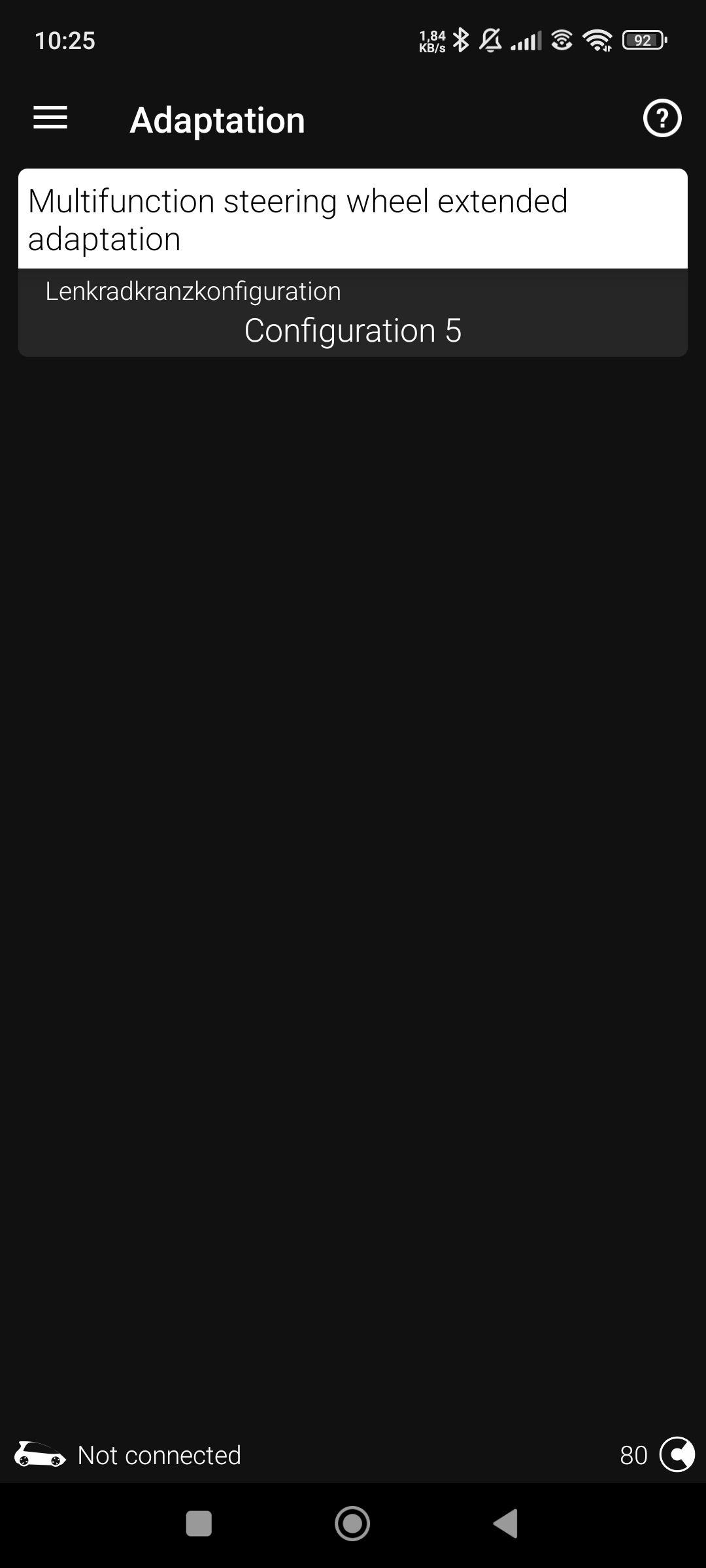

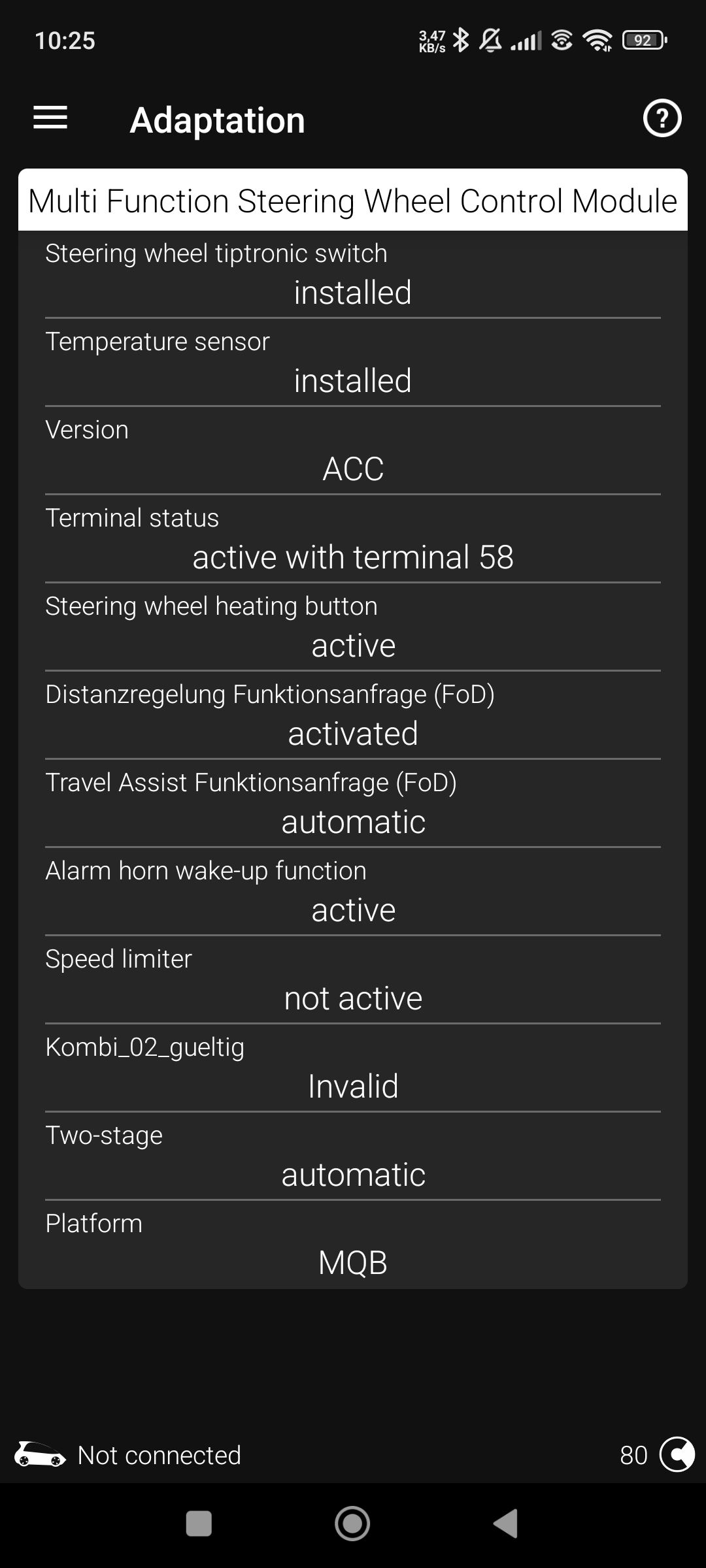

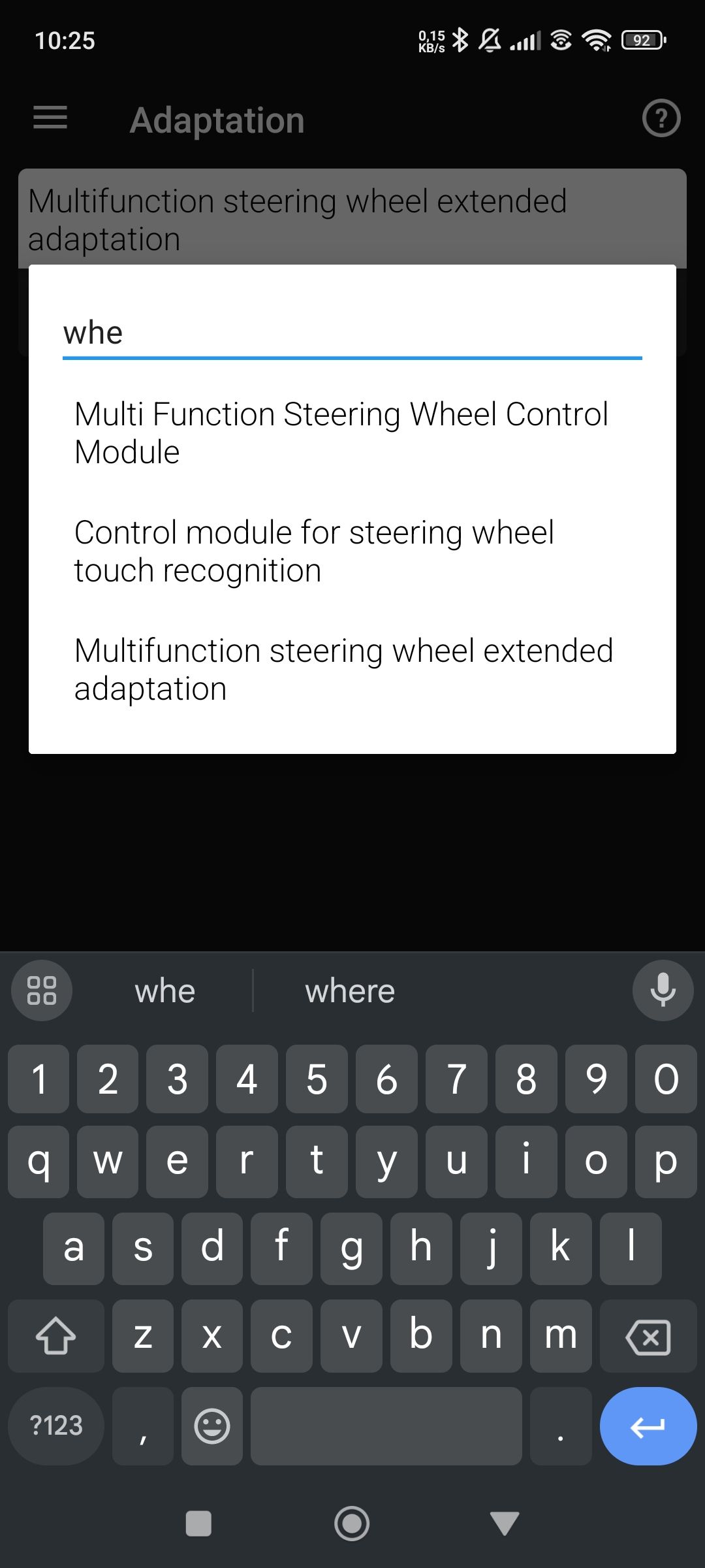

@RyanB Could you take a screenshot of the steering wheel settings? no need to go to the car. Turn on OBD11 and on the left go to garage/your car/Control units/gateway/adaptations/ and search for wheel. there, take a screenshot of these three things. I'm waiting for my capacitive steering wheel to arrive. but I was digging around here some time ago and I don't know if I changed something. I want to have travel assist. Thanks.

Hello,
Is is possible that the normal cruise controle is selected by default when the car start? Now i must select it everytime, because adaptive cruise is selected by default.

Bump, however I’d like to use the speed limiter as my default rather than cruise control. Thanks
