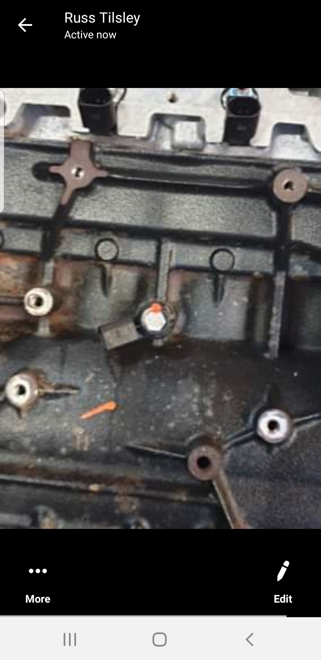

Pictures here the only tricky bit is the cave super charger has different mounting points

Hi, mine is still running on the cave map I didnt get any ecu with the cave engine so I just flashes the cave map onto the cthe engine everything worked fine i wouldnt reccomend a CAVE, one bonus with the CTHE they upgraded the pistons in the cthe to stop the cylinder 1 issues

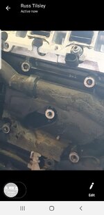

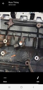

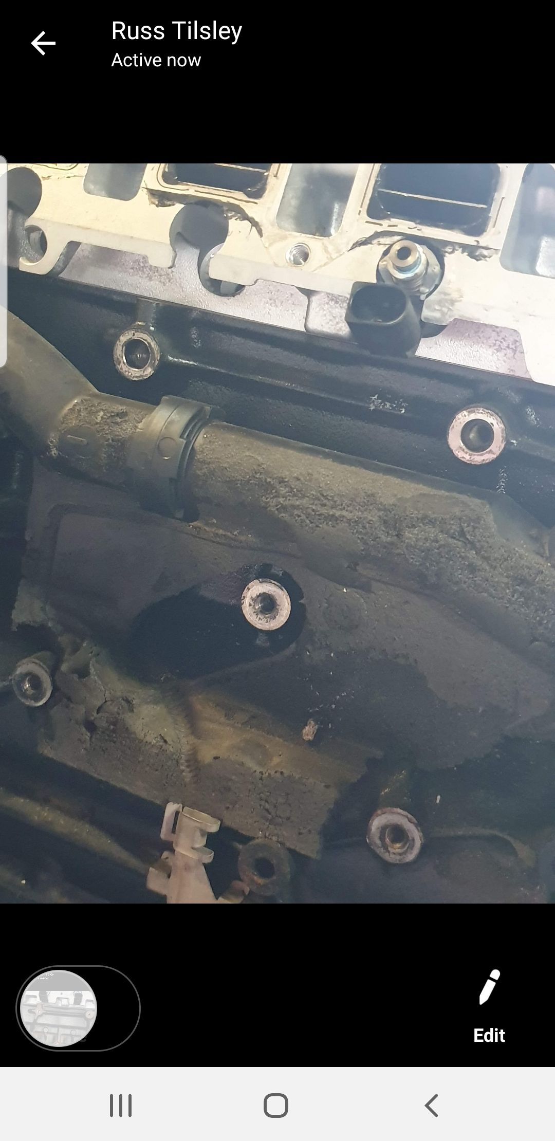

Its just an extra bolt on the first pic is the CTHE bolt on and second is Cave if you can do some adjusting its not too bad also, i would still probably try find a ECU from a CTHE but it runs on the old map, isnt the best on fuel at times so probably going to get it mapped to see if it can run better and a bit more efficient
