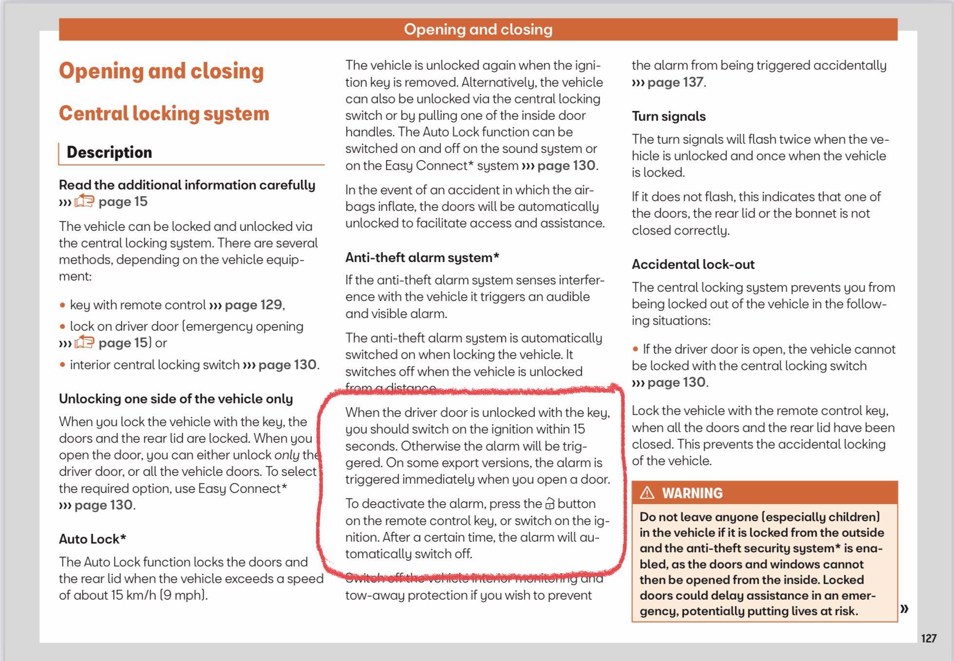

A couple of ways you should be able to check to see if your alarm is working;
  • If you unlock the car by inserting the key into the keyhole in the driver’s door handle and then open the door, the alarm should sound if you don’t insert the key into the ignition within 15 seconds.

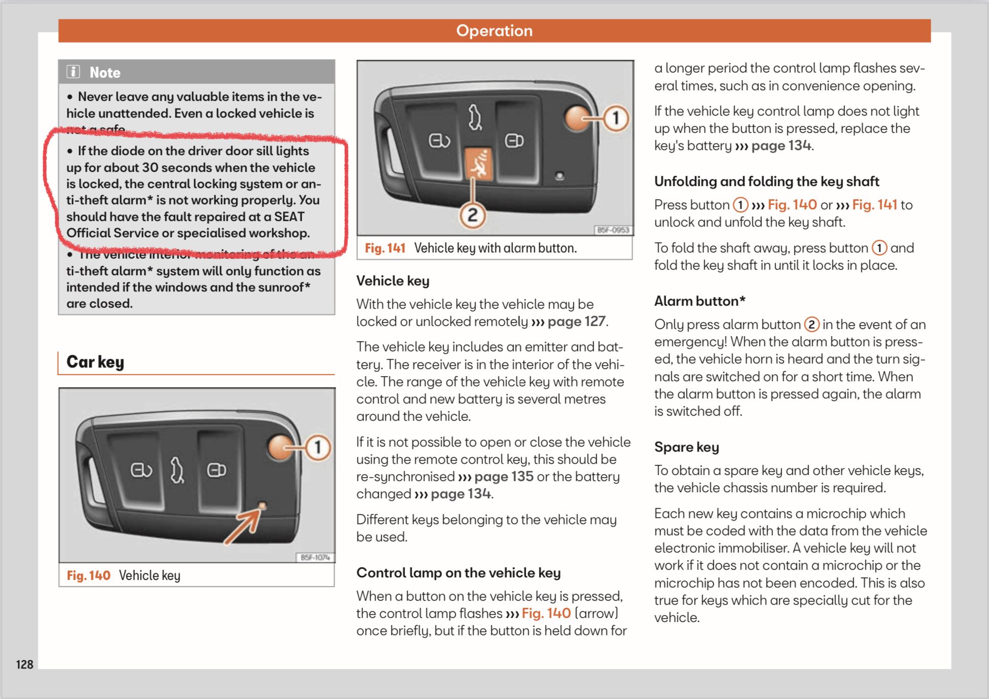

  • if the LED on the driver’s door stays permanently lit for 30 seconds when you lock the car, that’s an indication there might be a fault with the alarm system.
Check out pages 127 and 128 in the owners manual;

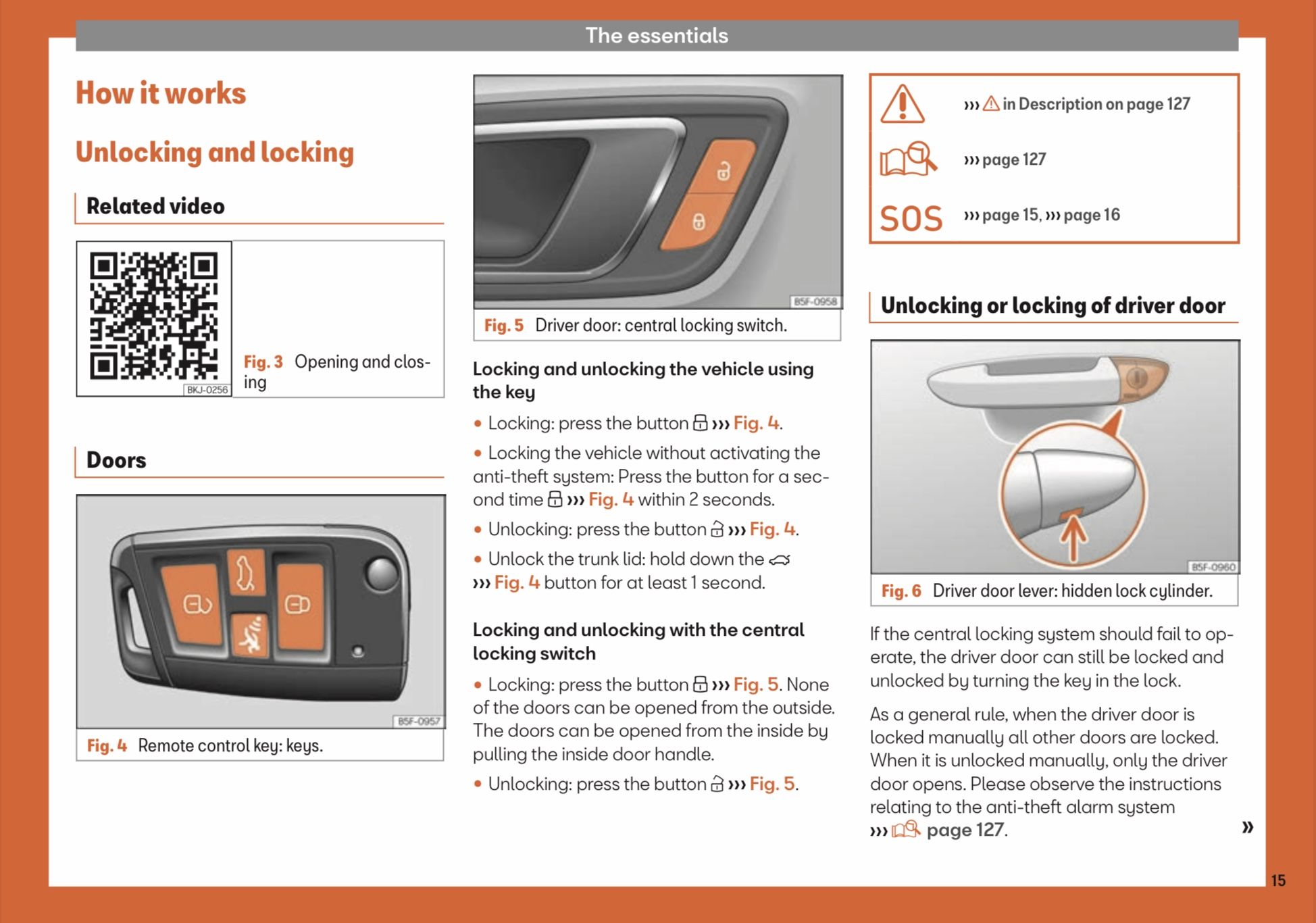

Page 15 on the manual shows where the location of the keyhole in the driver’s door handle to manually unlock the door. You need to carefully remove the cover - there should be a cut out in the bottom edge of the cover (arrowed in the picture below) that you can insert the key blade into to prise off the cover. Be careful not to damage the paintwork!
