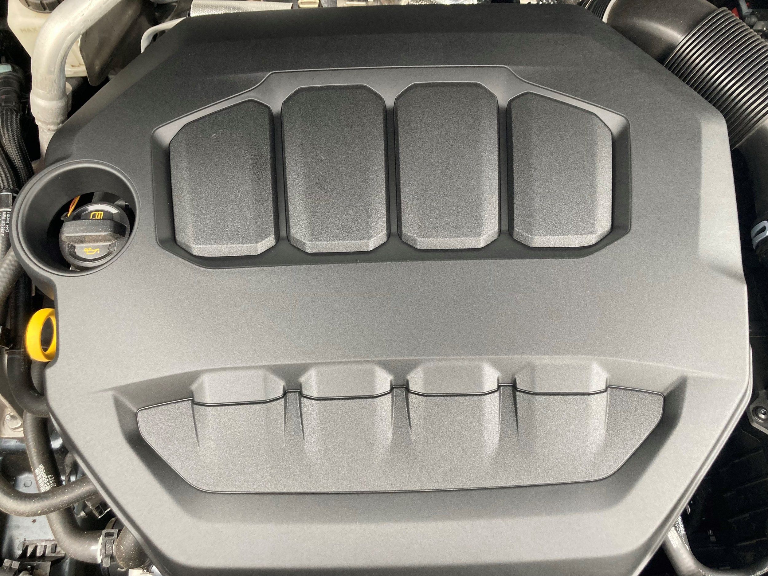

In other news the dealership fitted its first new fireproof engine cover, which gives the engine bay some new found modesty.
