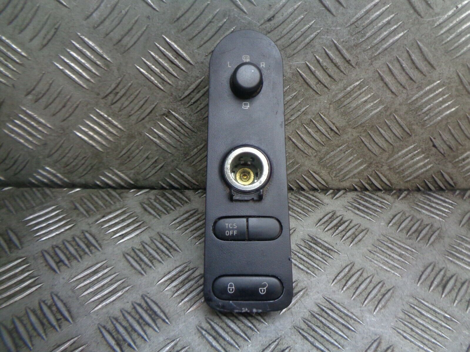

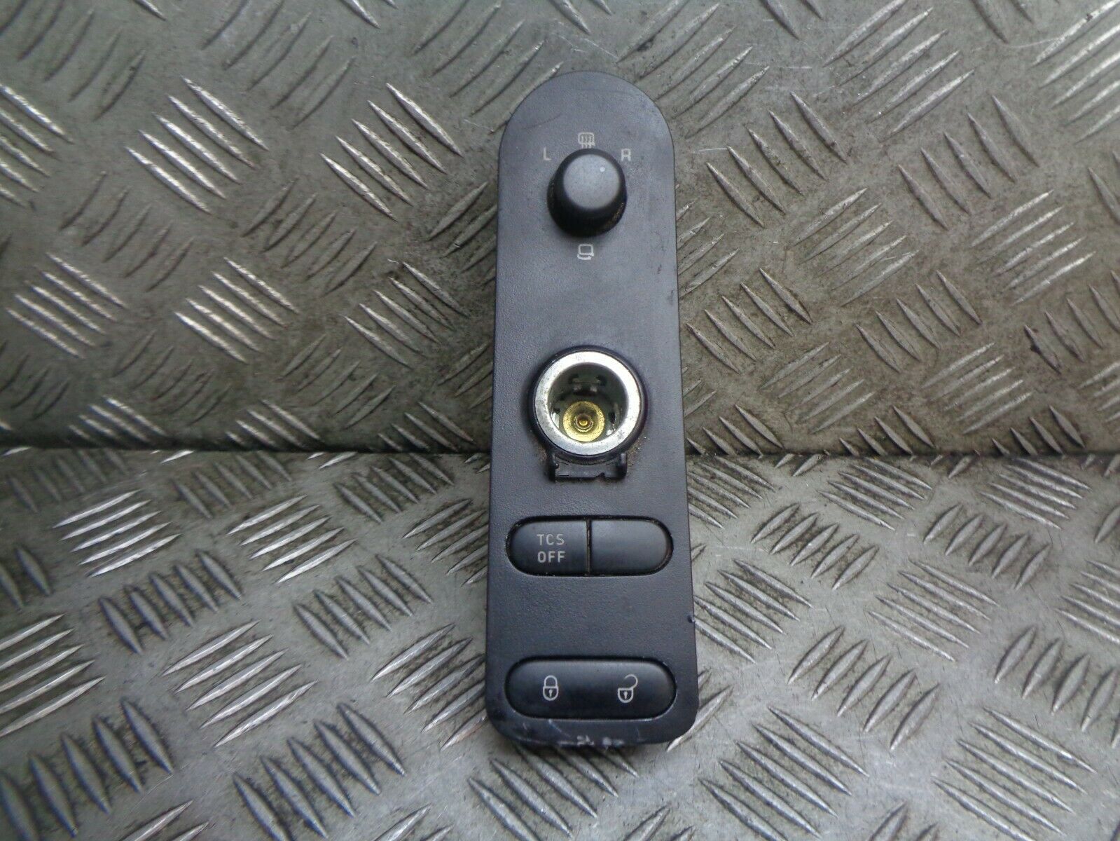

Hi can you google the photo of a Leon cupra mk2 centre console switch to see if it’s the same shape as yours please? I have a spare working one. Are you local to Basingstoke?
@300bhpdaily I have had a look and think they look the same. Photo from eBay, but mine looks like ;
I am Salisbury, so not far...
Yea that looks the same part. Pop over this weekend if your free and I’ll grab the panel out of my car and you can have it save you having to buy one I’m not using mine anyway and it’s fully working. If yours doesn’t work after that it’ll be something abit more serious but hopefully it’s just that.

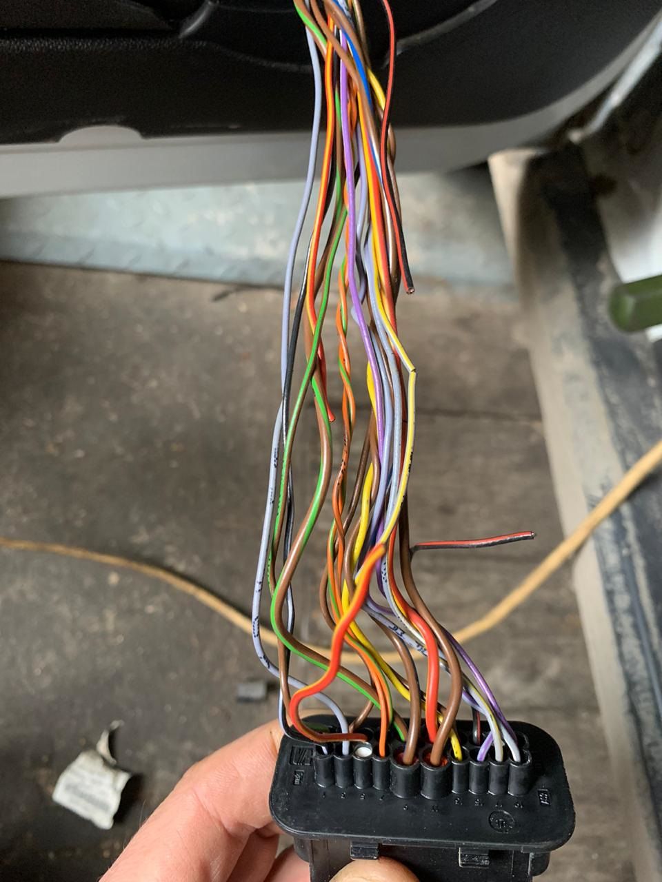

If your central locking system is not working properly from the control panel that is fitted between drivers and passenger seats, buttons are dimmed and mirror adjustment doesn’t work as well, then the issue is caused by the broken wires in the driver door which are leading to the control unit. Should look like that as shown on the picture.
