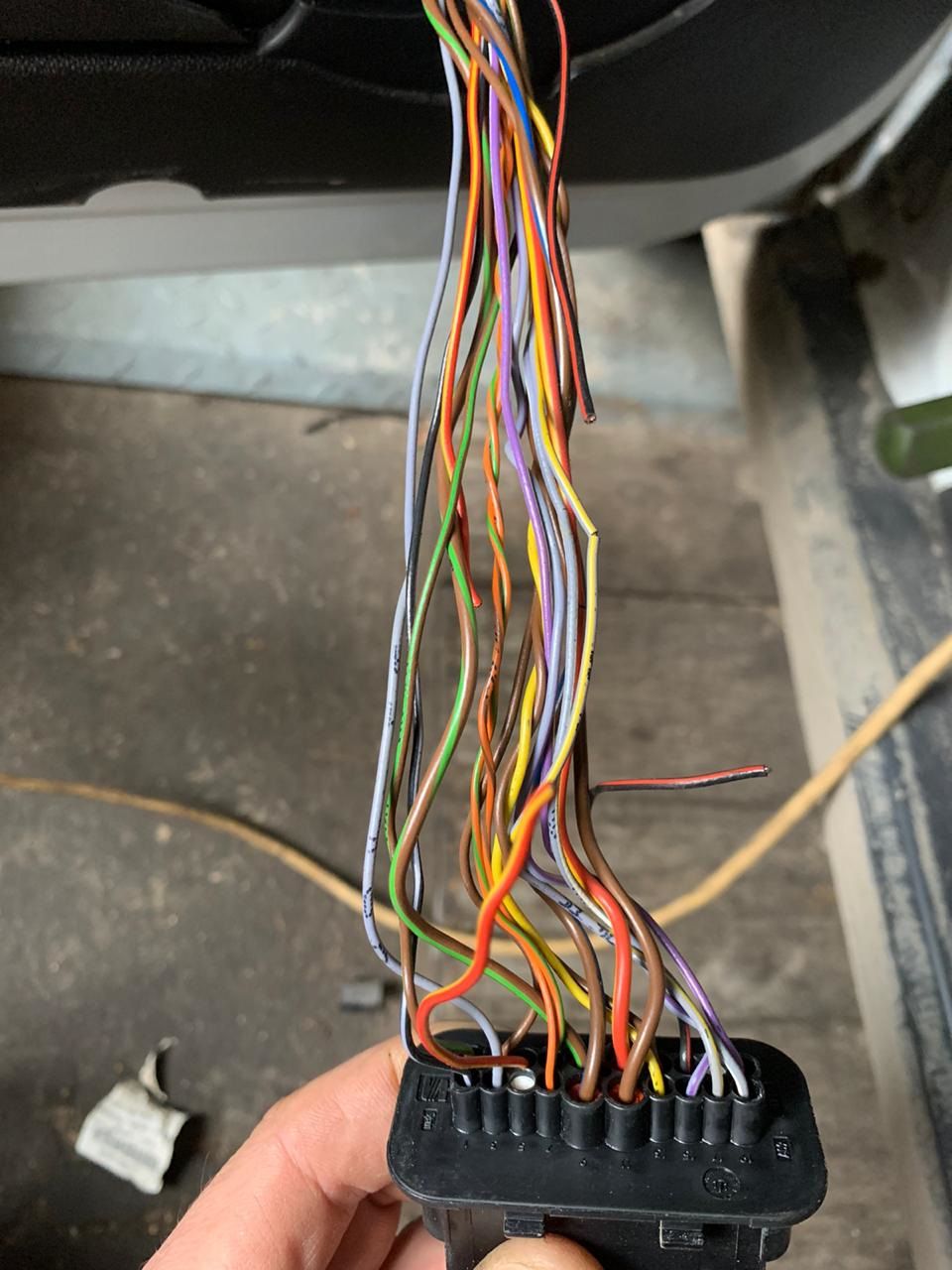

If your central locking system is not working properly from the control panel that is fitted between drivers and passenger seats, buttons are dimmed and mirror adjustment doesn’t work as well, then the issue is caused by the broken wires in the driver door which are leading to the control unit. Should look like that as shown on the picture. View attachment 33428
I see so I can pull that off from hinge and through to speaker hole, thankyou that's what I needed to know I wasn't sure if pulling the part in your hand out from hinge would be a problem .I'll try again now

You were right...in the loom of the hinge wires there now resolved so mirrors and central locking buttons all working, thankyou
I have exactly the same issue and just wanted to check that the driver door where these broken wires would by on the right of a RHD UK car in the drivers door as your image seems to suggest that the issue is to be found in the left hand door.
What’s the easiest way to access this loom?

I cut the rubber housing and removed it, in the door hinge whilst door is wide open,to expose all the wires then after getting the wires opened out,you will see the break.

If you take the door speaker out you can pull the loom through and repair the breaks in the wires outside the speaker aperture. There are two clips on the car body that you need to pull out to release the multi plug
