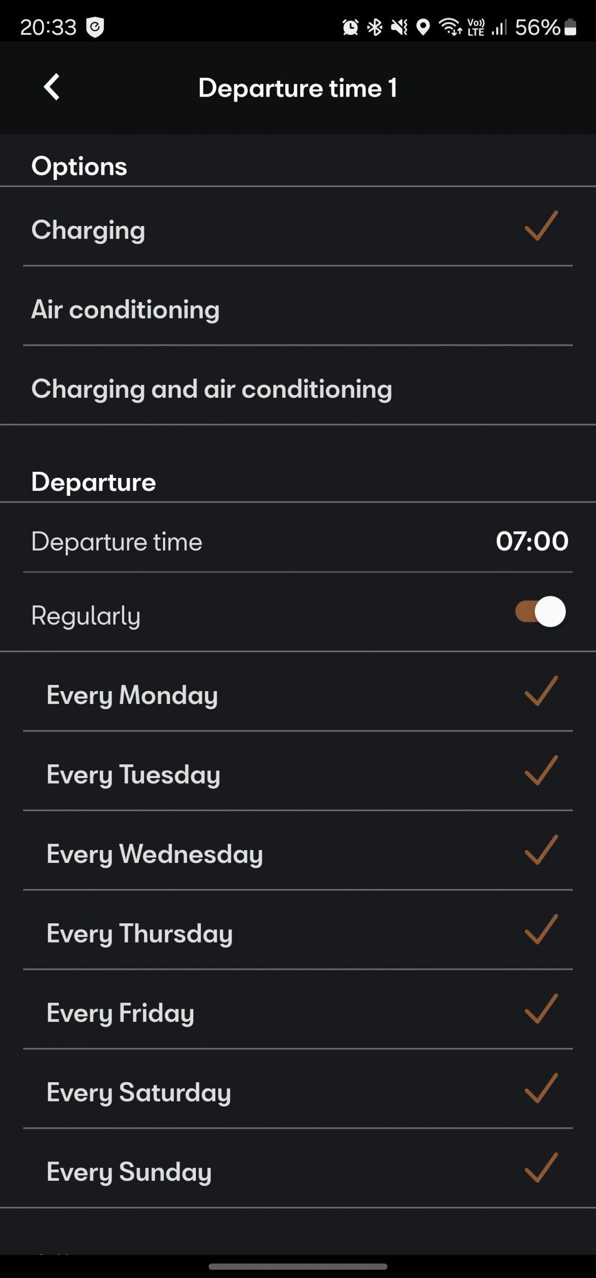

I have Charging selected, nothing else as not required (screen shot from app attached)
Forgot too add I have done a factory reset on car display also as I thought maybe someone or thing maybe bugged it out
All looks ok. Assume Off Peak charging is selected further down?
Has the app successfully synced with the car? I.e. do the departure times show the same on the infotainment.
If all looks right maybe try disabling and renabling on the infotainment to see if its a software issue?

I have been down to the car and all set correctly, yes off peak selected.
Green LED was flashing when I left the car which hasn't happened before ? I'll see if the car charges tonight as at 80% I'll update in a few days. Thanks ?
No worries. Hopefully that's sorted it then as that's a good sign!
Haven't used mine for a while now, as I just let the charger manage it. Worked flawlessly for a year on the car software and the granny charger though. Hopefully it will do the same for you, however you are opting to charge it.
Just an update, all is working ? seems when I did my factory set and set the clock to auto time zone it picked 12hrs ahead lol I never noticed as abuse andriod auto. We are all good and thanks for the help. 81p for a full charge over night
