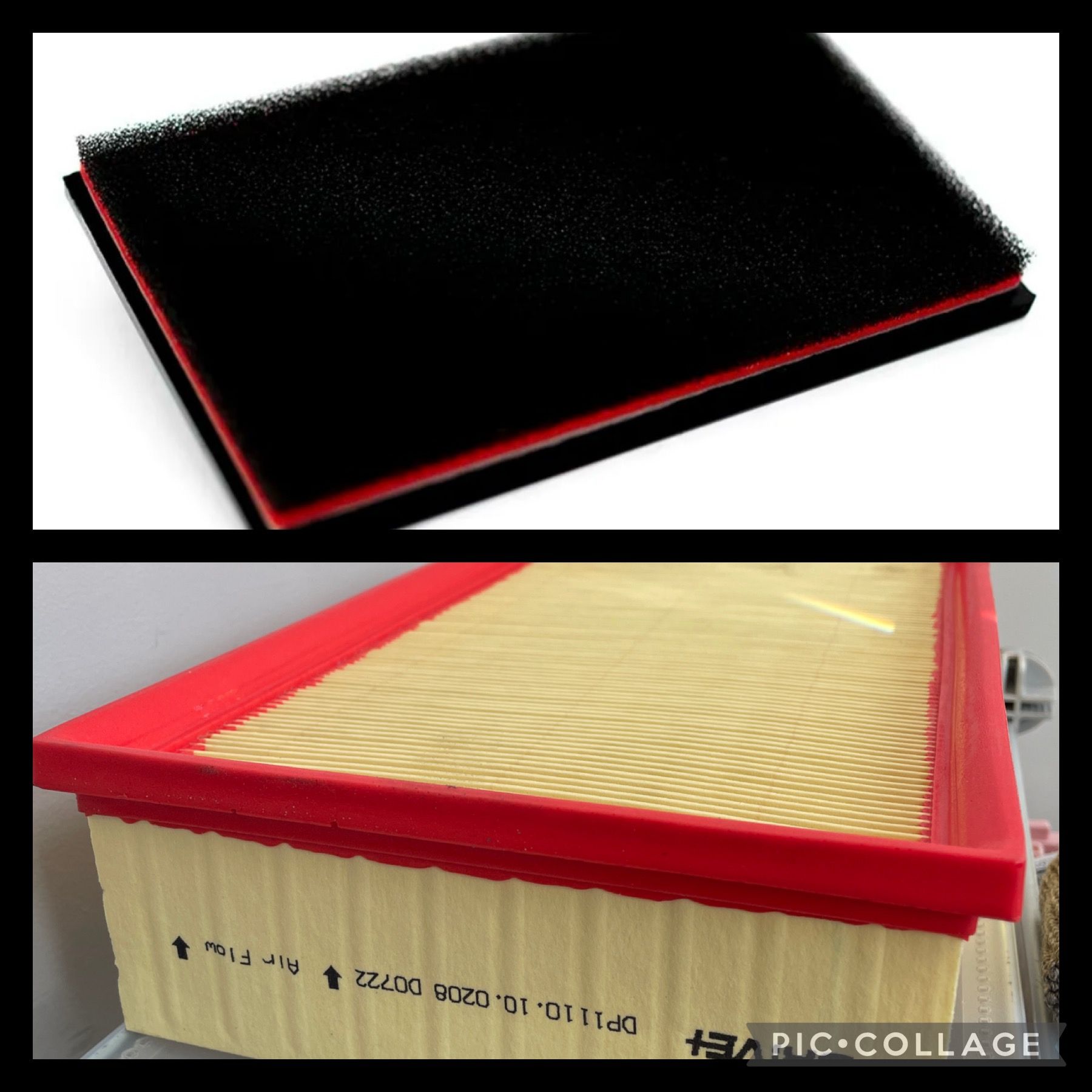

Thread revival,
Just fitted a pipercross panel filter to my 2L tsi and its about half the thickness of a usual paper filter so the airbox is now half full.
Is this how its supposed to be and how is this emptyness of any benefit?

Here is the difference, sound wise it hasn't changed much either.
