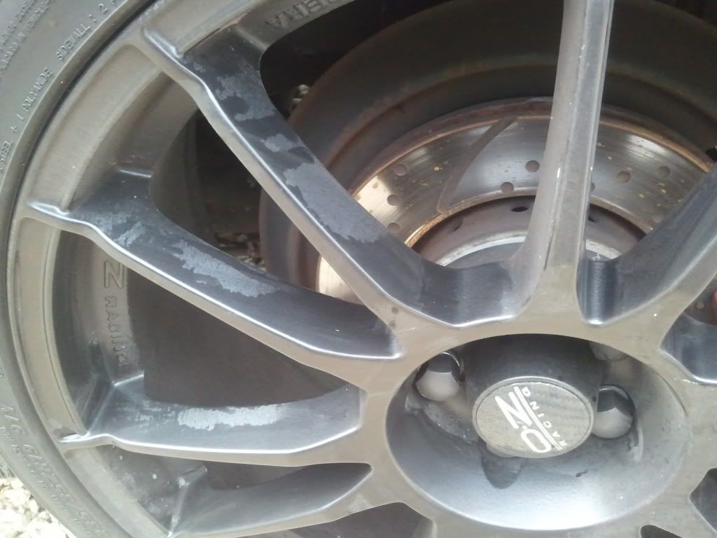

Also you can see got the wheels painted (powder coated)...but something went wrong with the paint as they are not meant to be this dark and some weird reaction to something.
The company is re-doing them as I type..have opted for anthracite so hopefully will look ok.

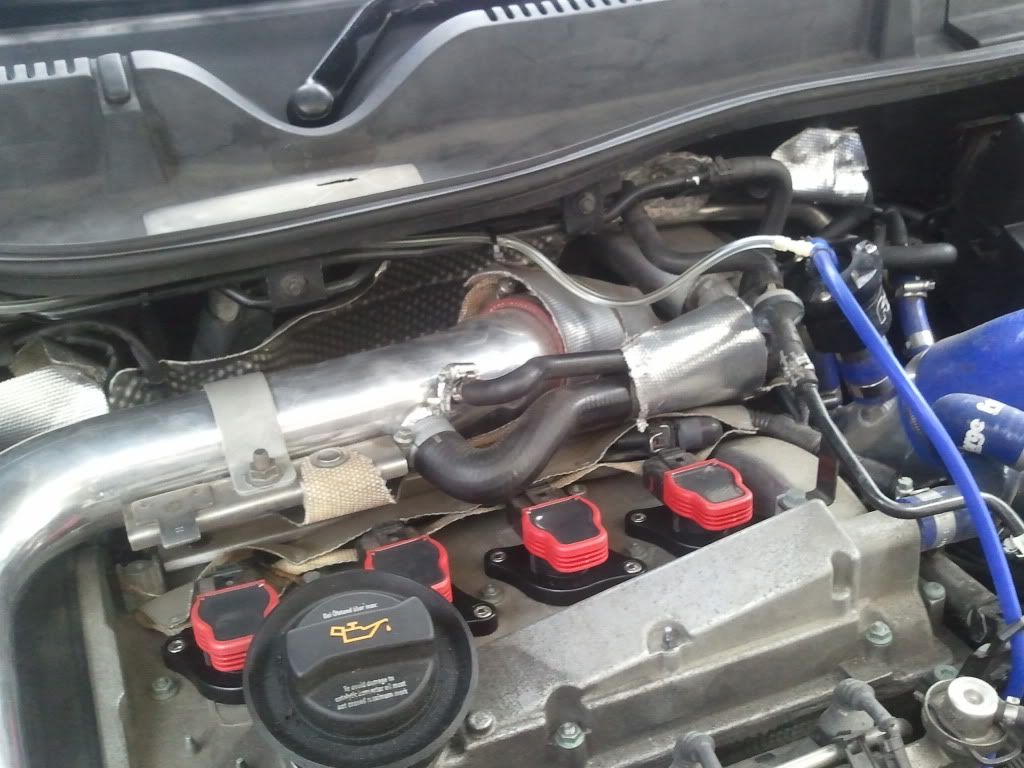

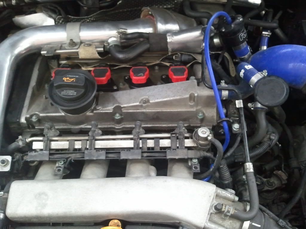

More recently i did the full n249 delete with appropriate resistor...and did the 2.0tfsi coil pack mod. Definitely sounds smoother on start up and idle. With direct hose from DV to mani it definitely holds boost better and no fault codes:)

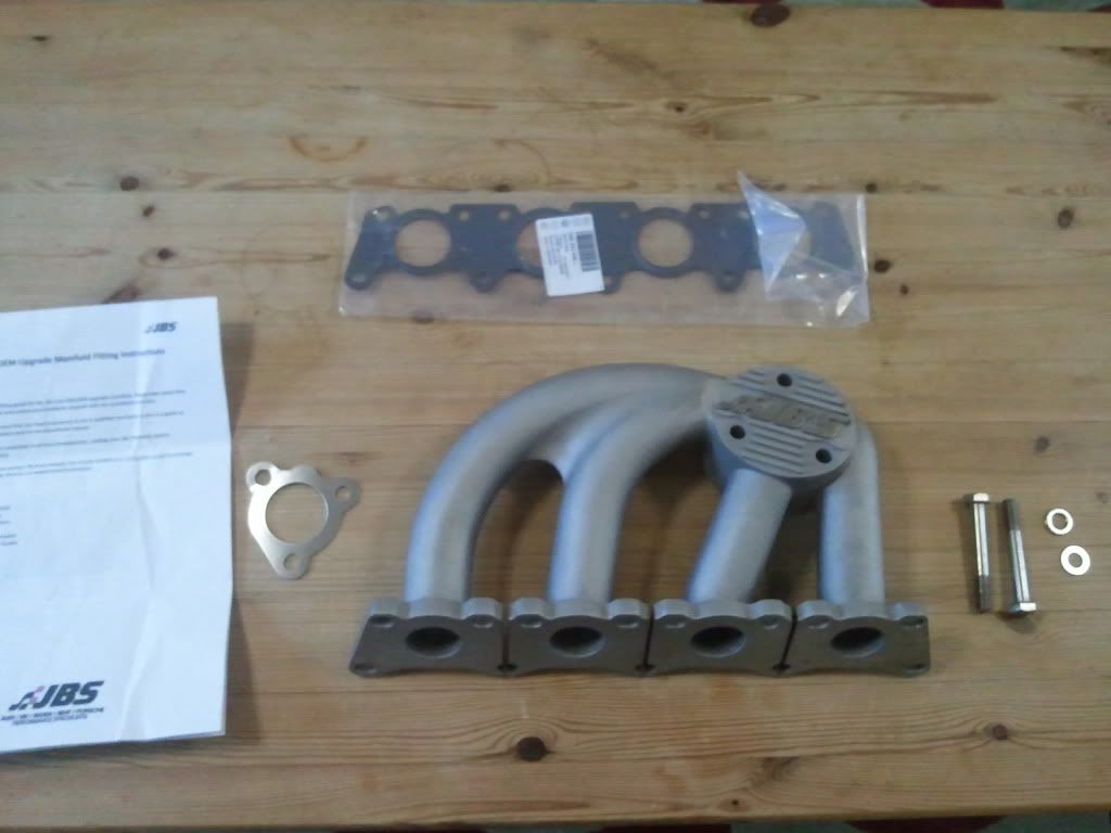

Have ordered the con rod package from INA and gone for riffle drilled rods, and received this today...
What's missing from this picture:confused:

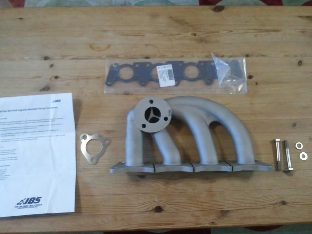

Can't find anyone with this mani fitted, so thought I'd give it a go, quality looks good and the gains to be had look impressive - see JBS website for graphs etc.

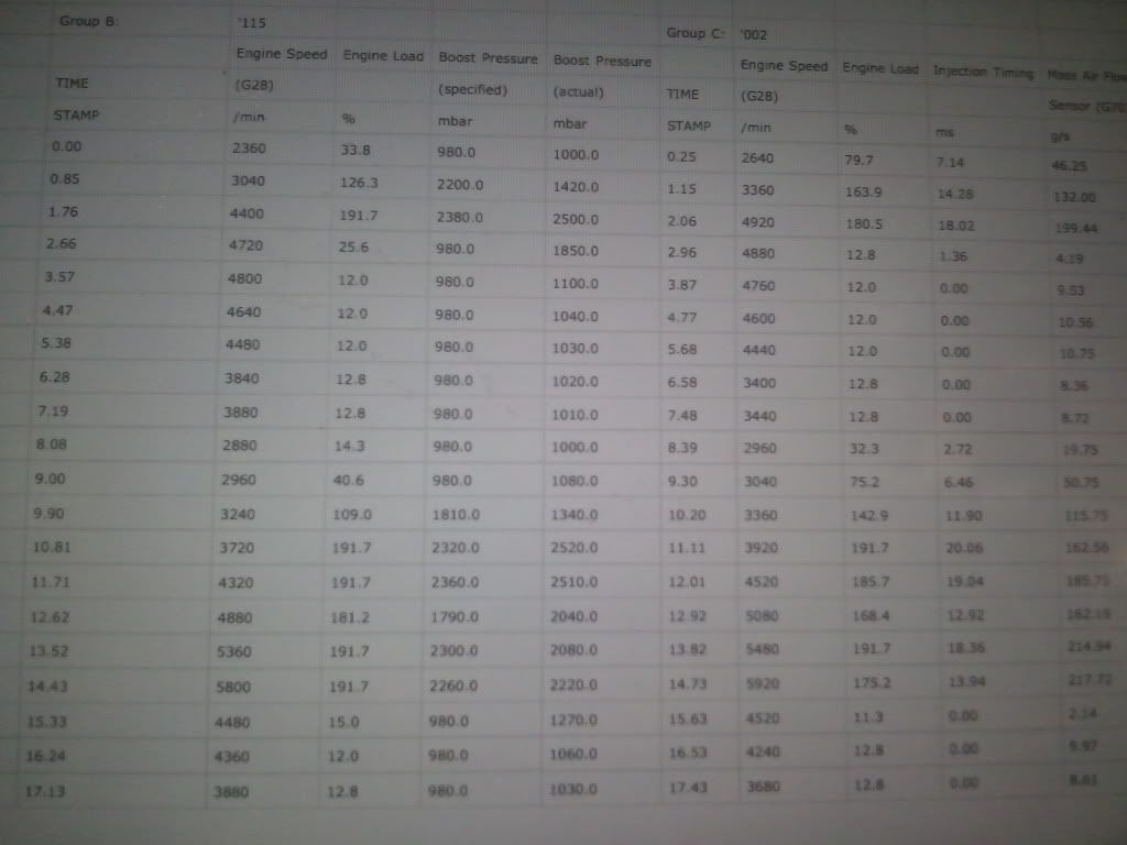

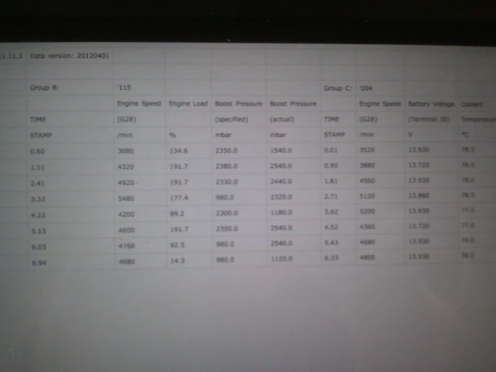

Did some logs yesterday as was worried something was up, but seems ok?? (sorry about pics, couldn't get them copied on iPad).
Intake temps were average 30..not sure if this to high.
One final pic I like (France 4 days ago):D
Opinions appreciated

Right PITA to fit, but here's the feed to the DV
