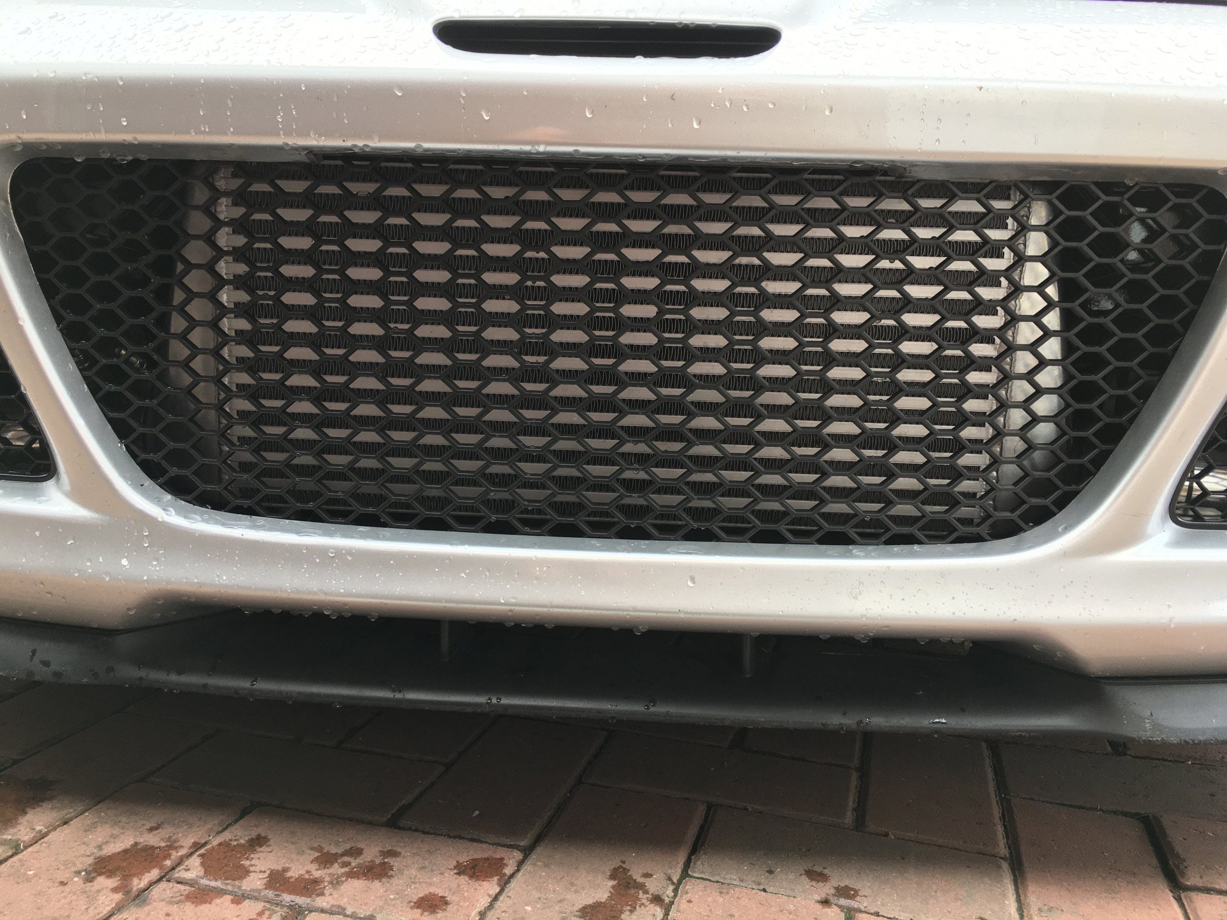

Fitted new badger5 oversize tip today, dam its massive compared to the one i had previously fitted. Widemouthed the bumper as well, and de-catted, will be putting a new turbo on next and hopefully see if my local remap guy can find a few more horses.

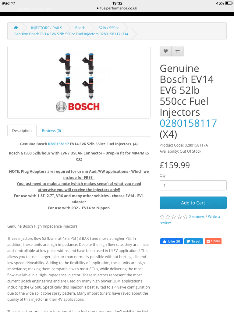

Next mods will be new turbo, hybrid, and injectors, struggling to find Bosch 550cc. Does anyone know if these would fit the 1.8t Bam ??? Or any places I can get them from.
Cheers all.
Cheers all.
Bill @badger5 used to supply them. Give them a call.
