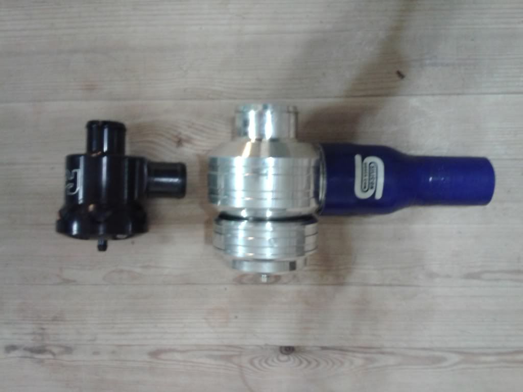

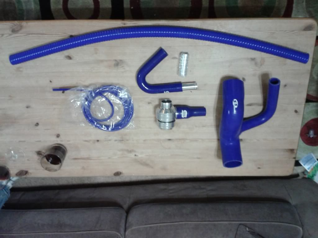

New DV and piping ready to DIY cold side relocation...not all the bits but you get the idea:D
Had to take this for comparison:p

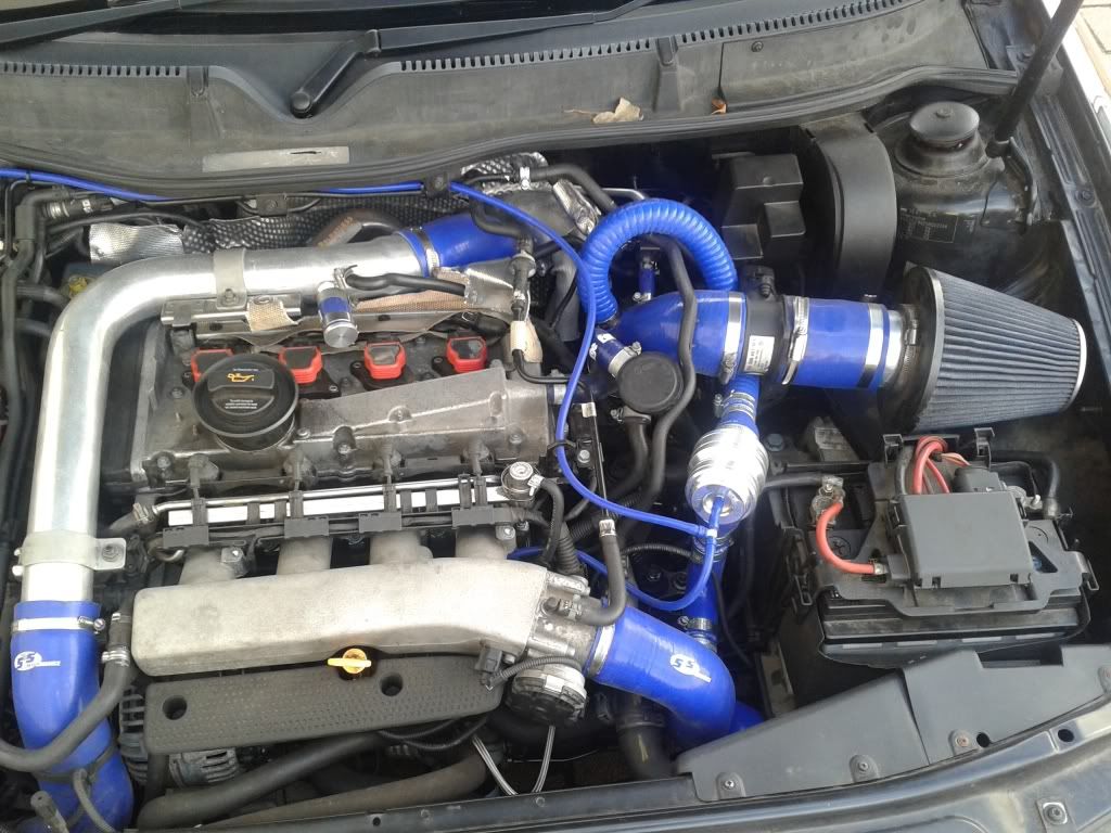

Quick update. DIY DV relocation done. Shame that supersize DV is so hidden. Function over form eh!

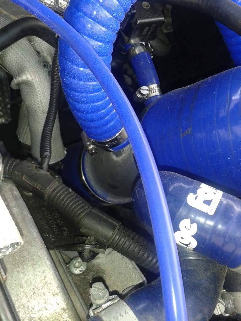

I bought some flex silicone hose (seen in previous pic) that I didn't actually need to use. I cut the intercooler relocation hose to get a 90 degree angle which you can see connects to hose coming off the TIP.
It's only boosting 15psi but still very rapid...more tweaking & proper logs needed I think.

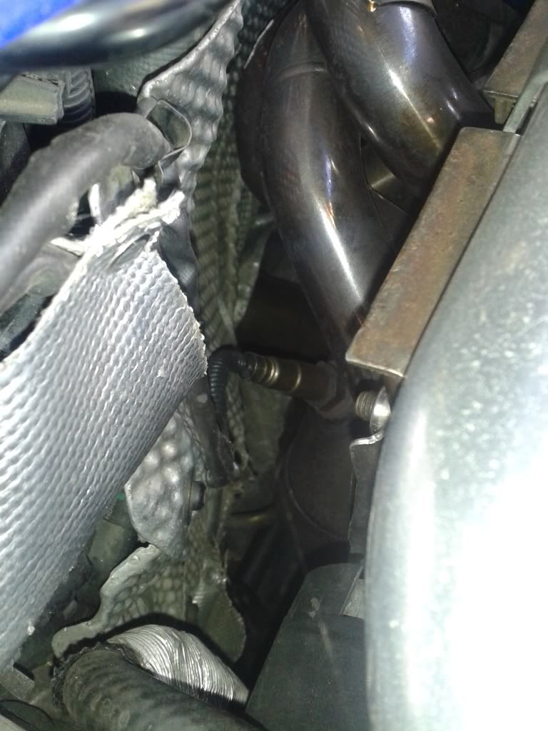

Lambda

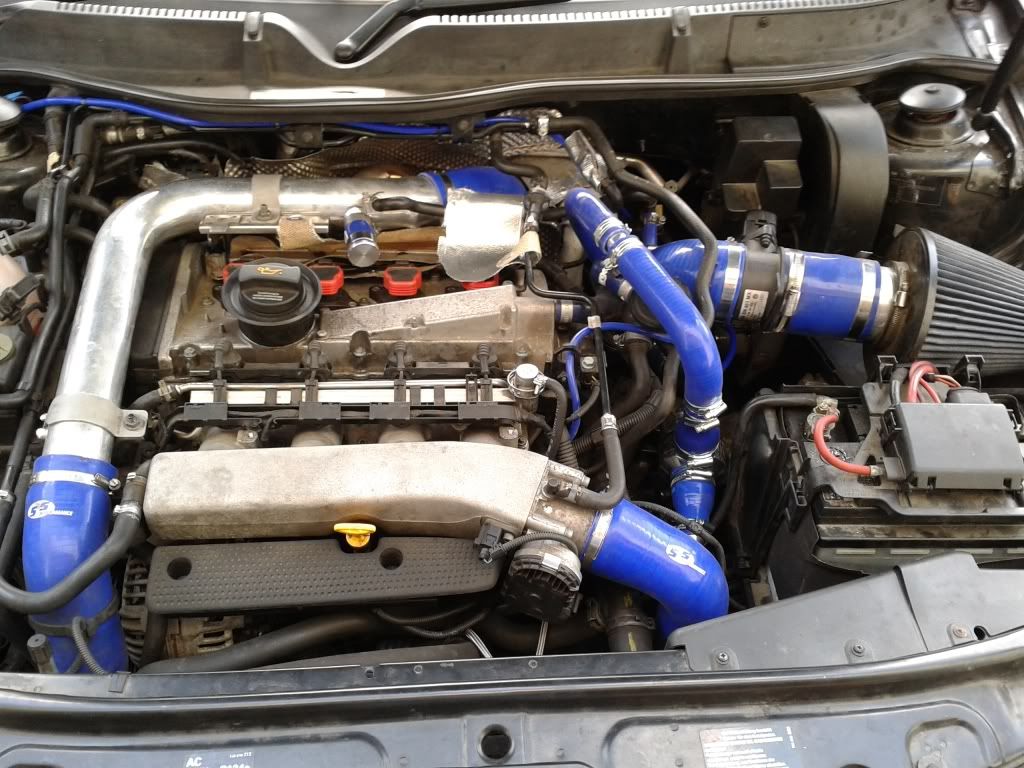

Up to date bay pic

Lambda
Up to date bay pic

Thanks for the pics Chris! The weather was really awful here in the past few days, but when it gets better I'll try to take some pictures of my engine bay.
My engine layout is basically the same, the only difference is that the LHD has its brake master cylinder on the left side of the car. Which makes really hard to install a big bore TIP... :rolleyes:
The JBS manifold I bought from you has the same layout as my OEM manifold, except its size: the JBS one is much bigger, the tubes running to the collector are really thick compared to the original one, that's why I couldn't manage to fit the lambda sensor to its original position. I assume the other reason is the bigger, 3" Milltek downpipe, simply not enought space left for the sensor. As a solution my mechanic drilled a hole 2-3 inches further away from the original lambda boss and welded a new one in. Unfortunately I had to put a nut in the first hole to cover it, not the best for looks. :( By the way it cured all my problems, no rough idle, no CEL, car runs happily.
