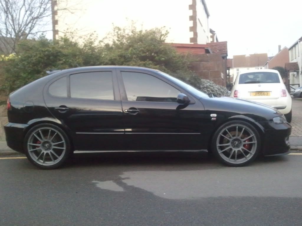

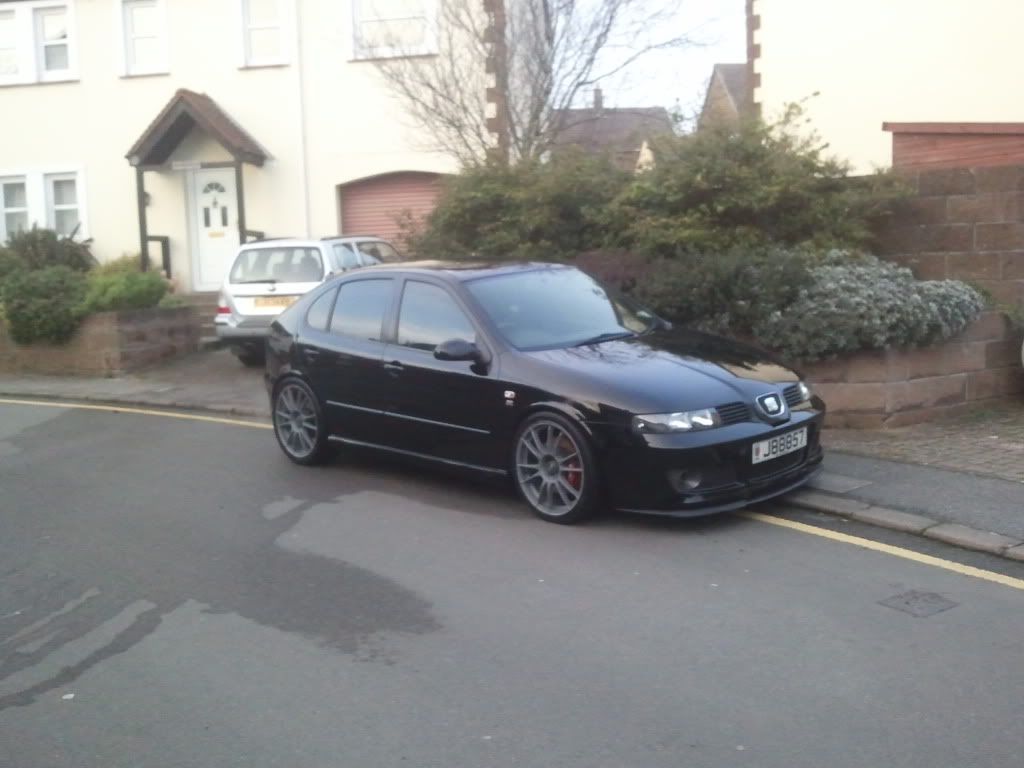

Not sure on the wheels, I do like the xxr 527 & the large 356 discs / 8 pots should fit...but then I gave the car a good clean today & might save myself some dough & stick with the ultras. Few pics
You're spot on with the diff. They're a top bit of kit that for some strang reason gets over looked. As far as the R32 goes it was lucky you didn't buy one. Unless you spend big cash on them they're a little under whelming. Not as hardcore as your car will be.
