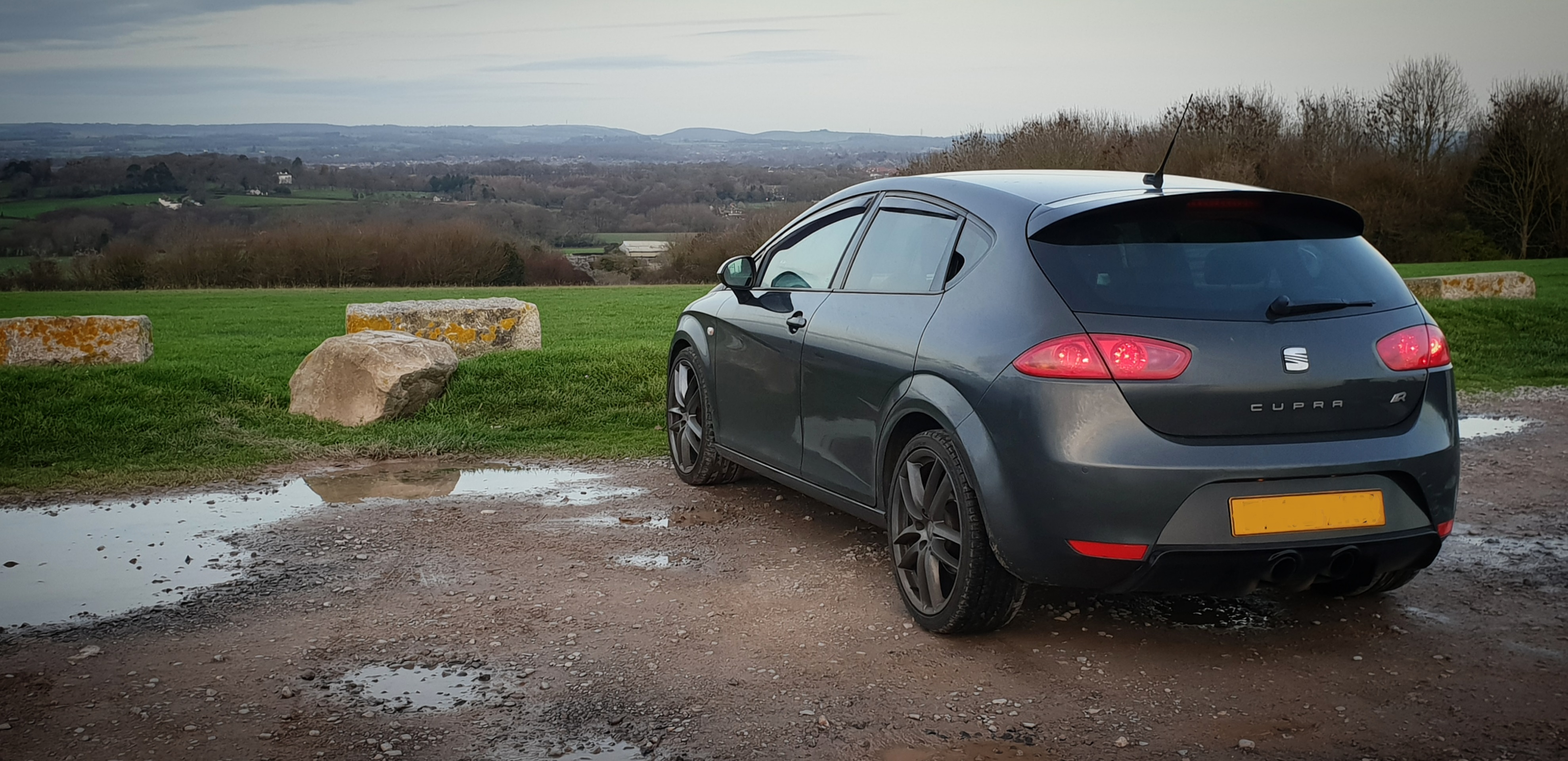

Bought this lovely 61 plate Cupra R back in August, had a budget of 10K, so it was quite a challenge to find one in a colour I liked, avg mileage, reasonable condition and not too far away - I've achieved most of that list. It had 85K miles when I got it, a bit high for my liking but it was acceptable, love this colour besides blue, was 60 miles away from me, in good condition and within my budget. This car is a sort of an affordable dream car for me, I previously had the Cupra of the same mark but 2007 reg and a Cupra R was always the goal, so now that I have one, time to enjoy it.
It came with the Heko wind deflectors and that's it in terms of mods. I've since then added the genuine armrest, REVO intake as I already had it on the previous Cupra and a genuine plastic battery box to smarten things up. I am hoping in the new year to invest in some Bilstein B14 coilovers amongst other things through out the next year such as a remap, refurb the wheels with a possible colour change to metallic black, would like paint the calipers yellow to achieve a nice contrast between body/wheel colour, new exhaust system as I believe a previous owner has backed in to a kerb and pushed the system back in to the car, middle silencer is obviously the weak spot and there's a crease down it, also means the tips are not quite central and sit quite far in from the rear diffuser. Other than that, I am one very happy owner!

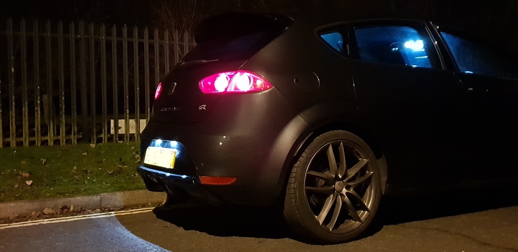

Firstly bought white LED's for the number plate (Error free, but still chuck up a warning light), interior and front side lights.

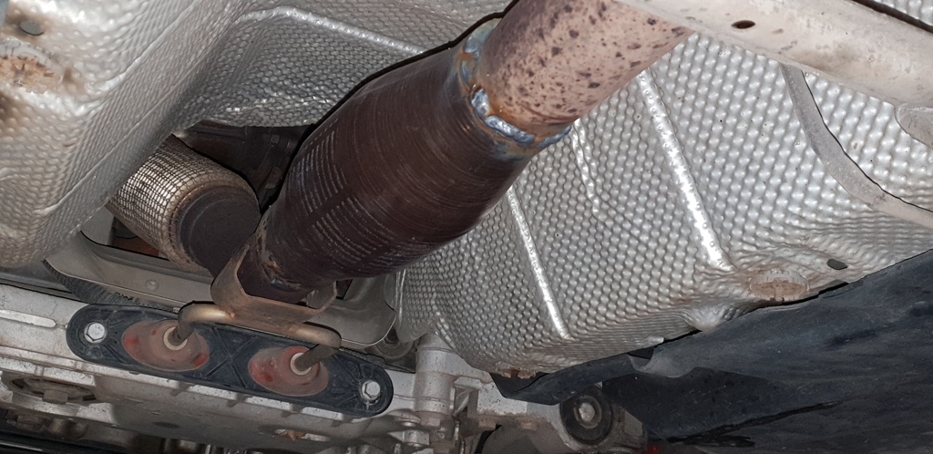

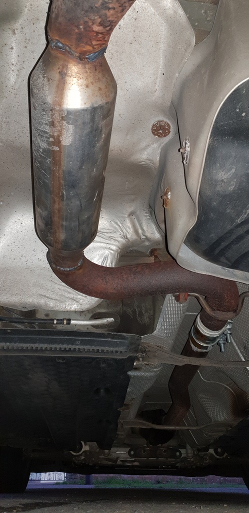

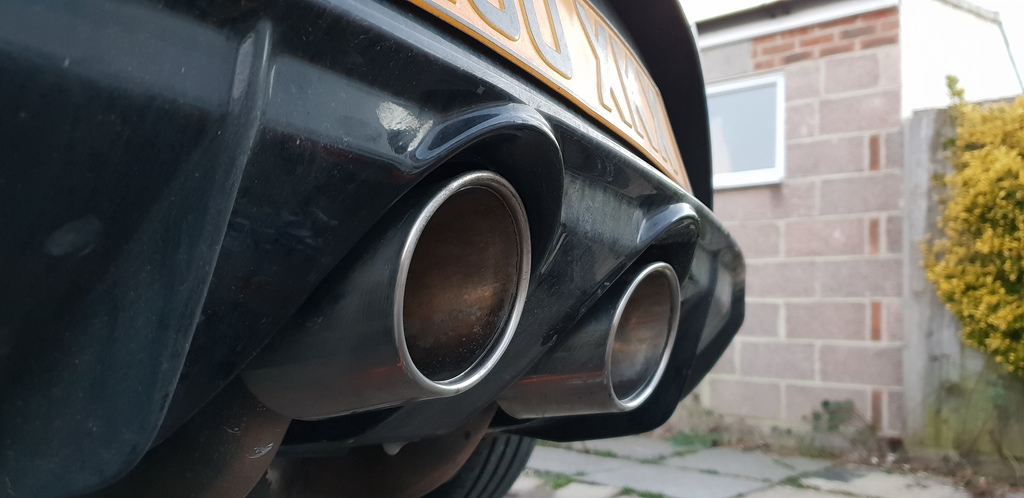

Then had a service done at my local garage, whilst there I talked to them about my crumpled middle silencer and off centre exhaust tips. The owner went into his workshop and brought out a middle silencer from a Nissan 350z, I then said that I'd like bigger exhaust tips as well, he went out and came back again with 350z tips! So I booked in to have them welded in, as well as a Magnaflow sports cat.
Off centre tips as seen above, new bits welded in below.
Magnaflow 200 cell high flow sports cat.
Nissan 350z middle silencer.
Nissan 350z exhaust tips after some Autosol exhaust polish and a wire brush.
I'm pretty happy with the renovated exhaust system, not as loud as I'd like and hoped the tips would stick out 10/15mm passed the diffuser but it solves the crumpled silencer advisory and the tips are much nicer, plus it was half the price of an aftermarket system and the parts were from a 350z! Can't really complain.

Them interior lights are brigher than the sun! As for the error free bulbs they will always be difficult as some cars they work and others not... Pain in the butt!

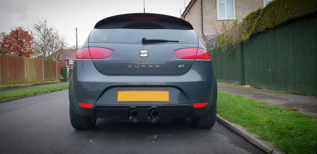

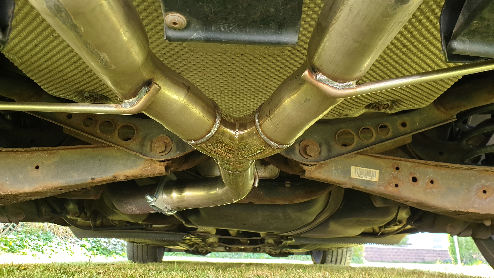

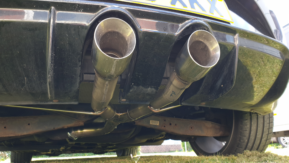

So after lying to myself that I was happy with the previous exhaust changes, it wasn't really loud enough and the tips were welded on pissed plus one was round and the other was more oval shape. I approached Powerflow in Southampton to see what they could for me and then whilst they were making a new rear section, I asked them to remove the silencer as well
So now with a new sports cat fitted previously, keeping the 350z straight through middle silencer and a new de-resonated rear section with 3.5inch tips it's louder and includes low key rumbles and pops.
The right hand side tip doesn't look central to the diffuser cut out but that's just angle in which the picture was taken. Powerflow did a great job and I'm happy now.. honest!
Non resonated? Looks smart. Need a video of the sound!!
I just have the middle straight through silencer, this seems to eliminate most of the cabin drone. Also got a video last night so will look at uploading it ASAP!

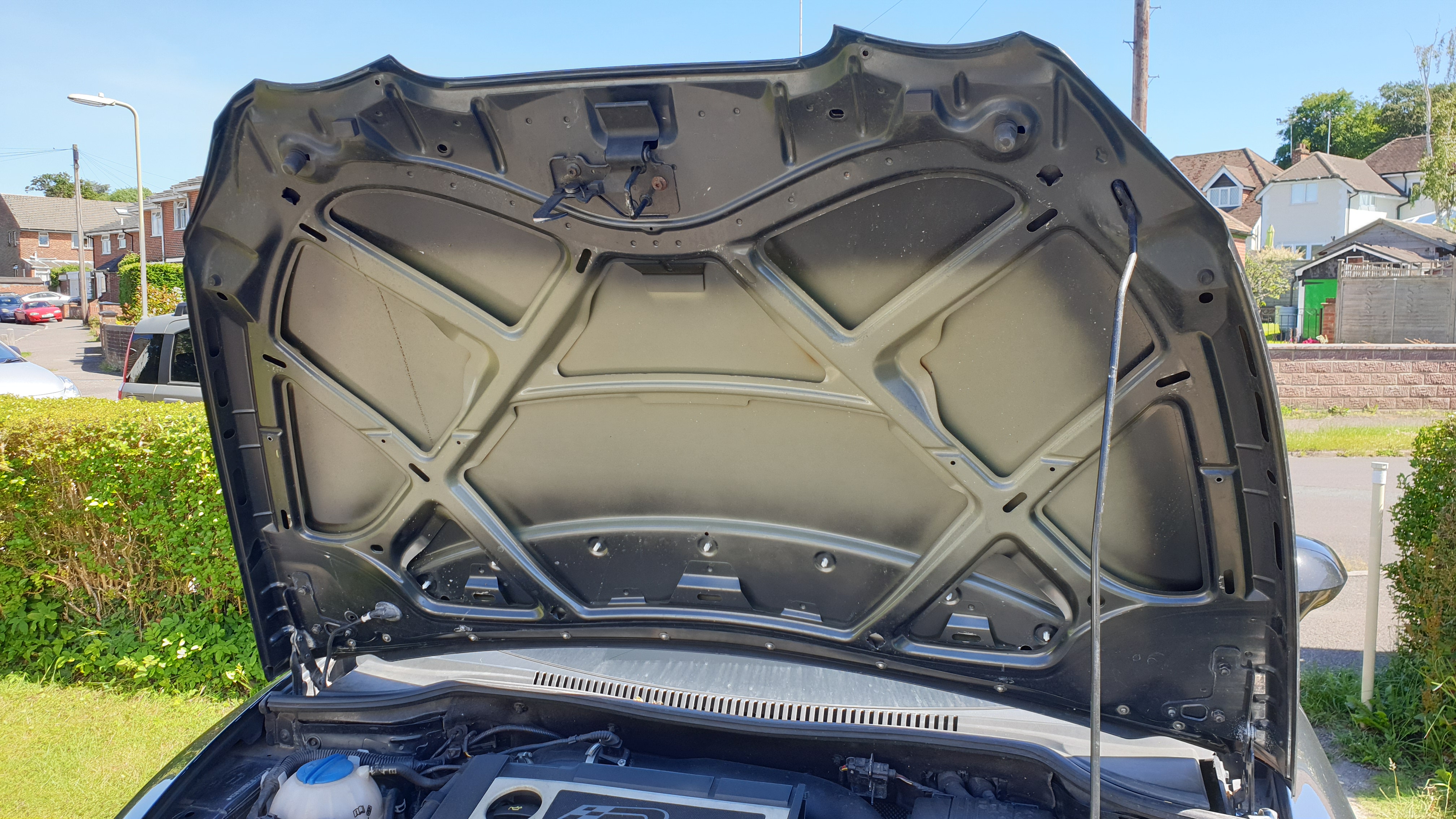

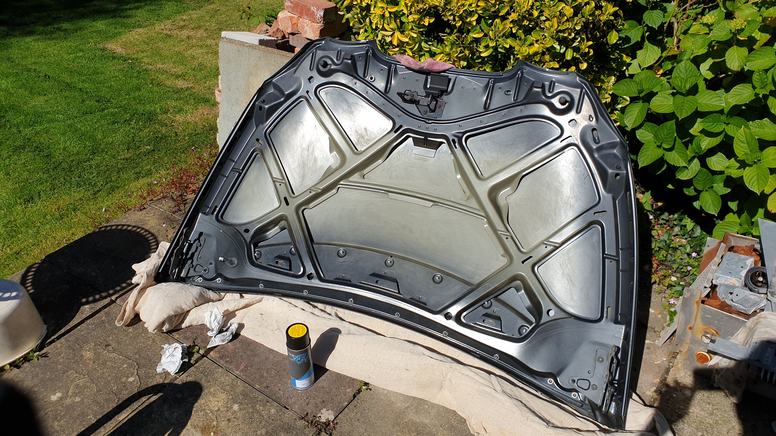

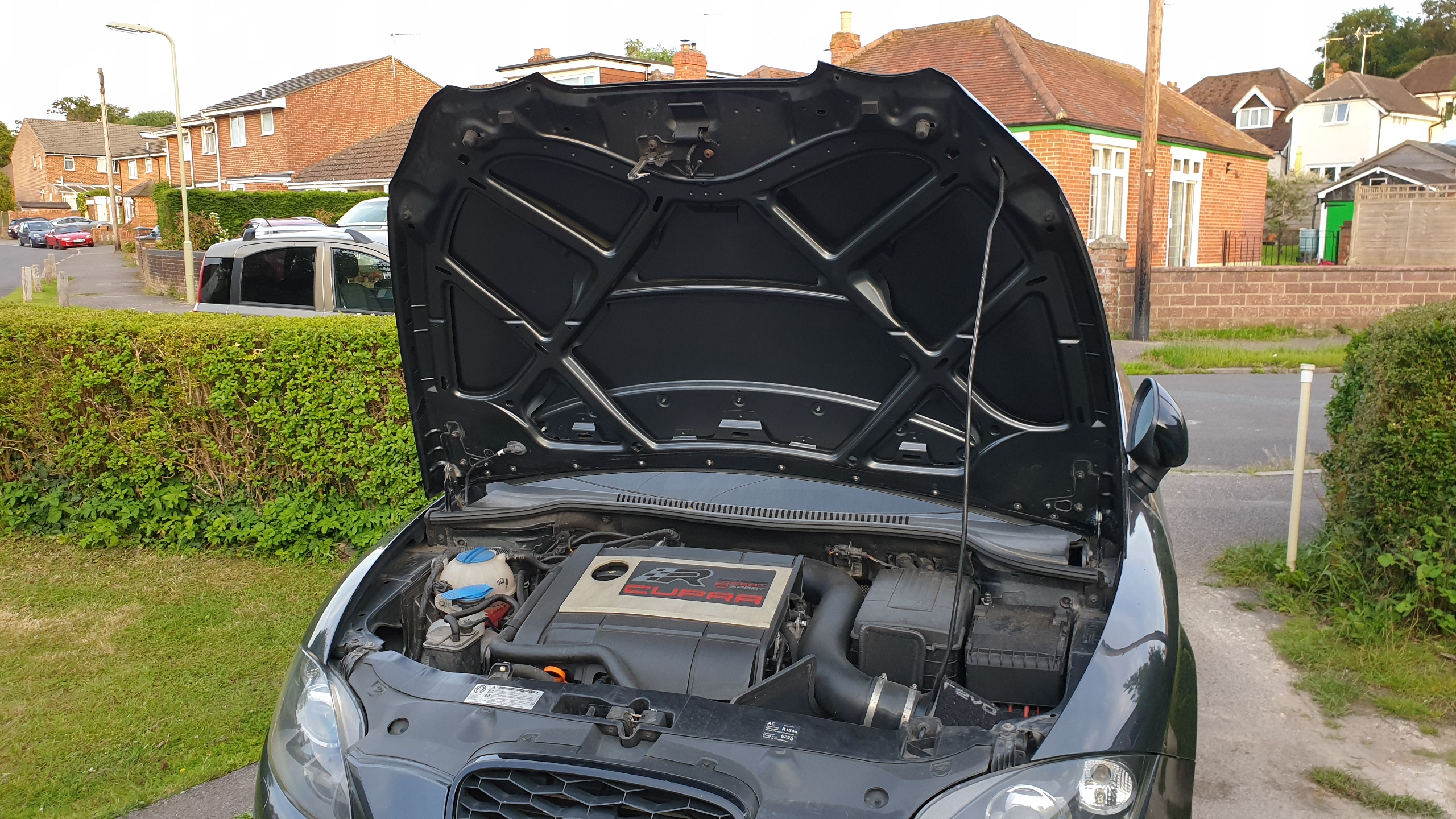

Couple of recent jobs completed. When I fitted my Revo intake, I decided to remove the bonnet insulation in the attempt to amplify the intake noise a little more and then you see where the manufacturers save money by not painting under it - so did it myself with a body colour code filled can of spray paint and a hot summers day.
Took a couple of hours...
But pleased with the end result, looks pretty smart I think.

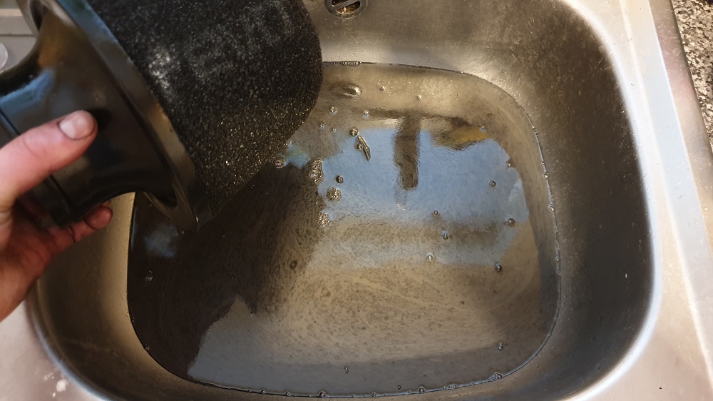

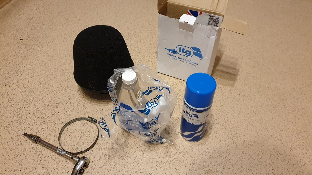

As my intake was on my previous Cupra, then went in storage for 18 months as the car was sold and finally came back out to be installed on the Cupra R, it was well over-due a clean. I bought ITG's foam cone filter leaner (Saw this recommended on another forum, so use at your own risk! Seemed to work fine for me though)
Almost feel ashamed for getting it into such a state!
