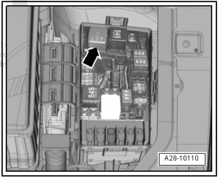

I wonder if it's got any thing to do with the automatic glow period control unit - J179
The issue is that it is operating as intended. Whilst the glow plug controller could be changed to operate for longer on the start cycle, this would reduce the life of the glow plugs. The car isn't stalling, and there are plenty of other sensors measuring pressures, temperatures, engine speed, vibration etc that ensure it is functioning within the design parameters. For example, no of cold starts is one of the factors that will reduce the distance/time on a car subject to variable servicing regime.
As above, unless the amber glow plug in flashing on the dash, and no DTC fault codes, the car is ok.
