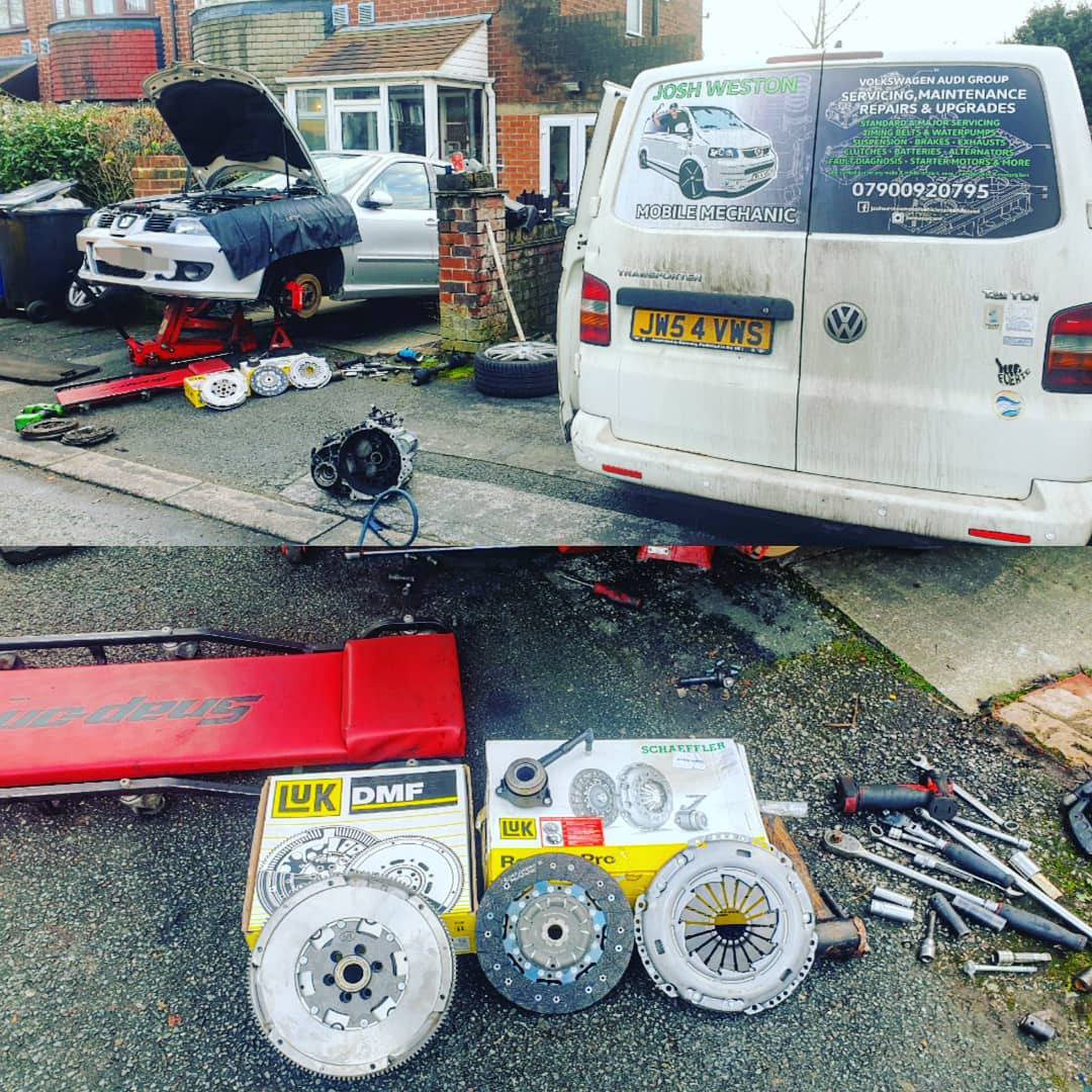

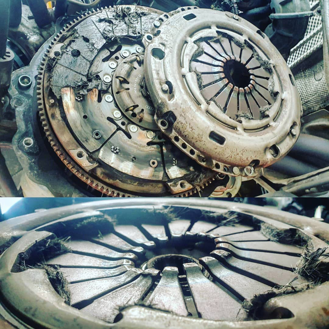

Had a new clutch and DMF fitted after the old one failed and it drives fine, except I'm getting a weird noise when I release the clutch pedal and the gear engages. It also makes the noise when I just start up the car. It's a clunk-clunk-clunk or rat-tat-tat. You can hear it on this sound clip at the beginning and the end: www.violetmount.com/lcr/noise.mp4
Any ideas?
Any ideas?
