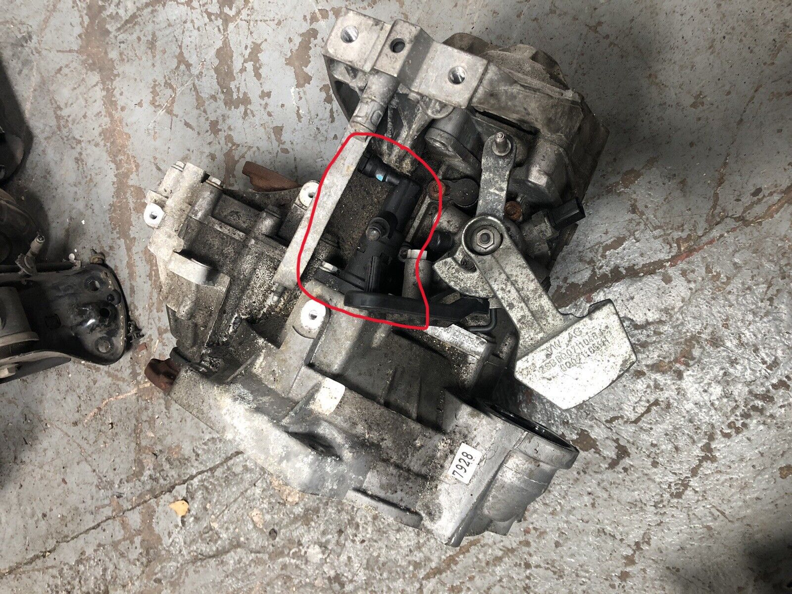

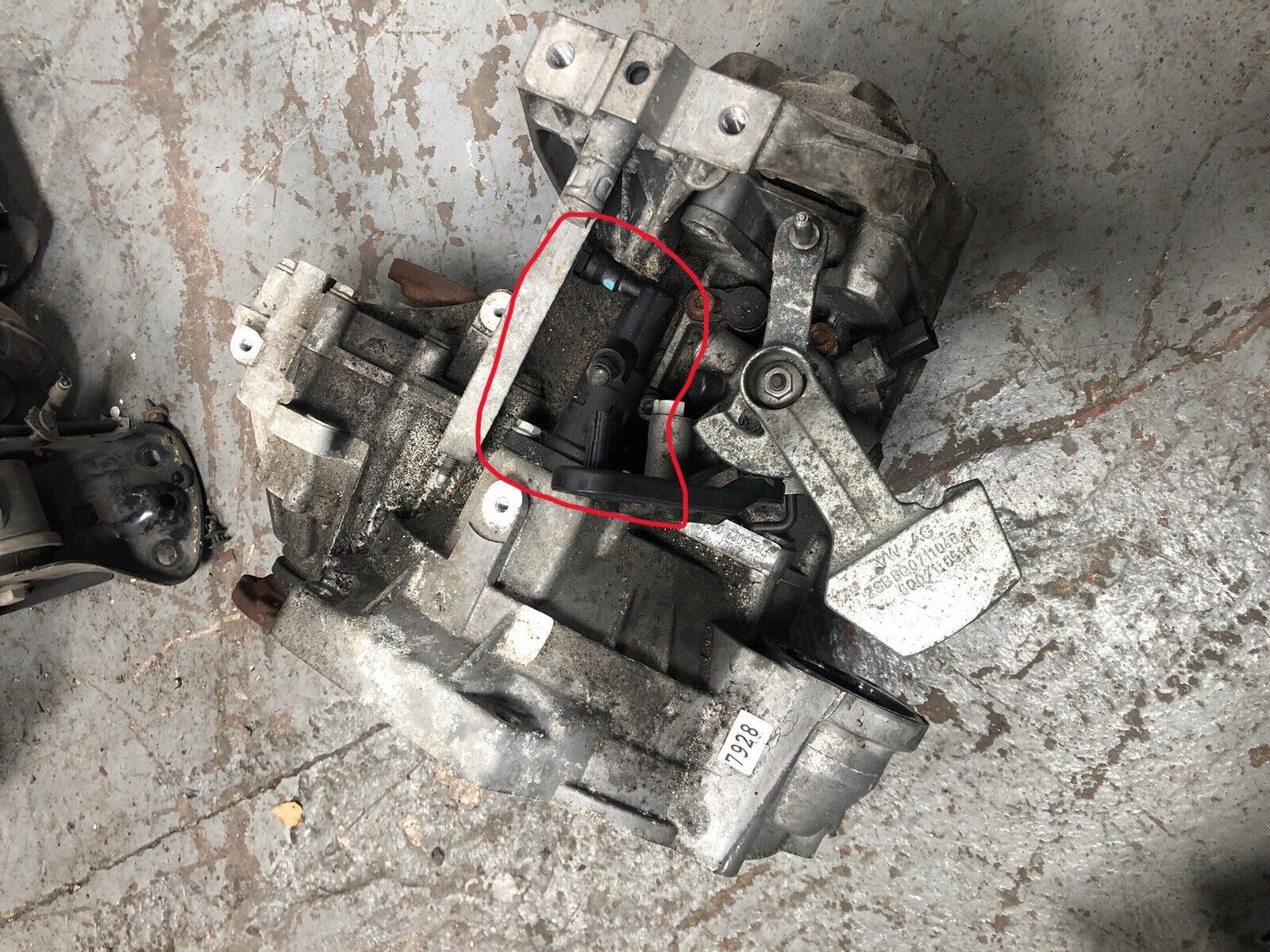

I'm not sure what gearbox is used on the 150bhp version, but I cannot find a single 1.4 tsi 6 speed gearbox that has an internal slave cylinder.
The picture below is a 1.4tsi 6 speed Leon gearbox from a 2017 - so presumably the same as yours. I have circled the clutch slave cylinder in red. It's held in to the gearbox by 2 x 10mm bolts and a quick release clutch fluid line. It's just under the airbox and is ~1 hour labour to change and bleed. The gearbox, clutch and flywheel do not need to be removed if this is what your gearbox looks like.
Of course it could be the clutch master cylinder too, which is slightly more involved but nothing close to doing a clutch and flywheel!
Hope this helps with some information you can go back to the clutch specialist with. Maybe being a clutch specialist they want to change the clutch as thats their bread and butter?
Aha - good spot! - Simple cheap/fix then!
