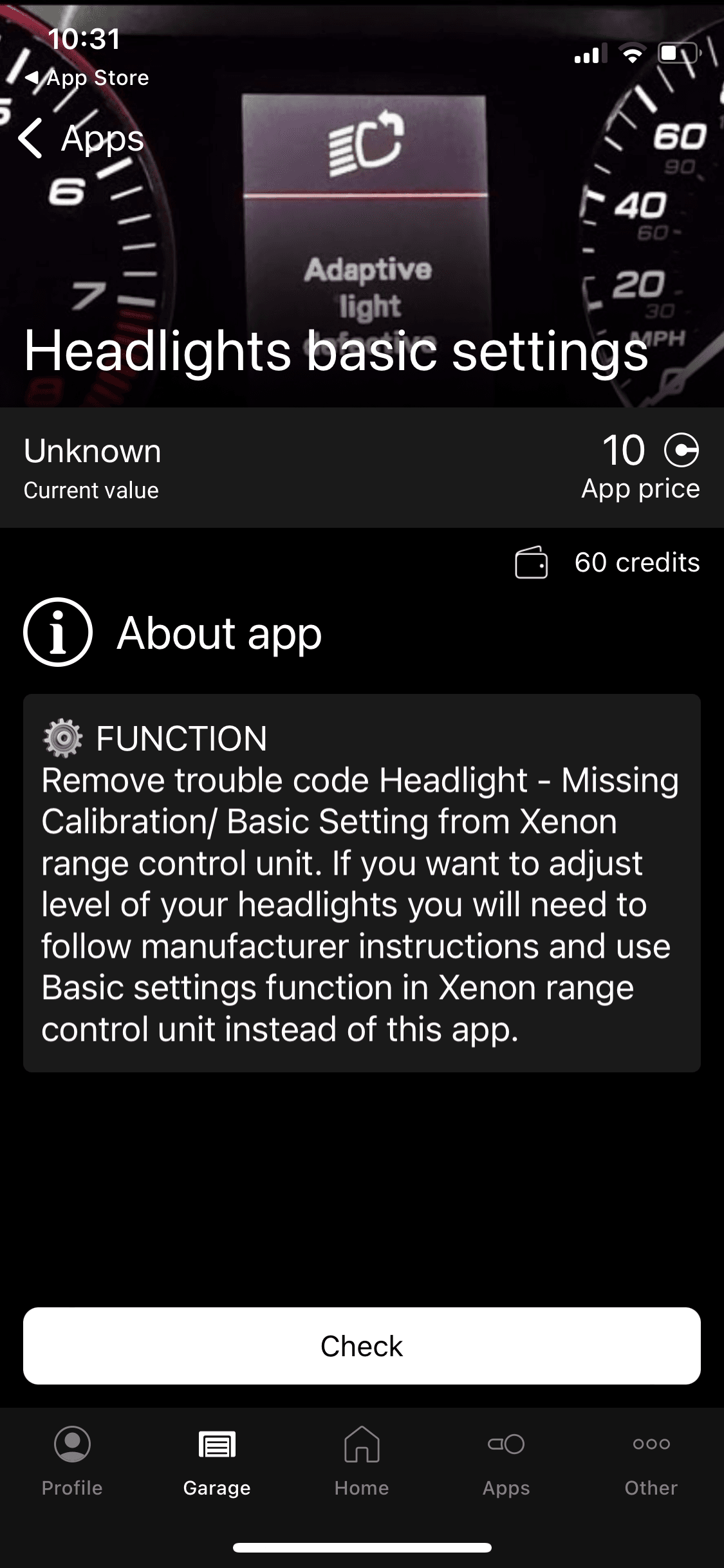

Recently had my 2018 seat Leon cupra 4drive ST for a couple months now, and a couple bits I need sorting with coding. For example headlight sensor to be reset after coilovers being fitted as get error messages occasionally.

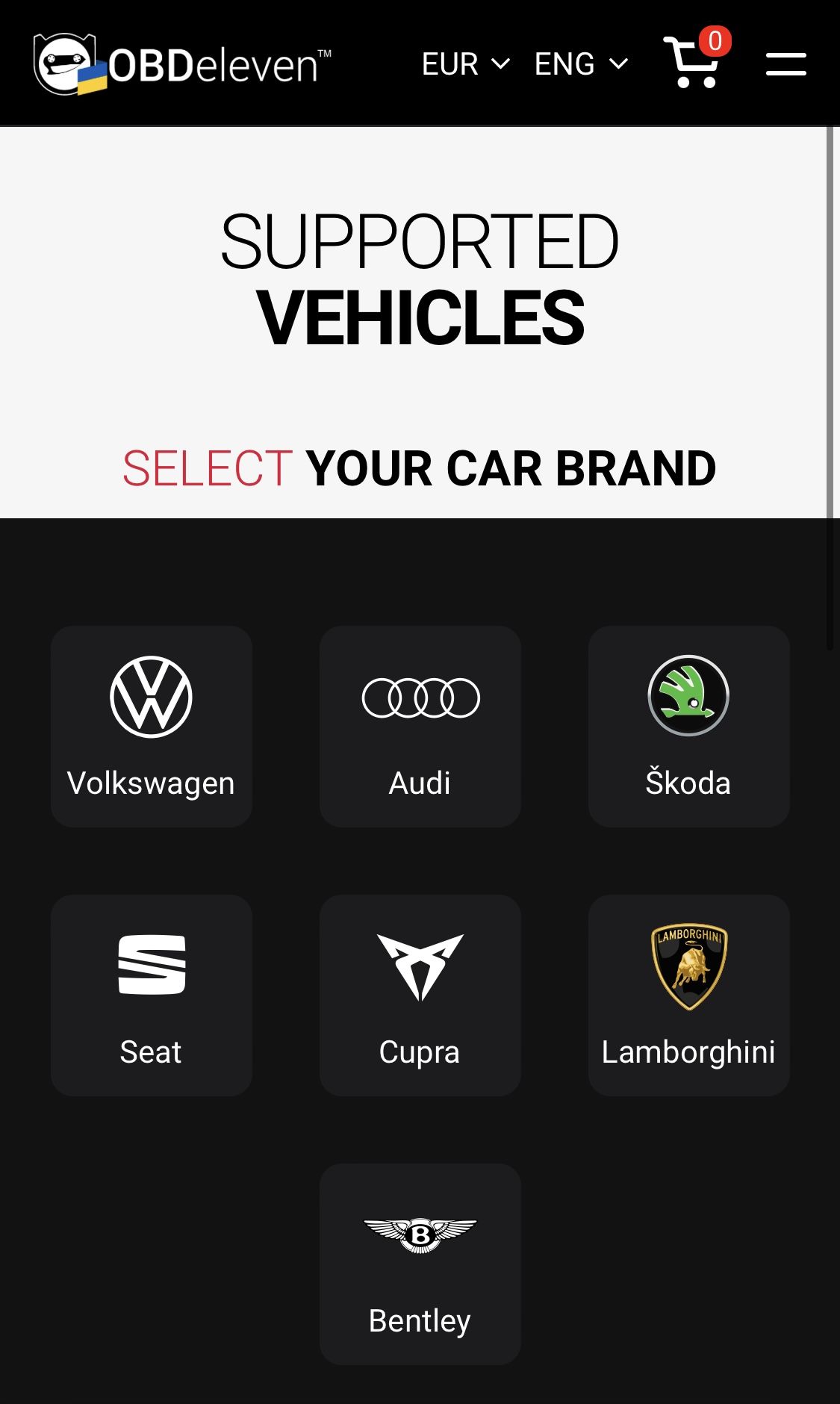

I’ve got OBD Eleven. It’s very good. I bought it for £70, which included the device and 100 credits. It works with:

Would this allow me to go into the headlight module and reset the headlight sensor?
And assume this would scan any fault codes and be able to clear them also?

That’s right, yes. I bought it direct from the ODB Eleven website. There’s no software to download. Just an app on your phone.
