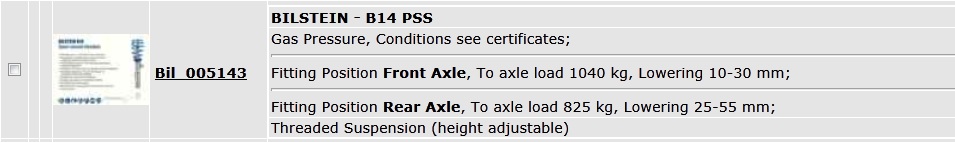

The bilstein B14 I mounted yesterday should be from 10-30 mm at the front, so 20 mm of play.
According to the manual it then should be set to anywhere at 205-225 mm from spring seat to center of bottom mounting hole.
I choosed 205mm i start out, which then should be the lowest setting? OR IS IT??:rolleyes:

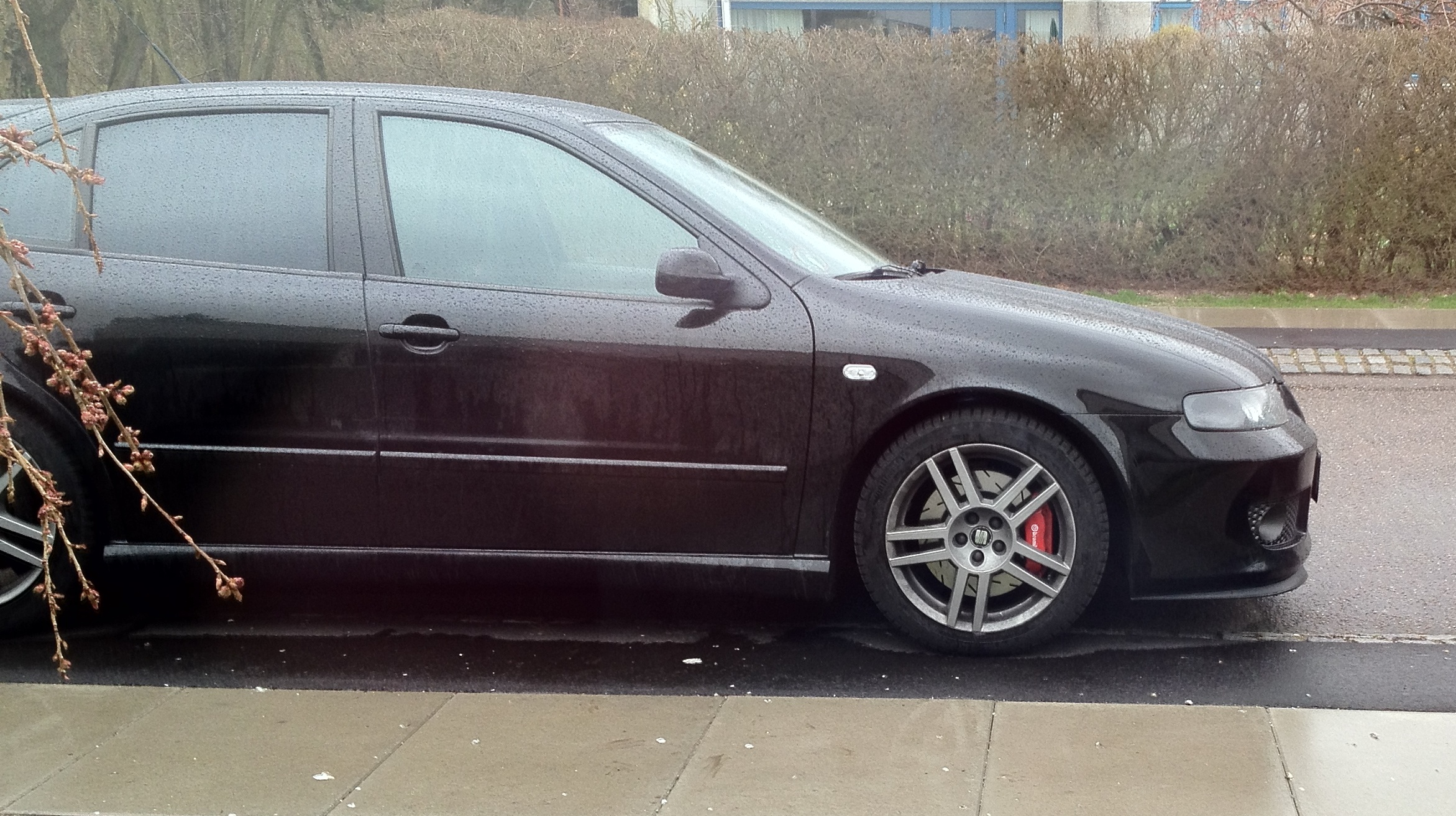

The front is now higher than with my stock shocks + -20mm H&R spring :confused:

Mesaured: from arc to top of alloy (Same alloys before and after)
Stock shocks + -20mm H&R springs: 11,6 cm
Bilstein 205mm: 12,5 cm.

I think the advertised height reduction is Leon specific rather than LCR specific mate?
I'm affraid your right, however, I cant believe Bilstein is that stupud.
The kit are built for Cupra R's + FWD Audi TTs - Which I believe both are lowered from factory(The Cupra R is definitely).
So why would they take zero measured from a Leon 1.6?? That would not make any sense at all.

Bilstein lowered front, the tires follow the arc nicely, and I think thats whats Bilstein are all about, but I had imagined at lille more headroom for adjustment! Note 17 inch winter wheels.
Before on stock shock + -20 mm H&R springs + Note 18 inch summer wheels.

You didn't do much reading on the forum before you chose springs then mate? It's pretty well documented in here that ALL lowering springs use the standard Leon as a benchmark for height reduction.
It does make sense when you think about it. It's the only way in reality or there would be even more confusion.

I really think using "a standard leon" for zero measure is odd, as the Cupra R has a different suspension setup.
I dont see where the confusion is, when I buy a kit specific for my model. Even the part numbers are different comparing to a seat leon top sport.

Well, apart from the measured difference of 10 mm, it should only be 5 mm.
Stock -15mm + -20 H&R = 35mm
Bilstein = 30 mm
