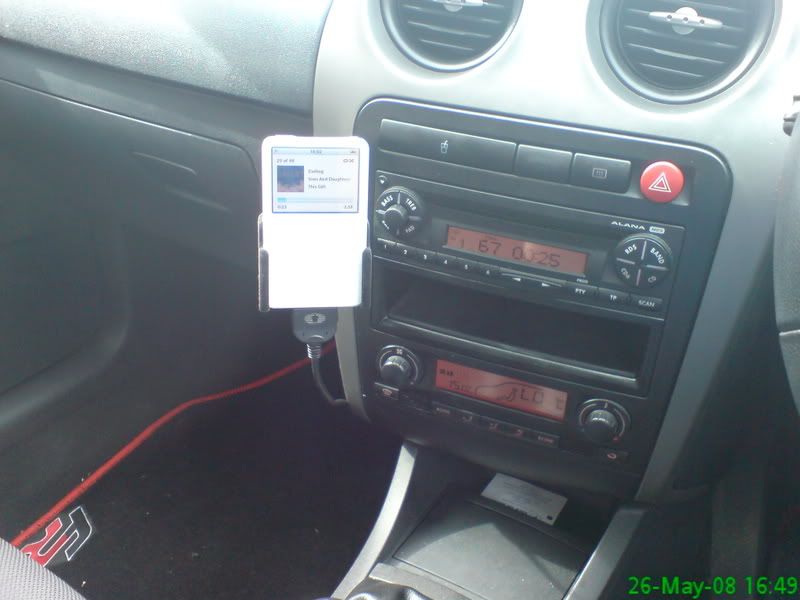

i had my ipod cable routed to the little cubby thing under the stereo, which worked alright for a while, other than it flying out on occasion if acceleratng hard, when it would dangle from the console or hit me hand when holding the gear knob!
so i got brodit dash mount for it. now i can seewhats playing all the time... love it.

with the xcarlink i THINK you can plug in ipod AND CD changer. i cant remember how it works ive had mine a long time now. if you google xcarlink they have a website.
i think it sort of doubles the inputs. cd changer plugs into the xcarlink and the xcarlink into the HU. the xcarlink does plug into the cd changer i know that for definate. CD6 on the HU selects it.
not sure what you mean by where to get hold of cable to connect it? mine came with everything you need.
as for the ipod functions,
pressing 1 on the head unit will make the ipod controls active for you to play whatever u choose by selecting on the ipod. ipod display is active and shows whats playing. pretty much like plugging your ipod into any stereo.
head unit just displays play-time, and it just counts up and up unless you skip track in which case it starts at 0 at the new song. if you don't skip for a 20 minute journey the headunit will just count up as if it were a 20 min track.
head unit controls and steering wheel controls if u have them work as normal controlling the ipod.
pressing 2-6 on the HU selects playlists 1-5 - the first 5 playlists on the ipod. A little confusing with it being first playlist as 2, 2nd as 3, 3rd as 4 etc. and it also turns off shuffle when you do this, so it always plays the songs in the order theyre in the playlist, which i found annoying but it depends what u want.
personally i dont use the playlist buttons, i just plug ipod in and set it playing what i fancy - whether its a playlist, an artist, album or just shuffle all songs - and then I can use either the ipod, the HU or the steering wheel to change track, skip forward, etc.
