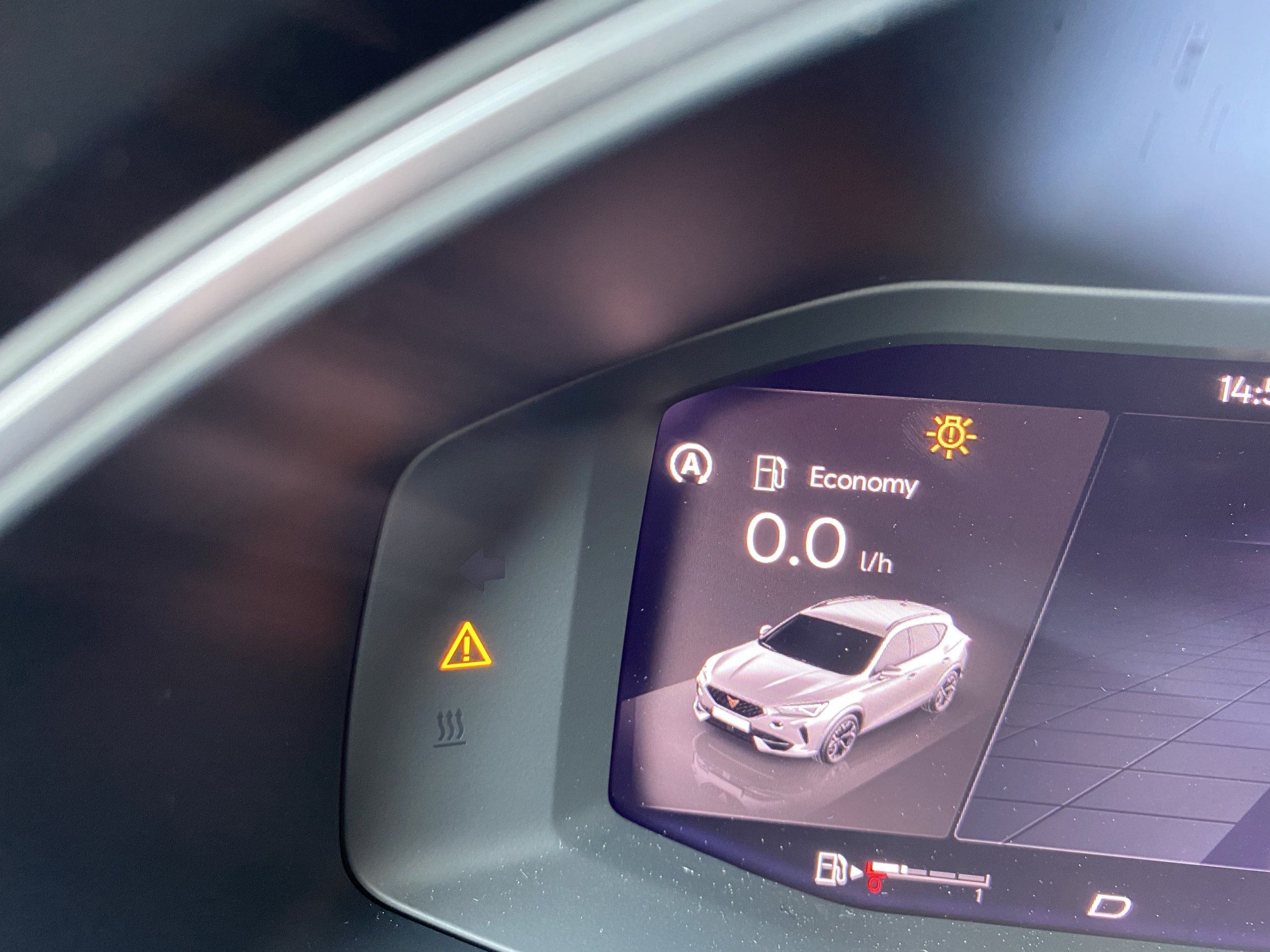

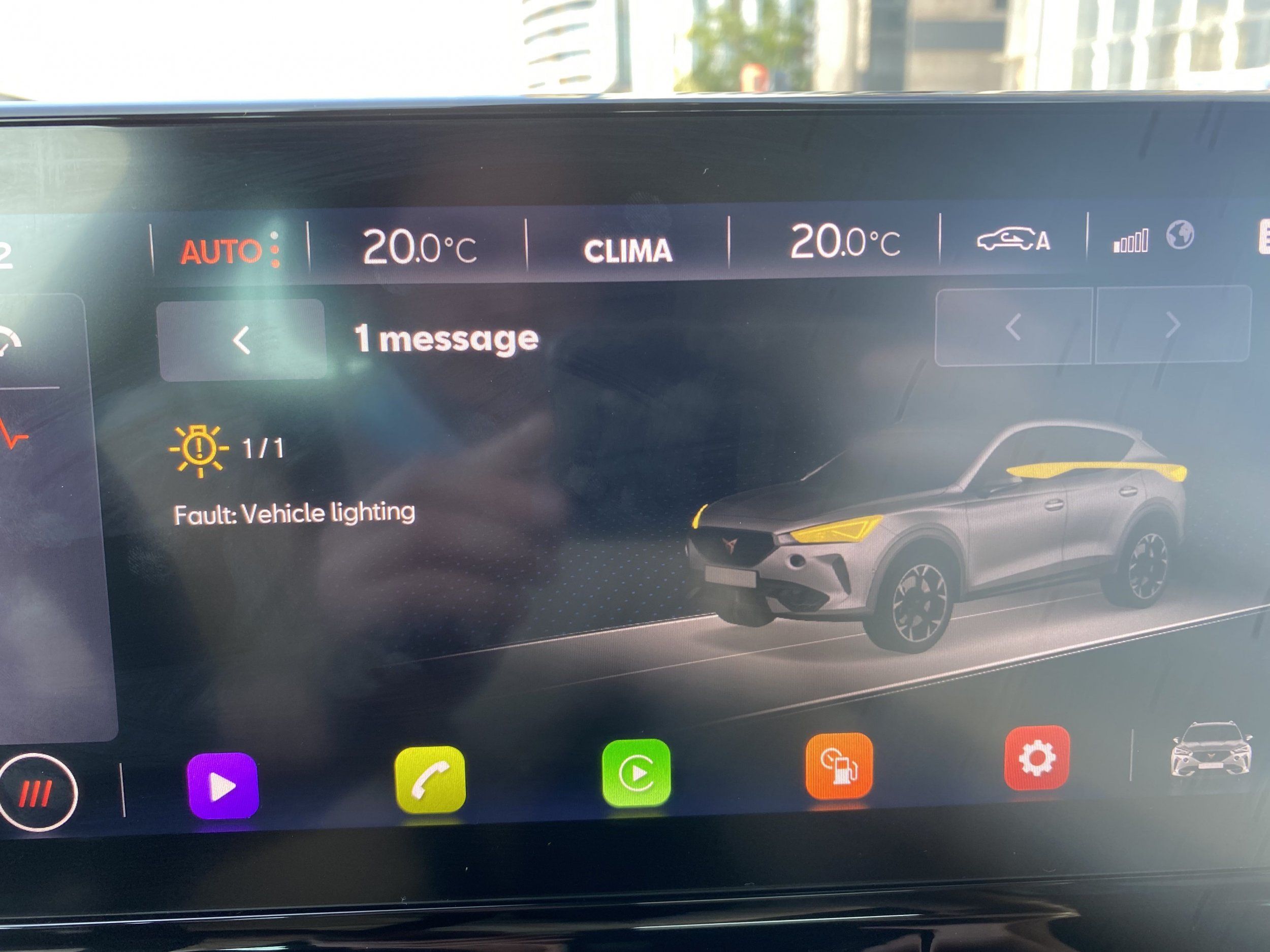

2. When I turn on the vehicle in the dark, sometimes a warning light about the lighting comes on, and also an error appears in the message center; I checked, and all the vehicle's lamps look perfectly normal and work properly, turning the car off and on raises this fault.

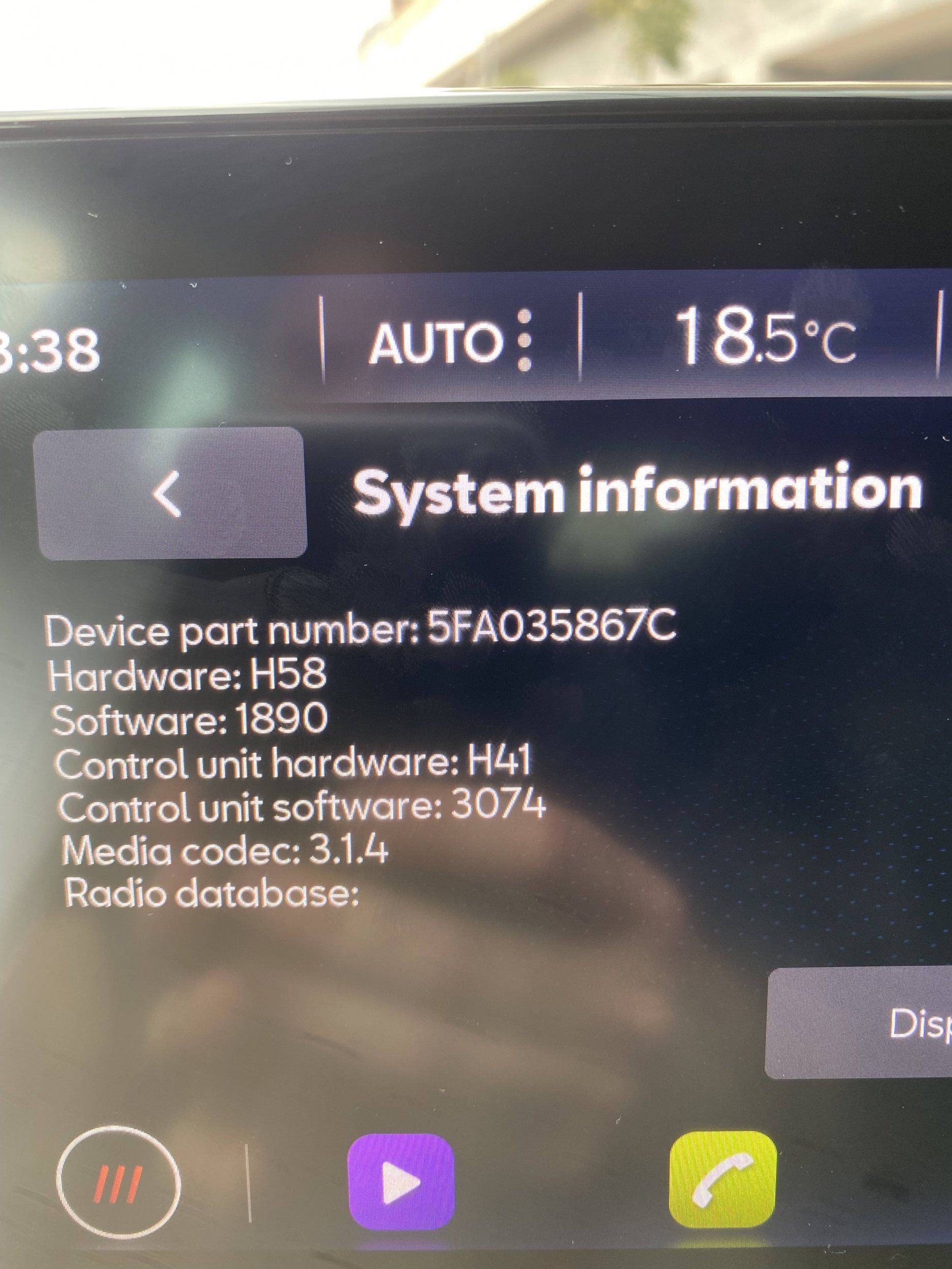

These are the versions of the systems currently in the vehicle:

I’ve never had any of these issues thankfully, but it looks like you are on the latest and allegedly greatest version of the software that has meant to have solved all of the problems.
