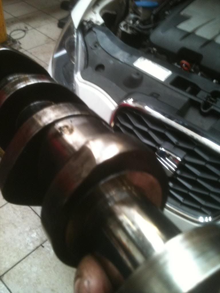

I've got a FR+ had it just over a year and the only problem I've had was sticky turbo veins since I've had that sorted it drives better than ever if my cam does go ill just look to get performance one

I would go for the beamer, I have had my Leon FR+ for 6 years and on average have had a major fault once a year. It's a 55 plate and I had a new cam at 107,000 so the chocy cam still exists. It is actually in the garage today for a burst heater matrix.
Stanard turbo, performance cam...? you'll be wasting money if you do that because the standard turbo limits the car to 200ish bhp. Unless you plan to go hybrid/bigger turbo etc. Also, why would you? Say it takes 130,000 miles to break ( could be down to maintenance factors) then why worry about it breaking again? I doubt many Fr's or 130's will see 250,000 miles on here....
