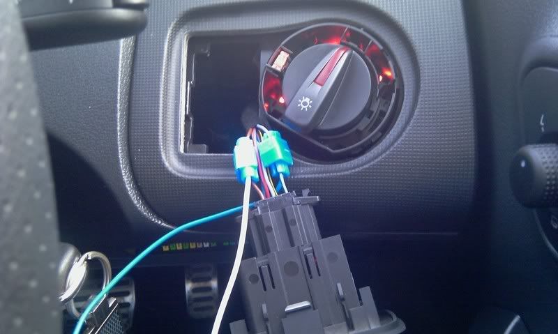

First, I had to find where I could connect the wires for the LED's to work. I wanted them dimable like the other instrument lights.
The two wires with the scotch locks on are the ones. One is negative and the other wire drops voltage on a multimeter when the dimmer wheel is turned.

I ran the 2 wires from the the back of the dimmer switch through the dash to where the lights were going.
Used spades to connect the LED's to the + and - and gave it a test.

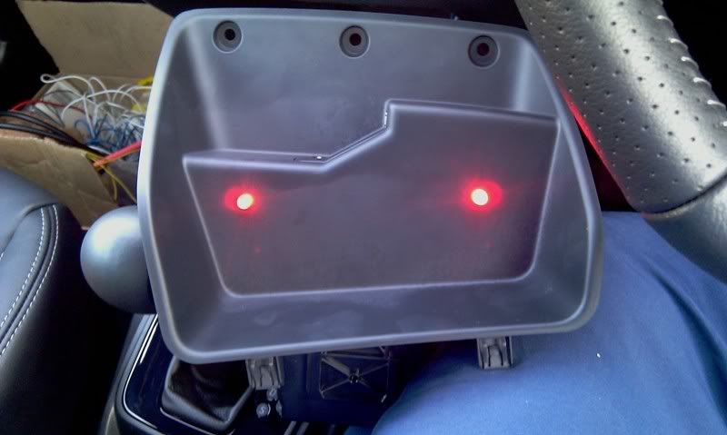

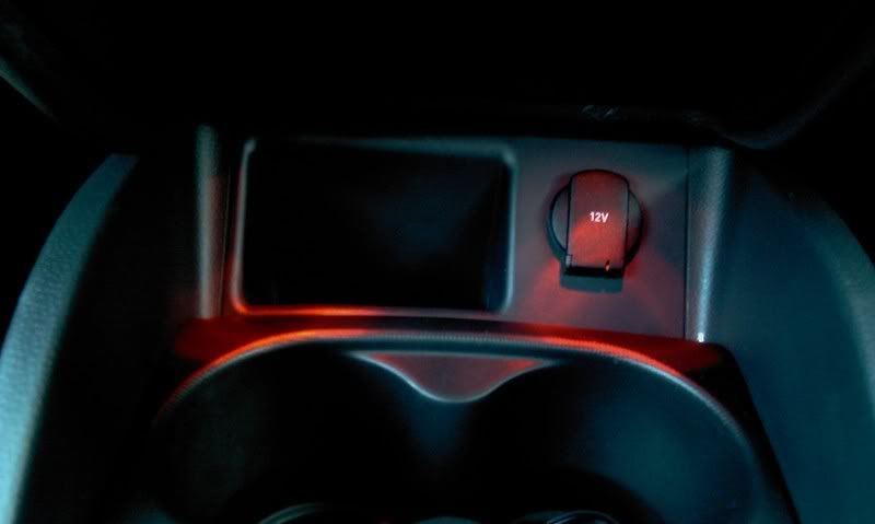

Voilà!

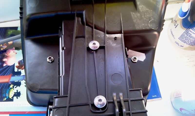

I took off the trim which houses the USB port with 3 t20 torx screws.

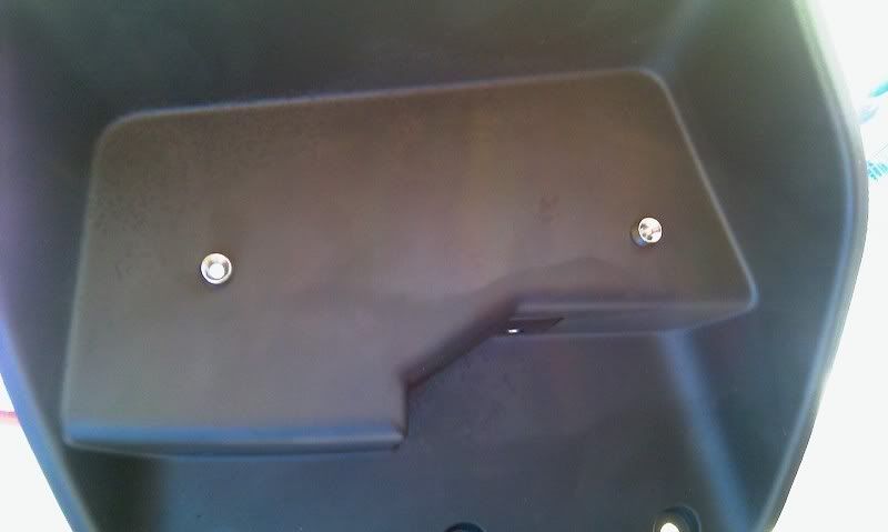

Drilled two 6mm holes one roughly over each cup holder. Placed the LED holders in and secured them with a little nut on the back.
