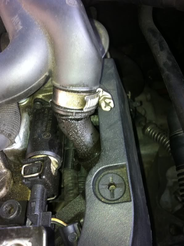

Check tge breather hoses under the manni mate if the split then it will cause this ;)
checked mine last night... wasnt the breather hose.. but the one under it.
ordered a red silicone one from ebay... might aswel get the engine bay tidied now then ;)

That's one of the useual suspects mate they will all go :( fit a catch tank ;)
