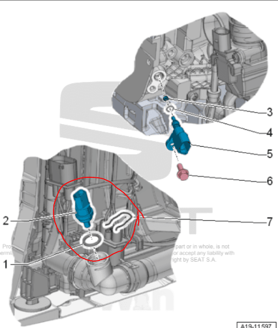

So based on this picture, there seems to be 2 sensors and I have changed one circled in the picture.
So I have changed radiator outlet coolant temperature sender.

I'm not familiar with the 280, but in earlier cars there were 2 seperate temp sensors, but they were inside one sensor housing (4 pins) One sensor fed data to the ECU, one sensor fed data to the dashboard. Maybe in the 280 they have split it into 2 seperate sensors? I would try to replace the other sensor if not too expensive.

EDIT: After looking at parts for your car, i think they have split the sensors into two seperate sensors. Each sensor has 2 pins, so this would make sense that one feeds the ECU and one feeds your dashboard
Here is the one you changed: (circled in your pic)
And here is the other one I think you need to change.
I hope that helps

Thank you for your reply. I wish I knew where this second sensor is located or where to look. I am not so good with cars ☹️
