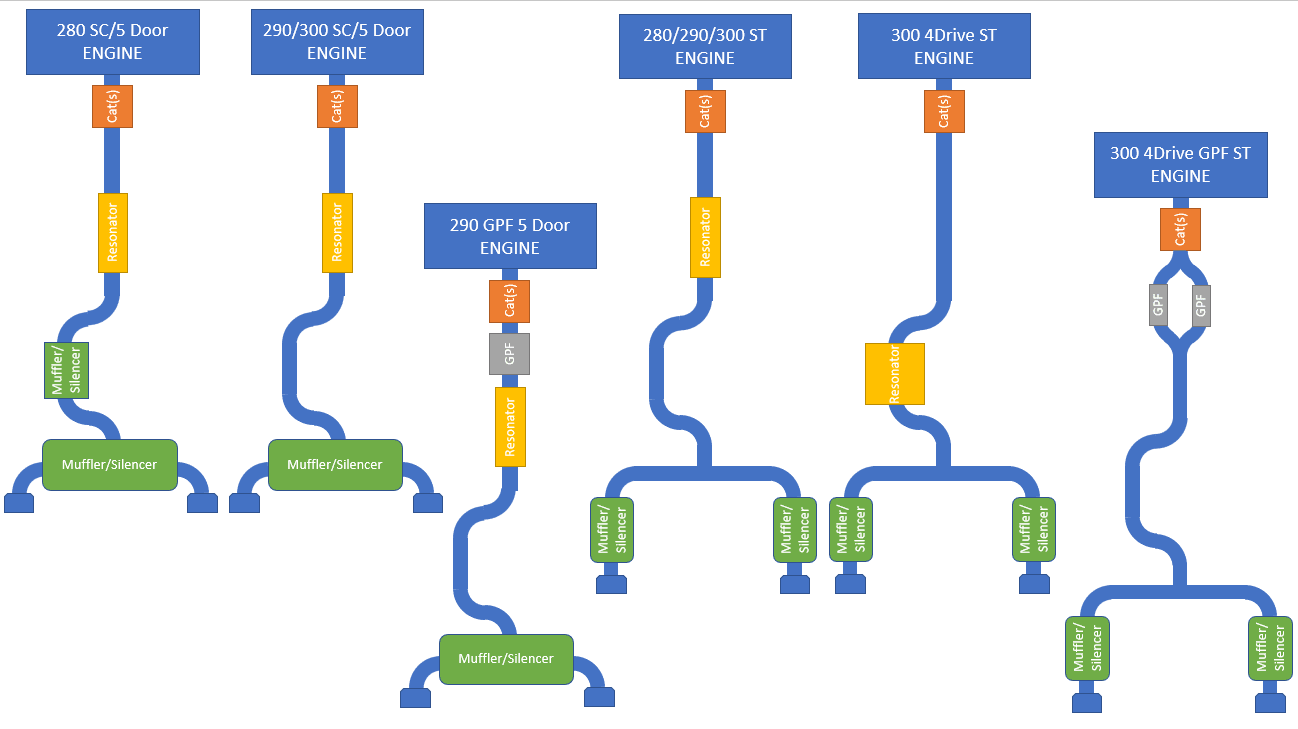

If you want a 290 SC/ 5 door exhaust on a 280 Sc/5 door you effectively just remove the central muffler in between the resonator and the larger rear muffler (so have 2 boxes running in series)

Sorry for the terrible drawing just couldn't be bothered finding the oem diagrams...
As this graphic is all over facebook, and was only meant as a quick example, decided to do a better version with the updated GPF cars...
Doesn't include the 290 GPF ST that is sold in europe, but never seen a photo of one of those so can't really show its configuration. I expect it to look like the 290 ST with the GPF positioned like the 290 GPF 5 door.
