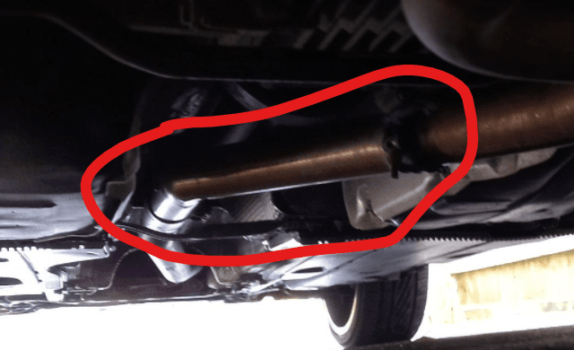

Hi,

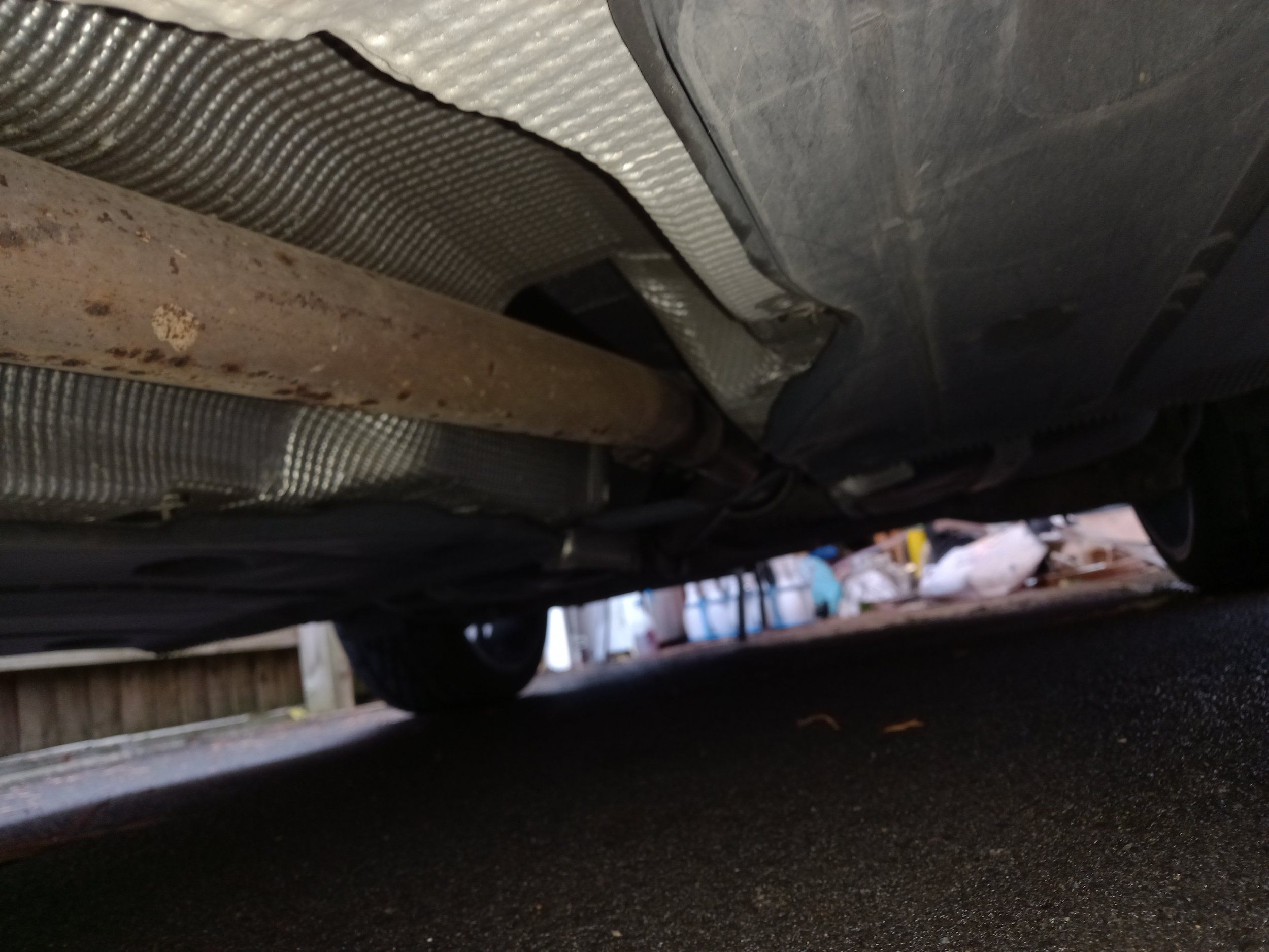

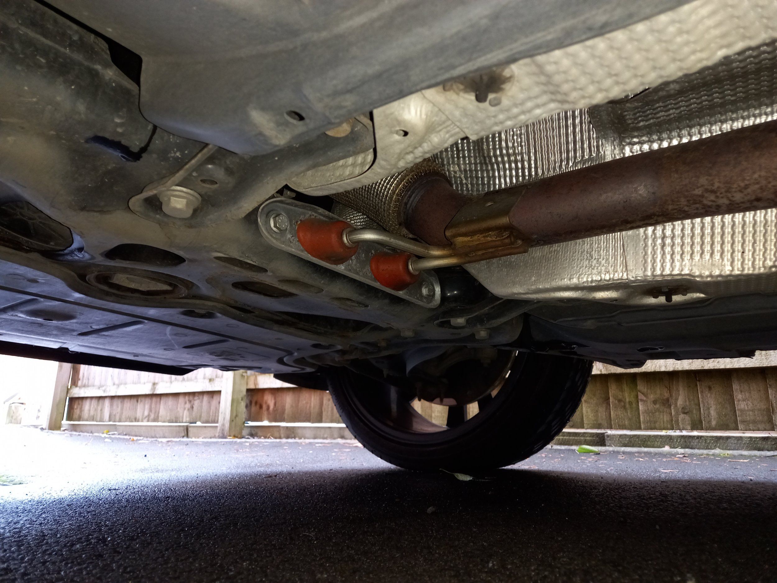

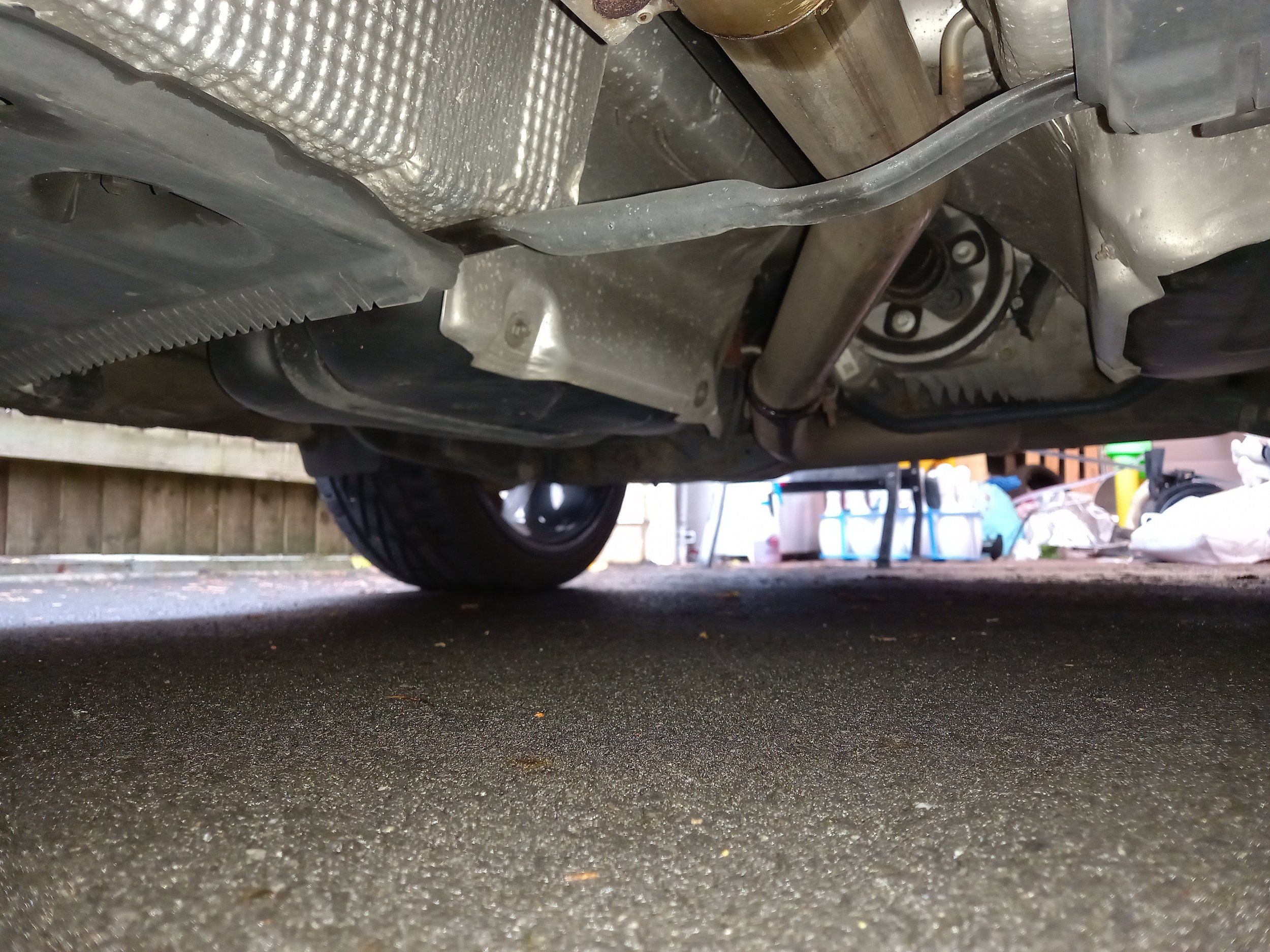

Was looking at adding some noise to the cupra, res delete maybe
Had a quick look under my 2017 Cupra ST 300 4drive, surpsied that I couldn't see a center silencer/resonator. I've done some research on this forum and seems to be the norm for the GPF 300 4drive cars but I'm sure mine is a good time before the gpfs became the norm? The entire exhaust system on the car seems to be standard
Added some photos(not the best I appreciate)
Anyone able to shed some light on this?

The centre res has already been deleted on your ST. It usually sits just in front of the RWD transmission box

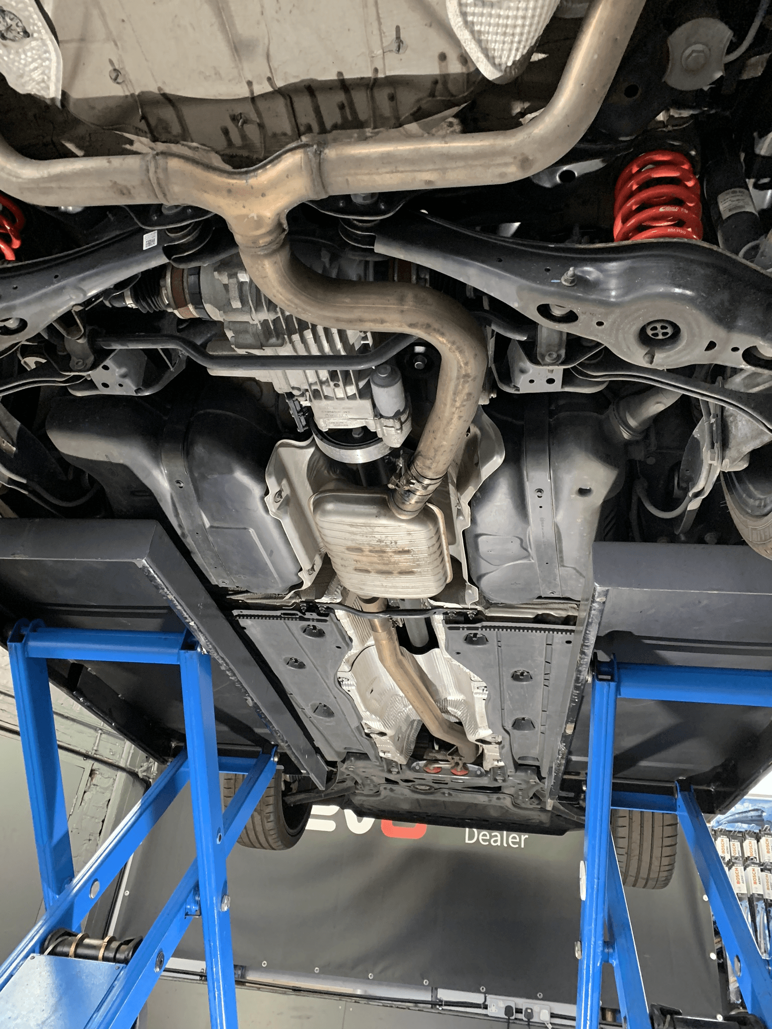

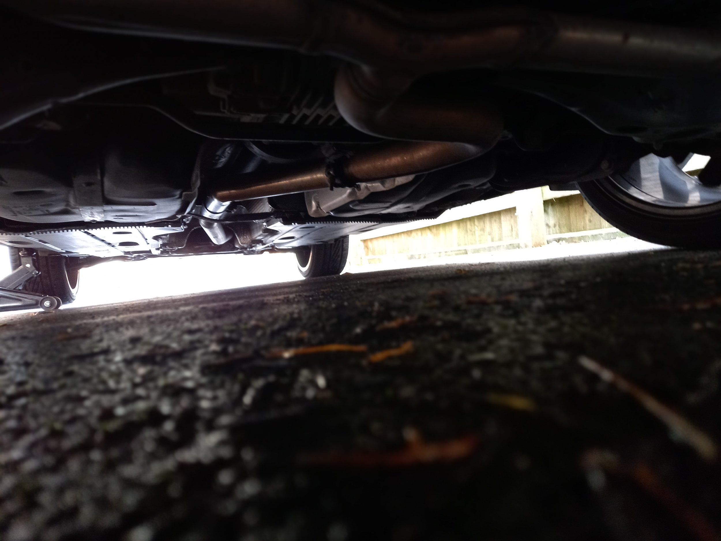

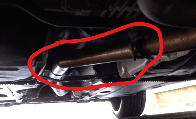

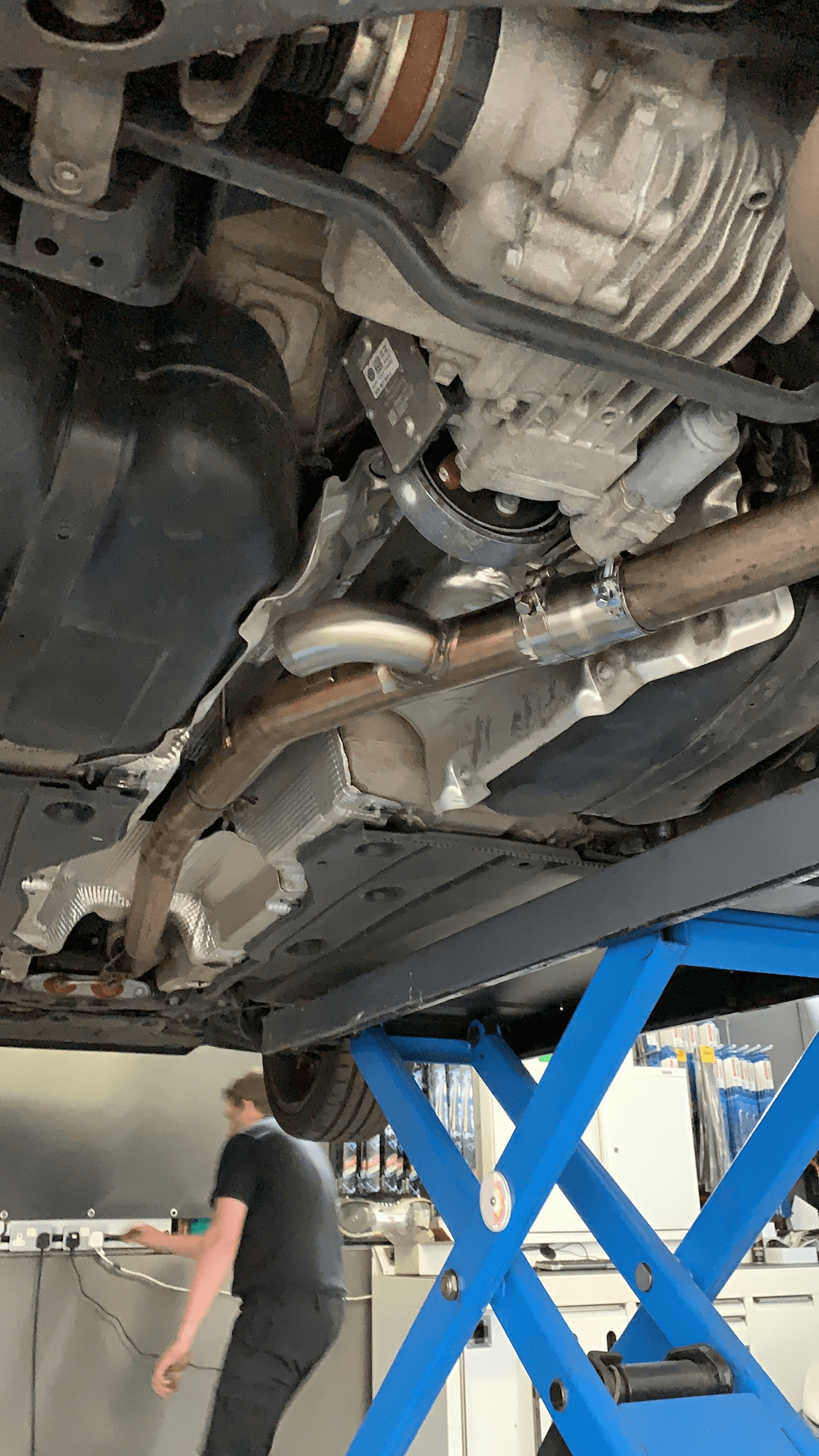

Nope, thats a res delete:
Its not normally got a join on the right after that photo.
Here is a picture of mine, (although mine is after the res was put back in so has a join where it was previously cut):
And here it is again with an updated res delete fitted:

Cheers for the quick responses. Quite unexpected as I'm finding the exhaust quite muted, few DSG farts under hard driving but other than that quite a quiet system. Seen a few vids of pre gpf cars with res deletes and sound a million miles from mine imo
Excuse my ignorance I've never seen anything like this before What's the bend coming out of the middle about? ?
Its know as a Helmholtz resonator or pipe. It helps reduce drone (size is dependant on the frequency of the drone) without reducing the noise as much as a traditional resonator.
Lovely sounds like exactly what I need thanks I've made a custom set up on my cupra 280 and drone is really bad only in certain situations I love the sound but hate the drone I'm gonna give it a try... Is it just a piece of capped pipe or is it actually filled with something I suppose what I'm asking is it something I buy or make? Thanks again for your help... Sorry for kind of hijacking this thread.? ? sam
Its just a blocked end, nothing in it.
The size is what is important, I'm no expert on it, but the size will get rid of particular unwanted frequencies. The wrong size won't make any difference.
This was the prototype and it wasn't expected to be right first time as it was an educated guess on the size of it. But it was bob on for me and it ended up staying on the car. When I put the car back to standard it went back. Hopefully, they'll start doing on now they have mine back haha.
On another note to take the guess work out...
The standard resonator is the correct size. Someone on the Golf R Forum with an estate, rather than create what I had, he got a piece of metal tube and slid it inside the resonator pipe itself blocking the little holes. So it kept the resonator effect without reducing the noise.
