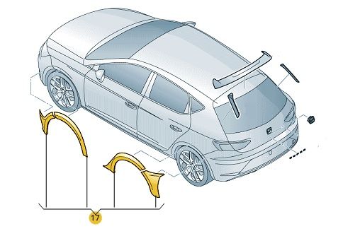

Hello all!
Has anyone got any information to share about mounting the R fender flares/ wheel arches on the Cupra 300 ST?
I have seen pictures of it done on the estate but it would be nice to get some in depth information. As far as I can tell, the rear piece that goes behind the rear wheel and bumper needs to be modified because of the different lines and rear ends of hatchback vs estate.
Part Number5F0071680 GRU

Front is a straight fit for obvious reasons.
However, the rear requires 2 pieces cutting to shape sanding smoothing etc.
The first is the rear fake vent. The shape doesn't match the rear bumper shape, so its just sanded down to an arch shape like the rest of it.
The diagram doesn't show all the parts, there is an additional part that sits under the final part shown in the diagram. This is the second piece that needs cutting etc.
Finally the join lines do not match the standard ST bumper, so depends on how much that would annoy you:
There are at least 3 STs that I'm aware of that have done this. One in the UK is a white replica diesel FR.
And 2 Cupra R ST's in Sweden I think.
Fantastic info. Thank you very much! Much more to go on now ... The question now is how much work is involved for a regular person to pull it of. I will have to do some research and some marathon watching of youtube tutorials before I order the parts.
