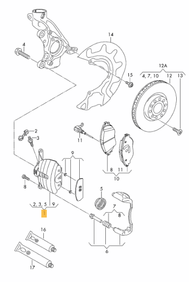

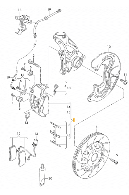

The easiest way to check is to cross-reference the part numbers on EKTA - the online versions are only up to 2016, so Cupra Ateca Is not listed.
The Brembo brake kit for the Leon Cupra is here - OEM part numbers listed:
There is not the equivalent kit for the Ateca, but they do have the Leon 370mm discs listed, which confirms some commonality.

The wheel bearing housings are different between the 340 TRW and 370 Brembo brake versions.
Whether the mounting holes are the same position/distance apart I don't know, or whether the rest of the suspension is the same so you could swap the bearing housings again I don't know.
Edit: to add the mounting bolts are the same part number, number 2 and 4 respectively, and the brake hose is also different.

Have checked and also different lower ball joint between TRW and Brembo versions.
Seems the Brembo version is also used on the RSQ3.
