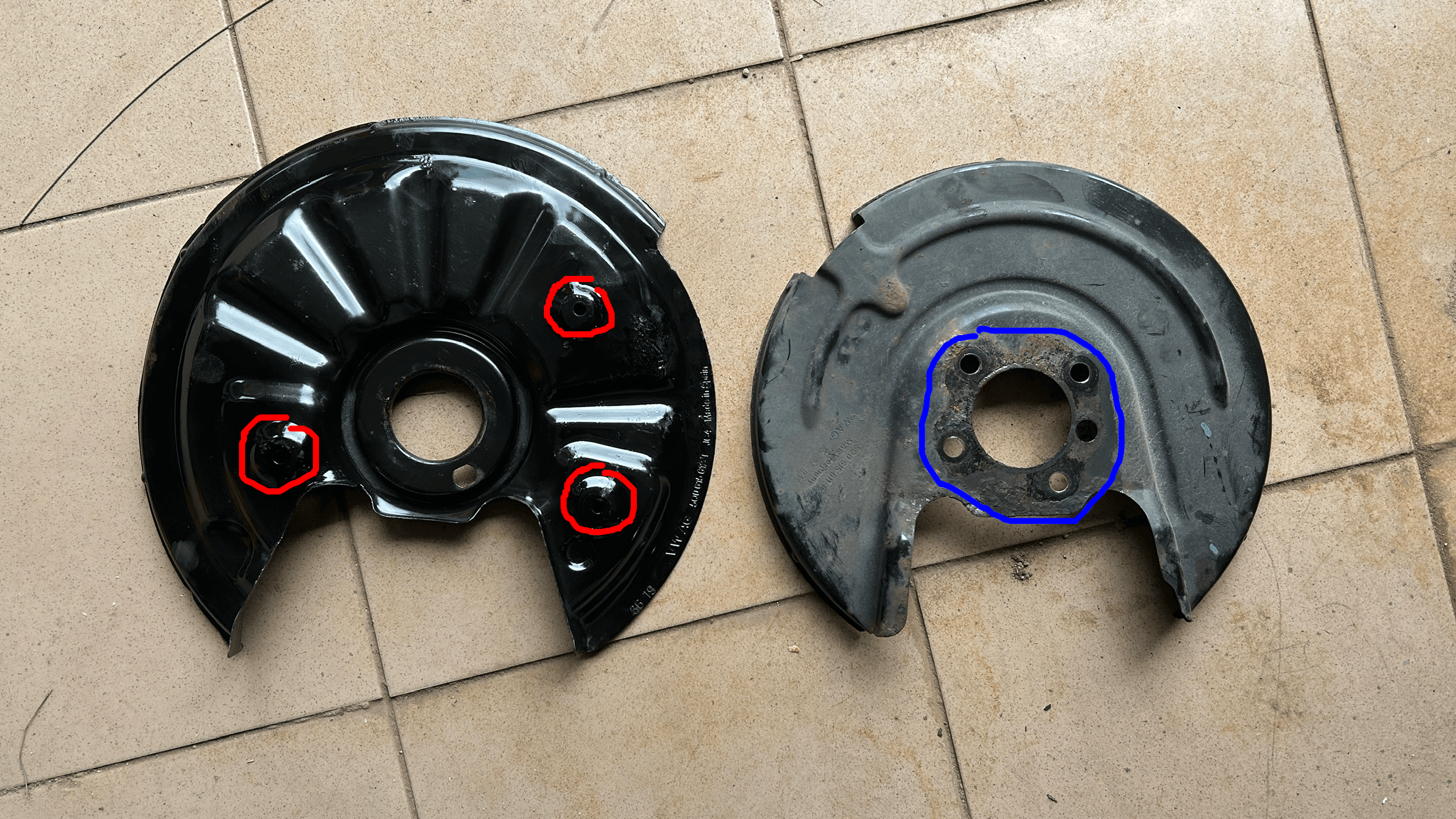

  2. Are there any brake disc covers for 310mm disc and torsion beam? I've received covers with the brakes, but they does not fit. I suppose they are from car with multi-link suspension and have different mounting points. Red circles are from 310 (new), blue circle is from 272 (old)

Interesting. There was never the 310mm rear brake fitted to a torsion beam car - so it will be upto you to modify your 310 splash shield to fit or leave it off.
Car you re-drill your new 310mm shield for the torsion mounting hole pattern?
Probably yes, but 310 ones have different embossing with more groves. Also the center hole is a bit narrower but this should not be a problem. Currently that's my best bet to complete this mod. I am also thinking about cutting middle part with angle grinder and welding two covers into one, but that's the worst case scenario for me :D

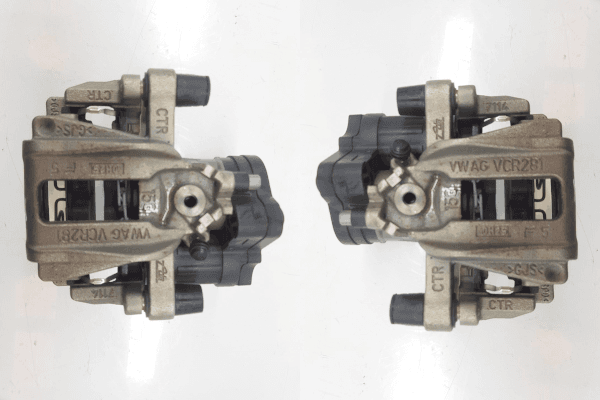

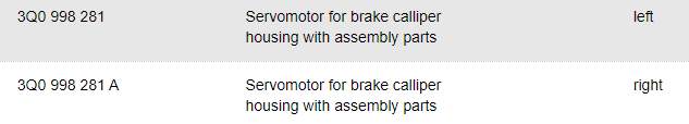

Have some info about my 1st question - I've tried to replace right electric handbrake motor with left one on my old rear brakes (272) and unfortunately they are not reversible. Nut holes are off-center and it is impossible to screw right motor on left side and vice versa.
PN of old motors are 3Q0998281 and 3Q0998281A, and Leon KL ones are 5WA998281 and 5WA998281A. To me they look almost identical and I am really confused why I had to reverse rear brakes in order to connect them. I guess that without taking wheel of a car and comparing them side by side we can only guess.
Just to check something. If you swapped the right and left callipers over does that mean that they are mounted upside-down?
Not really, but the motor of electric handbrake is on the other side of the piston. Here you can see on the image how it looks in correct position and on the other (it the same calliper, just rotated). Left and right side are mechanically identical so it should not matter in which side they are installed
