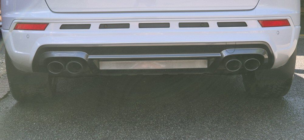

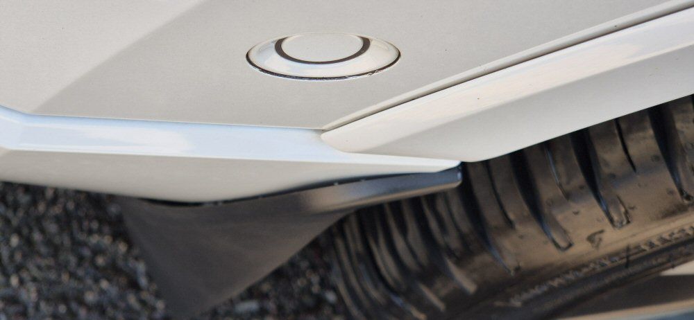

Yes, the genuine Seat FR rear mudflap ((575075101A) is a very close fit, you decide if its good enough from the pics below:

I looked at options for several months, imported rubbish items that allegedly fitted (mine was a 2023 vehicle), but didn't and then noted that a friend's FR Ateca's rear bumper looked tantalisingly similar, took the plunge and ordered a set. With time and patience they could have been made to fit better but I was awaiting a knee op at the time and couldn't spent lots of time kneeling on the garage floor making them fit perfectly. Your original post will attracted lots of views because the Cupra Ateca throws lots of road crud up onto the rear of the vehicle and as you have noted there is no official part for the job - the part number needed is in my post - not cheap though.

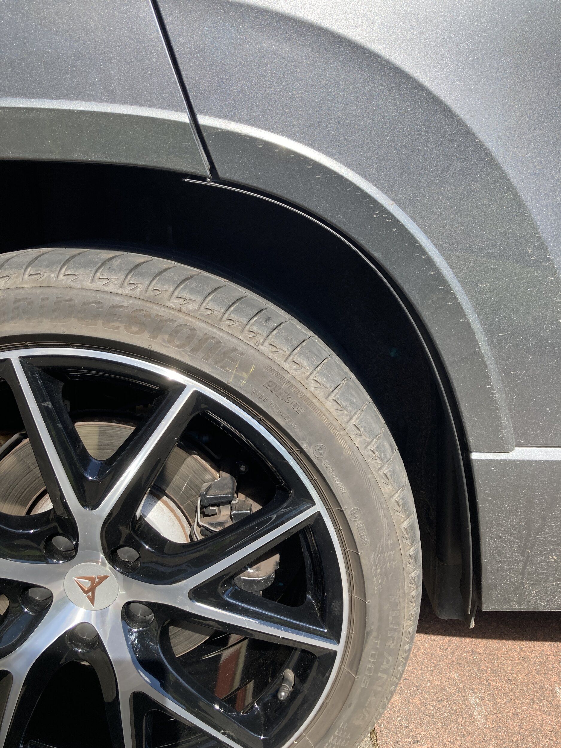

If you go down the mudflap road then the mud deflectors for the rear wheel arches that stop crud been thrown up onto the rear faces of back doors is another worthwhile (and inexpensive) mod:

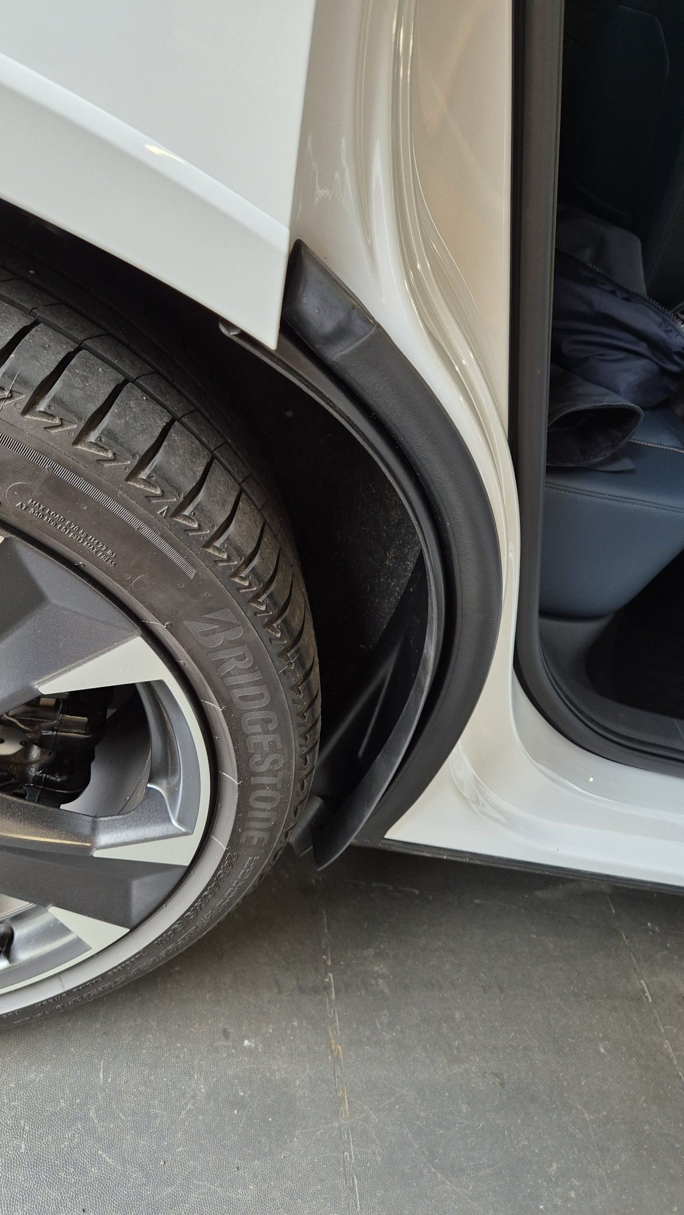

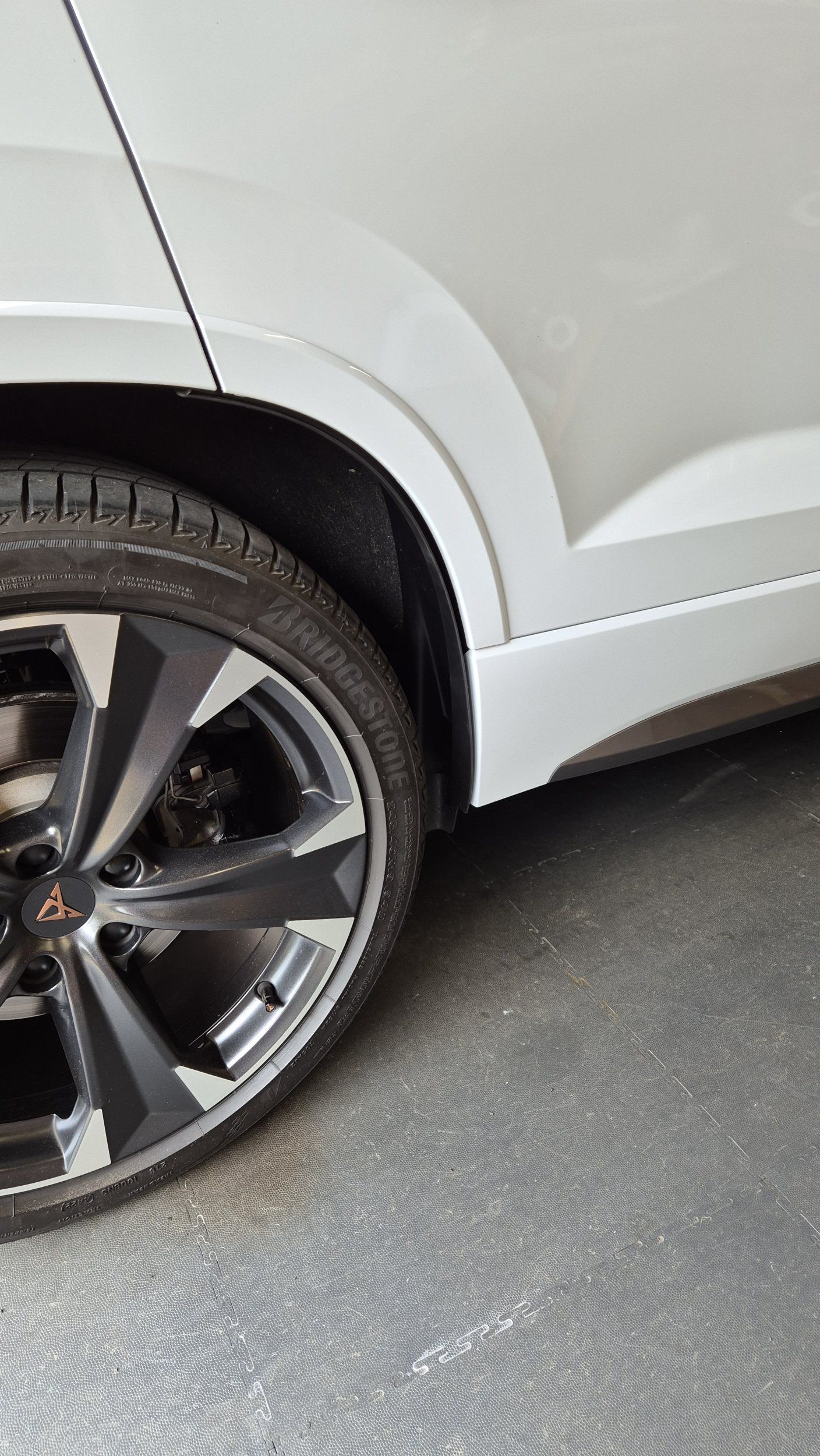

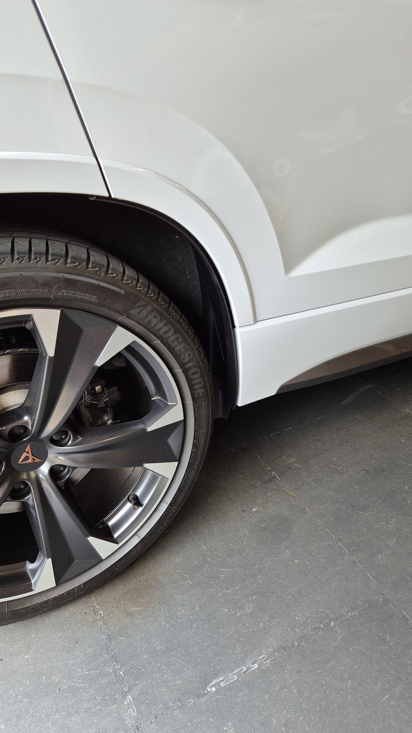

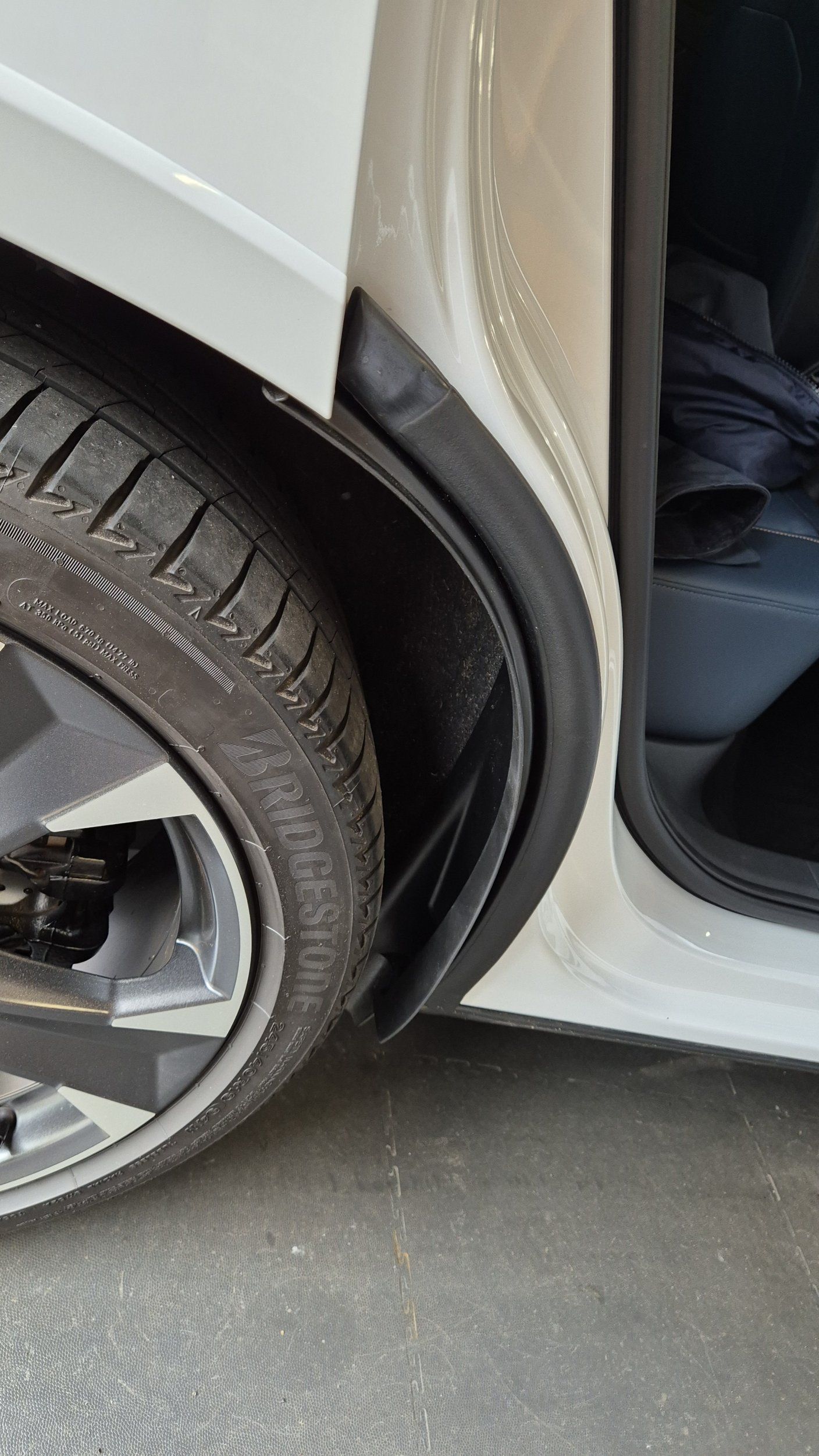

I ordered the wheel arch 'deflectors' again, this time from AliExpress. Given that 3 previous orders placed via Amazon all failed to arrive and were eventually refunded, I wasn't holding out much hope. But 3 weeks after placing the order, the Ali Express ones did arrive, apparently overland from China.
They align perfectly with the existing screws that hold the wheel arch liner in place, and take just 5 mins each side to fit, even with the wheel in place.
However, I don't know if the rubber door seal is now thicker on post-2020 Atecas, or maybe the arch liner now has a slightly different profile, but the deflectors seem to leave a much larger gap between them and the lower part of the door than in the photos posted previously by forum members.
They are much larger than I expected, probably worth the £20-ish that I paid, but not £48+ seen in some adverts.
I guess time will tell whether they work.
