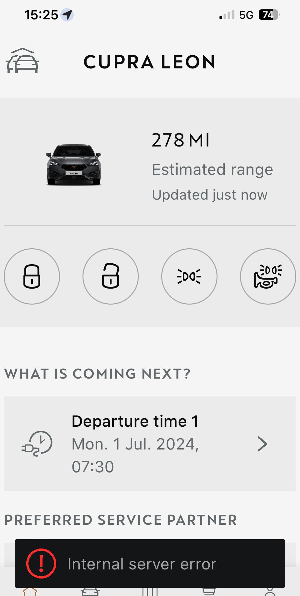

Hi, my Cupra Leon is 2 weeks old. The My Cupra app is connected to the car and the door locking/unlocking has been enabled by the dealer. All works fine until you really need it.
- Too many user requests or
- Internal server error
I am currently awaiting Cupra Technical to advise what is wrong but it seems like a common issue.
Did you get this resolved?
